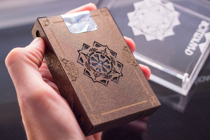

After many, many pieces of paper and laser time I have a near-final prototype of this box. Turned out pretty excellent, with great detail in the engraving and an absolutely perfect cut out.
The medallion in the middle was cut via the bitmap engrave method whereas the little side shapes and the outer cut line were done vector. I used some TransferRite medium tack tape for the masking of the center cuts. I’d classify it as low-tack, personally, but works great here because it comes right off the paper even in the tiny details.
This will be put into an engraved acrylic case and with just 50 made this should be a hit. Thanks Glowforge, finally after 2 years I can bring a vision to life.

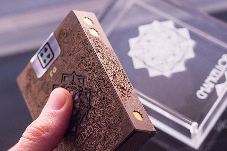

Back side view. Metallic paper is keen.

Thanks! For the papers I actually used two sheets, one is a black standard cardstock and the top layer is a normal weight paper. I got both of them at Hobby Lobby and I used a spray adhesive to laminate them together. They measure out at .017" thick.
I found that with this setup you can tune the engrave to get through the top layer of paper and into the black in darker areas. For lighter areas it will skim some of the metallic paper off and give you a nice shimmer in the details.

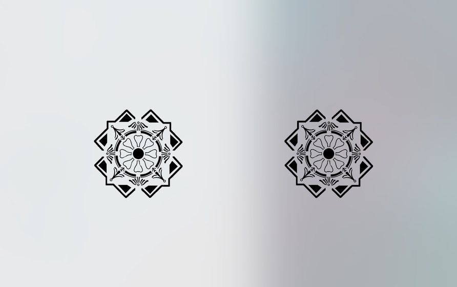

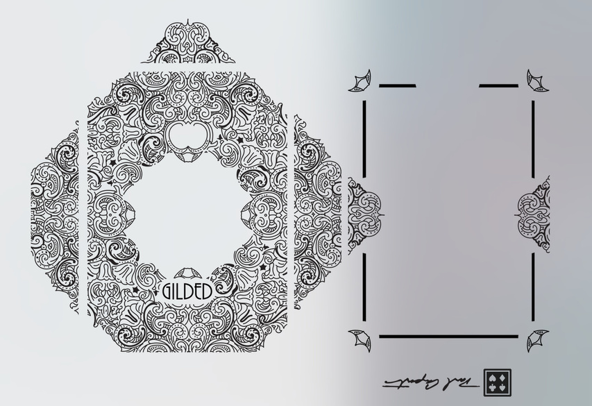

This project uses a combination of engrave and cuts, but for the super detailed parts the bitmap engrave works far better. I am using several steps here, both with a B&W bitmap PNG. I have the files laid out in Illustrator and there are actually 5 operations which I do in two main phases.
Step 1 is the engrave pass which lightly cuts in the fine details. For my particular papers and desired effect I ended up with 1000 speed, 25 power and 340lpi.
Step 2 is the “engrave cut” where I use a bitmap file but up the power to burn all the paper away. This works great and avoids the “hotspot” corners you can get with a vector cutout. This uses 500 speed, 60 power and 340lpi for two layers of paper and TransferRite masking tape. This has been able to get incredibly fine detail, some of my earlier tests had features less than 1mm wide that held up pretty well.

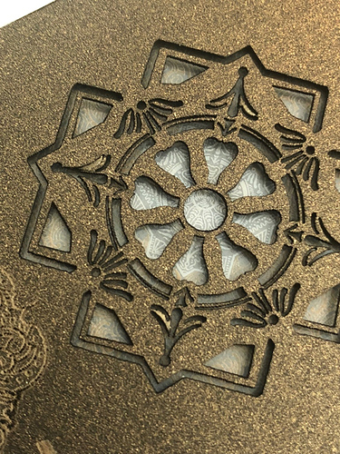

Since you’re cutting small/intricate details with a raster engrave, do you see any “stepping” of the rasterized image on the diagonal/curved sections, or does it look smooth? Your photos look great, so it gives me a lot of hope for this process, just curious if that’s something you worked through to end up at those final settings.
The engrave cut is visually very smooth. For reference, the main outline that runs around the outer edge in the design is 0.7mm wide and even massively zoomed in with the camera it is hard to note any unevenness. To the eye, it is almost perfectly smooth and straight.
