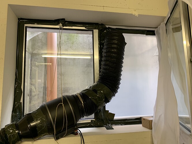

So we moved into a new apartment and we finally have a basement that has a window, so naturally it has become the Glowforge room. I went and printed a piece of perspex, put the pipe through it and thought that would be it… but no!

So I attached my AC sleeve that I used in my last apartment (which worked a charm - PM 2.5 was never above 6), but that did not work either.
I wet my finger and stuck it near the frame and it seems everywhere it could possibly leak it is leaking from. So I started duck taping the entire frame but even then, if there is a tiny hole the smell still comes in and PM jumps from 8 to 52. At the moment I seem to have it steady at 52 but have not cut a large amount of stuff.
First go
I then went into the small outside bit and ducktaped the entire window frame outside and then inside. I added that rubber window seal stuff to the frame and pushed the Perspex up against it. I then shoved some high density packing foam - the stuff you get with electronics to keep them safe in transit, in all the gaps wound the window to push the perspective against the seals. I then used ducktape on all that to.
Second go:

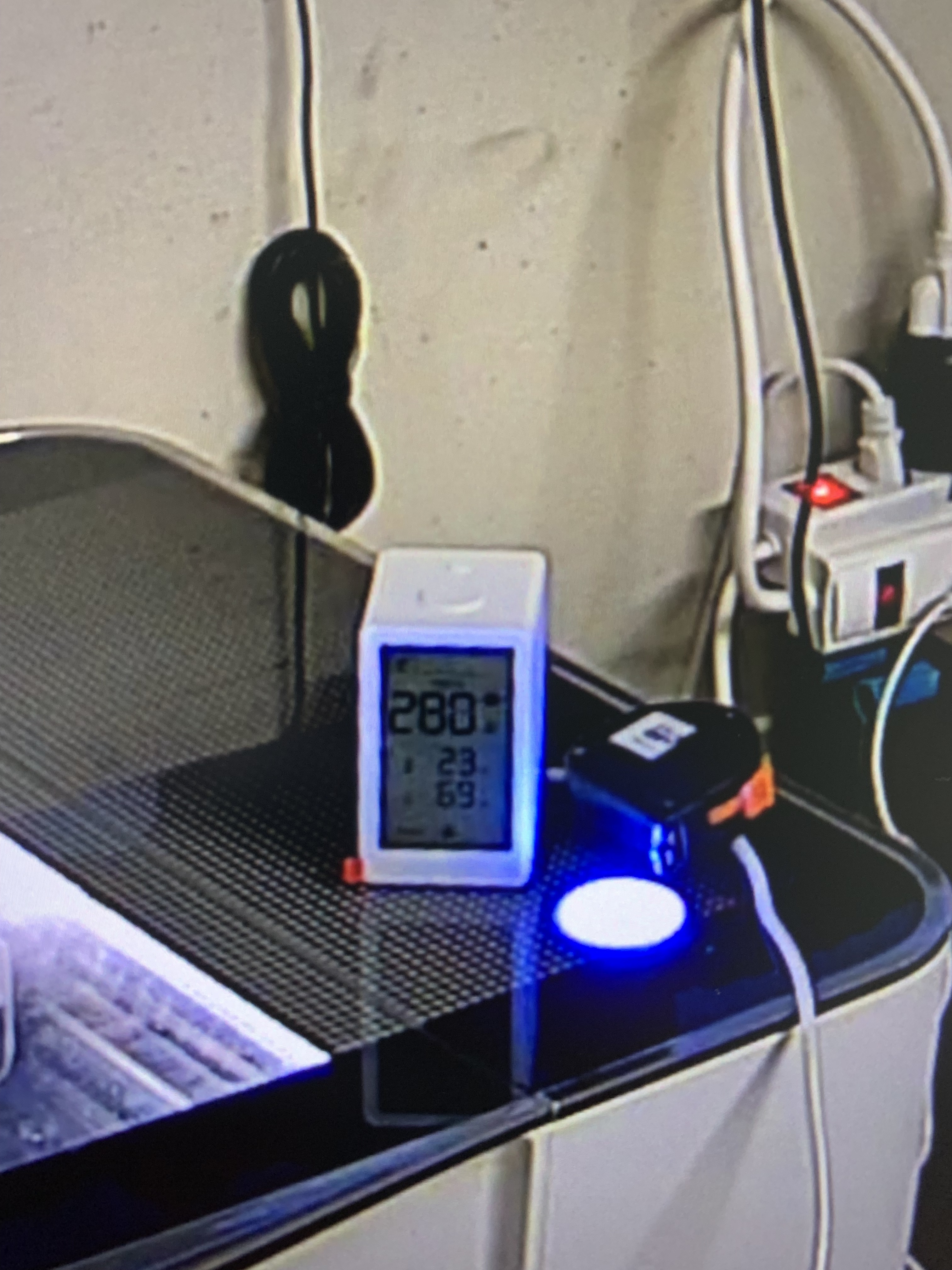

I ran the GF again, the room was at 8 for PM2.5. After cutting 20 circles out on a single piece of wood it was at 18 and then over the next hour engraving all of those we ended up at 310 for PM2.5. I left the room at about 90 and used the cameras to monitor.
It has now been an hour since the print finished and we are still at 270 for PM2.5.

Remember, you can only vent ‘out’ as much air as can be drawn in from somewhere else… So mabey leave a door or window cracked open at the other side of your unit.
Your set up looks like mine, and FWIW I’ve found the max setting on the Cloudline 6 can actually be too much. I don’t think it can pull enough air through the 4" on the GF, causing it to create turbulence inside the fan and reduce the output. I could be wrong, but it seems like I get the least smell at about 3/4 max on the fan. And I always run with a window in another room cracked open.

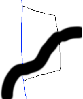

If you can close the open part of the window more, possibly getting some of the window sheeting that is used in winter to create an air pocket, and put that on the inside wall going over and around your hose would do the trick.
Like the blue line here:

if you can put a curtain up around the hose, it might help.
I have a patio door that I use to vent and I have done all kinds of things for my set up (a DIY window kit) but the curtains help more than I imagined they would. The combination all of the things I’ve done works pretty well.
