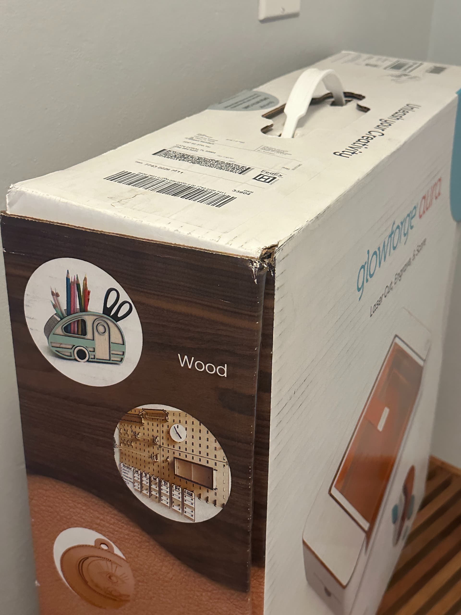

I got an Aura for Christmas and just purchased the filter. I set everything up today and can’t get it to read materials or cut anything. It says the lid is open. I’ve restarted, leveled, and checked the alignment of the lid with no success. As a new owner, this is hugely disappointing. I’m hoping its a simple solution… but nothing I’ve done has helped.
There was a small hole in the box and I see a scratch where indicated in the photo, but otherwise all looks good with the lid etc.

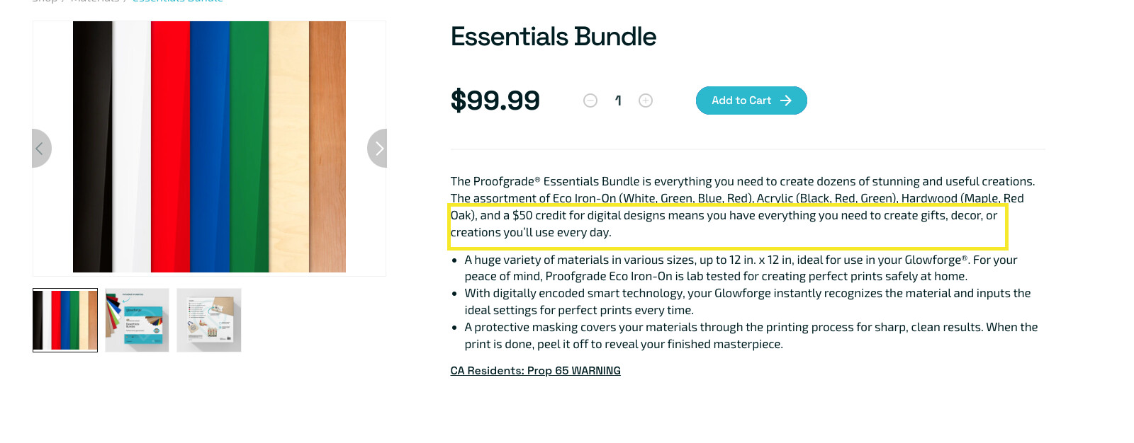

  • In the meantime, I thought I would get the essentials bundle for two reasons. (1) It comes with a variety of materials and (2) you get a $50 design credit.

Turns out the $50.00 credit will not work for this design only for stuff at this link (guess I should have read the fine print prior to getting the essentials pack)

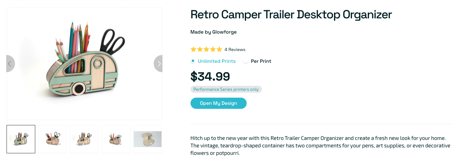

One thing I just noticed though. It says this retro camper is for Performance Series Printers only…but
This design is literally on the side of my Aura box. Has anyone had success printing it with the Aura?
I see no reason that should be Performance only, except that it’s laid out for a 12x20 piece of material rather than 12x12. They’re markings in the catalog are really doing terrible service both for them, and their designers! I’m going to send a note off to see if someone there will take a look at that particular marking (Performance Series printers only).
That design’s recommended material “medium maple plywood” has an MDF core, which can gunk up the Aura’s print head fan to the point that they recommend not cutting it in an Aura at all. The “light maple plywood” should be a workable substitute, but anything that connects via slots and tabs might be a bit loose and require some glue, since the light plywood is a fraction of an inch thinner than the medium plywood. Other than that, you’d just have to split the design across two 12x12" pieces instead of one 12x20" piece.
