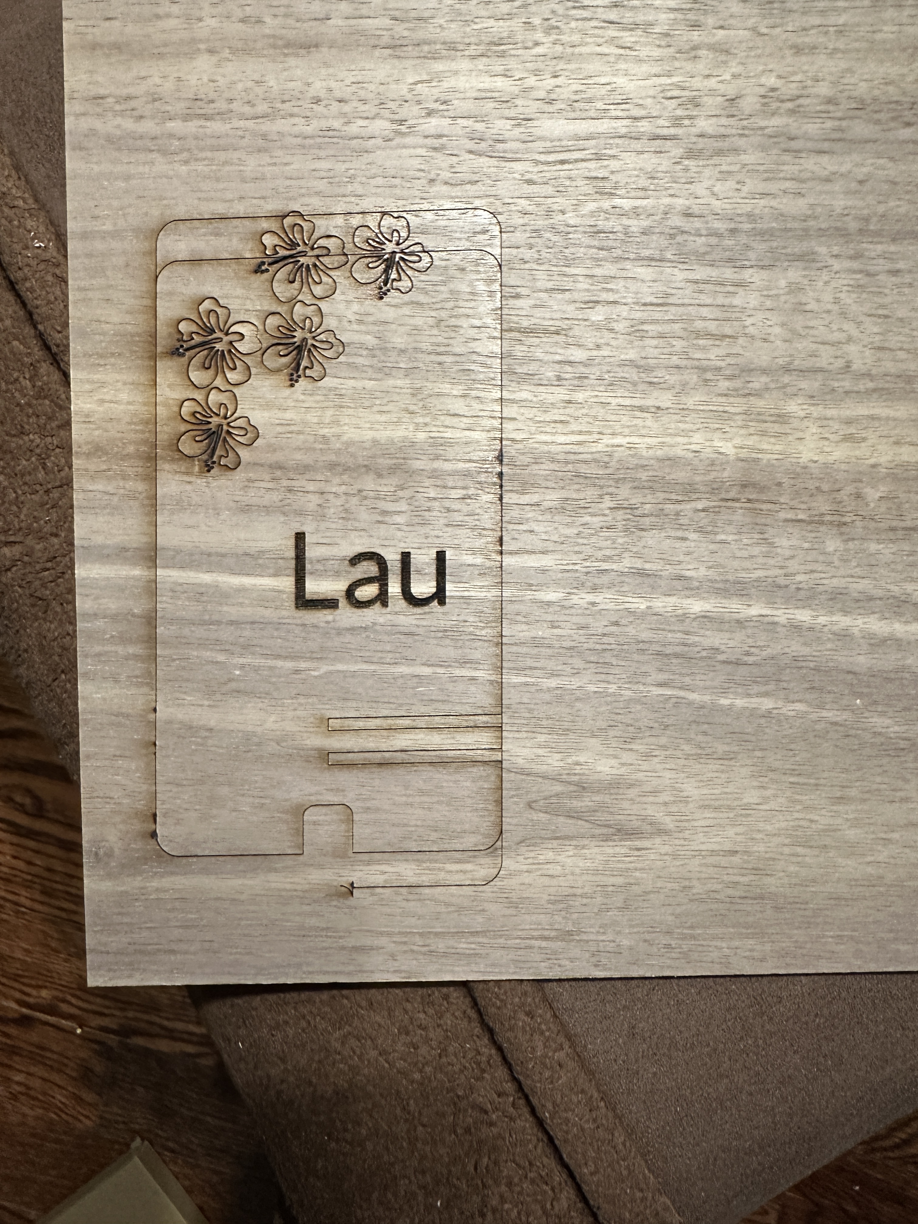

Hi, new Aura user, never used a laser before. I did several samples with paper with no problems but anything I try on wood runs into problems on the second and third cuts. They do not align with the first cuts. I’ve wasted two sheets of wood and am beyond discouraged. Thank you!

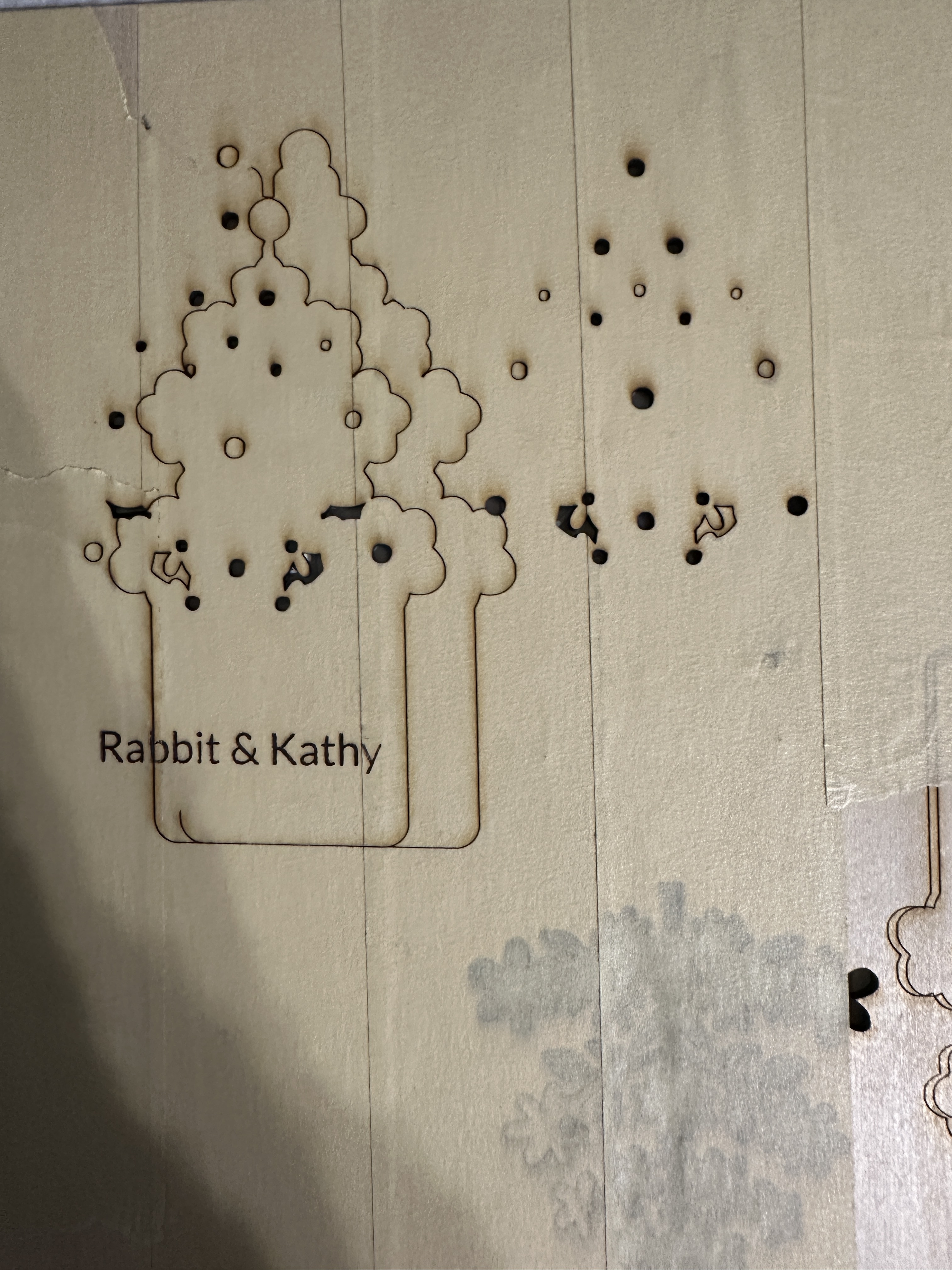

This is first run. Second run I tried masking tape but that didn’t help:
This is what the back looked like

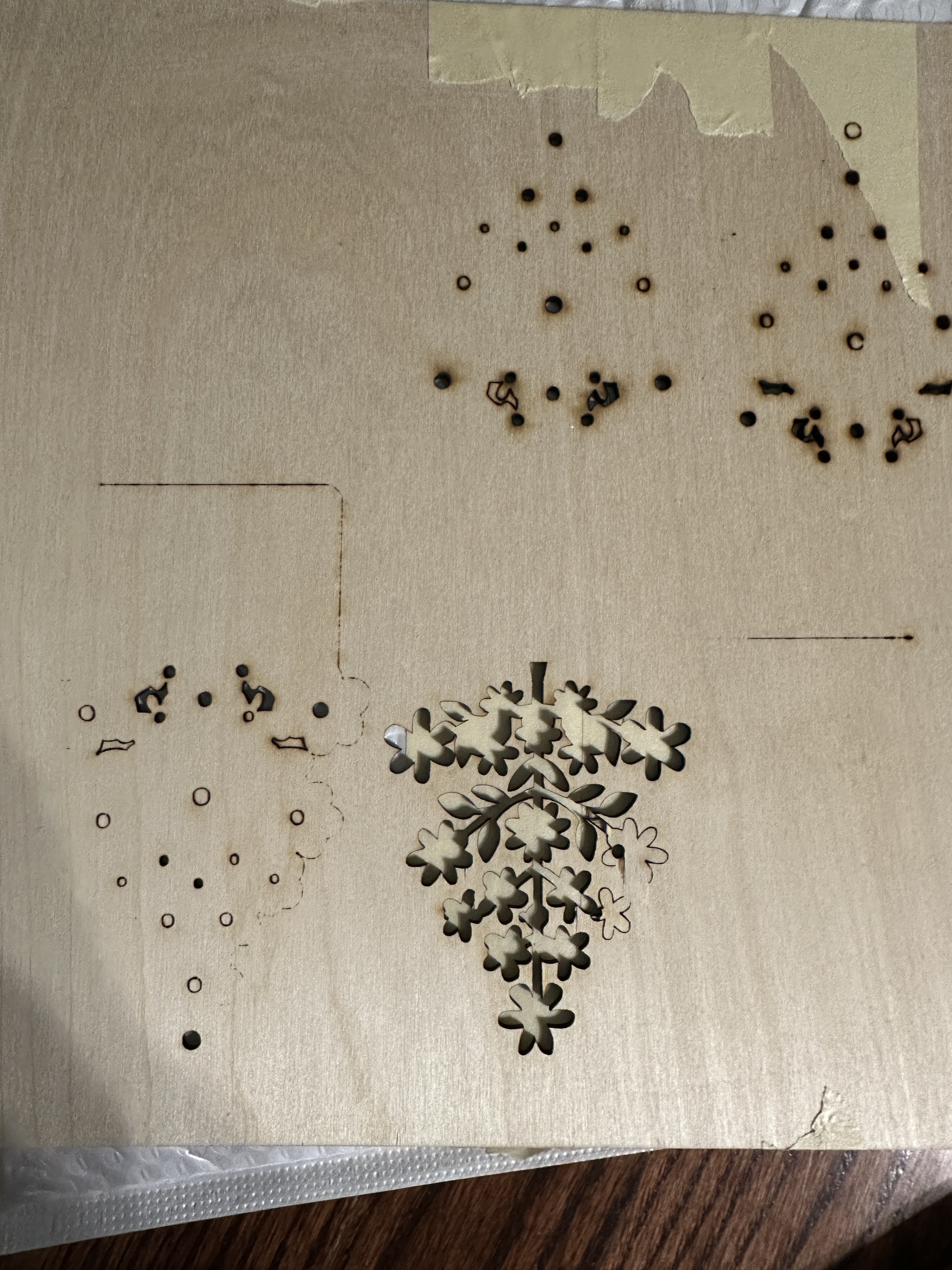

For my third try I used a different wood and a different pattern (both patterns were in the app and recommended for Aura). This one I stopped printing when I saw it was happening again so I didn’t waste another sheet of wood.
You can see that the second run began significantly lower in the one on walnut plywood.

When cutting wood, the laser setting for medium wood has the machine cut the pattern shape 3 times in order to get through the wood. But every time I try this, the second and third cuts do not line up with the first cut (see above photos). I don’t open the lid or adjust anything during the process. I’ve only had the machine a few days.
Are you using Proofgrade material? (not a requirement by any means). Are you using the proofgrade setting for medium wood or putting your own settings in? If you’re not moving the material OR your image in the UI, it should automatically cut every time in the exact same place. You may need to contact support…+1-855-338-2122.

Hi. Just giving an update. I contacted customer support. Since many different problems can cause this issue, they had me email photos. They were quick to respond with a diagnosis (in my case, the laser arms were at a slight angle) and a relatively easy fix. A few tests later, and the alignment is no longer a problem. I highly recommend contacted support, they were responsive, helpful, and I was so relieved to be able to fix this myself without having to send in the machine for repairs. Thank you to all who responded to my question. ![]()
