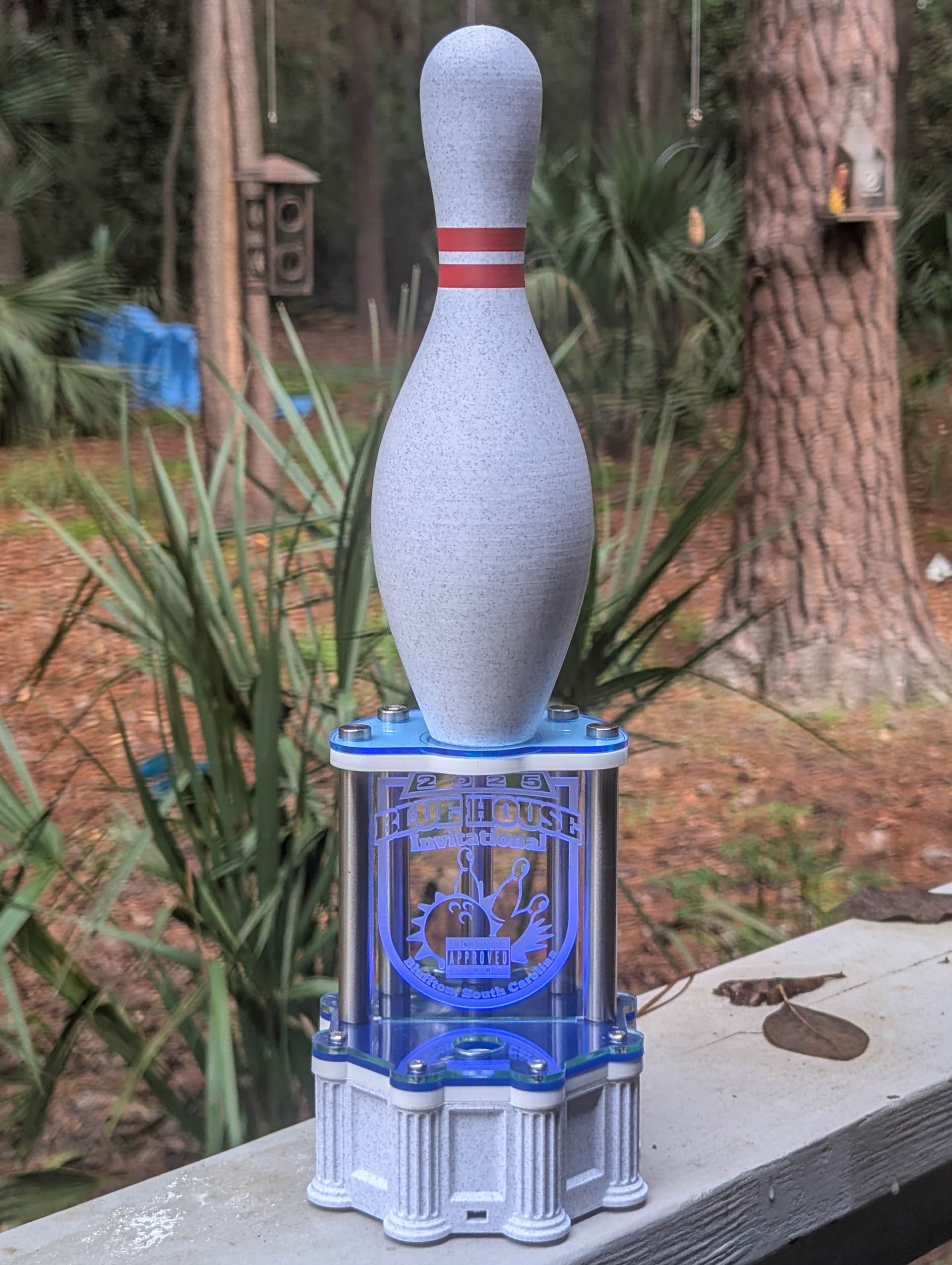

New & Improved Bowling Trophy

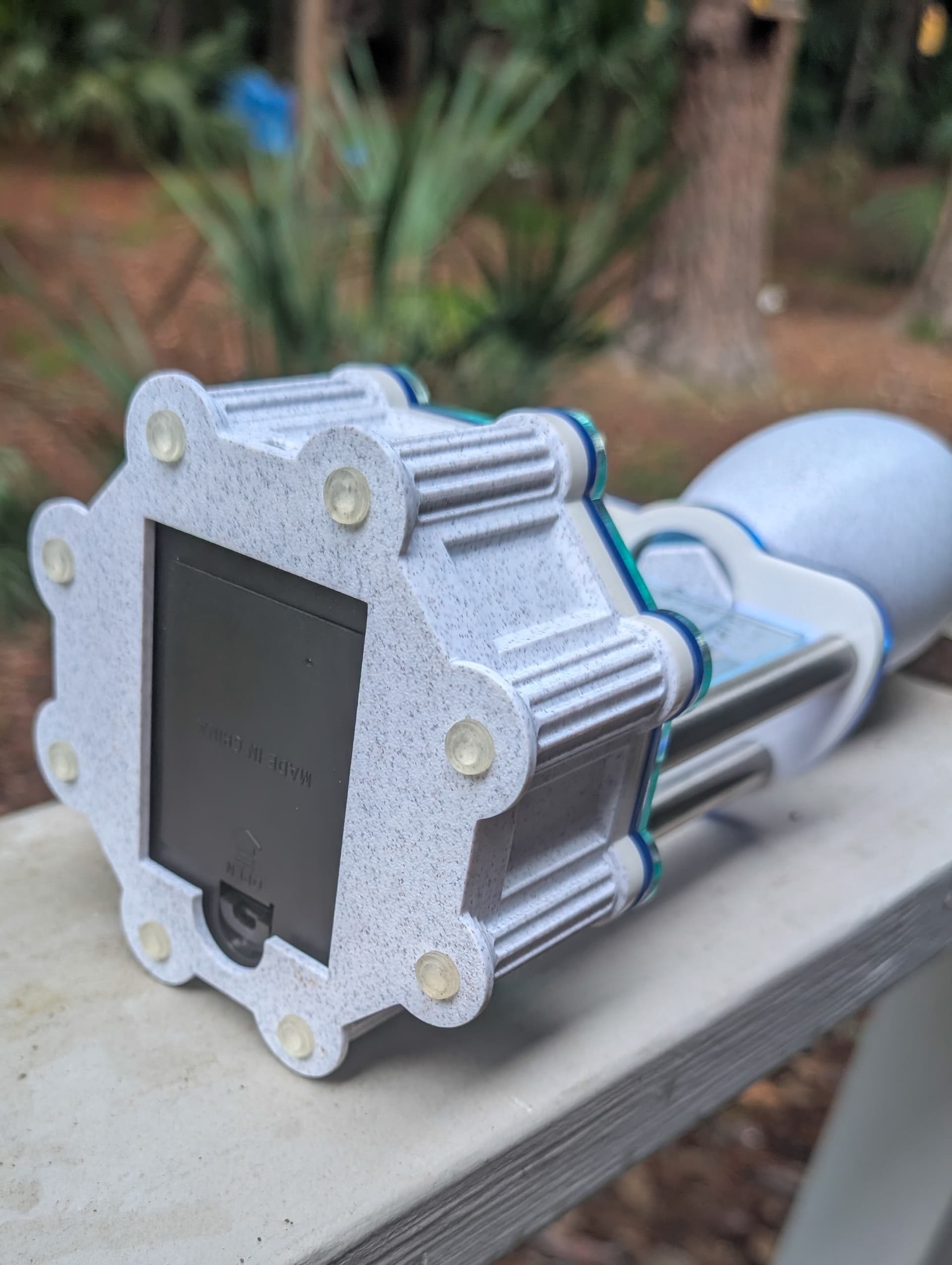

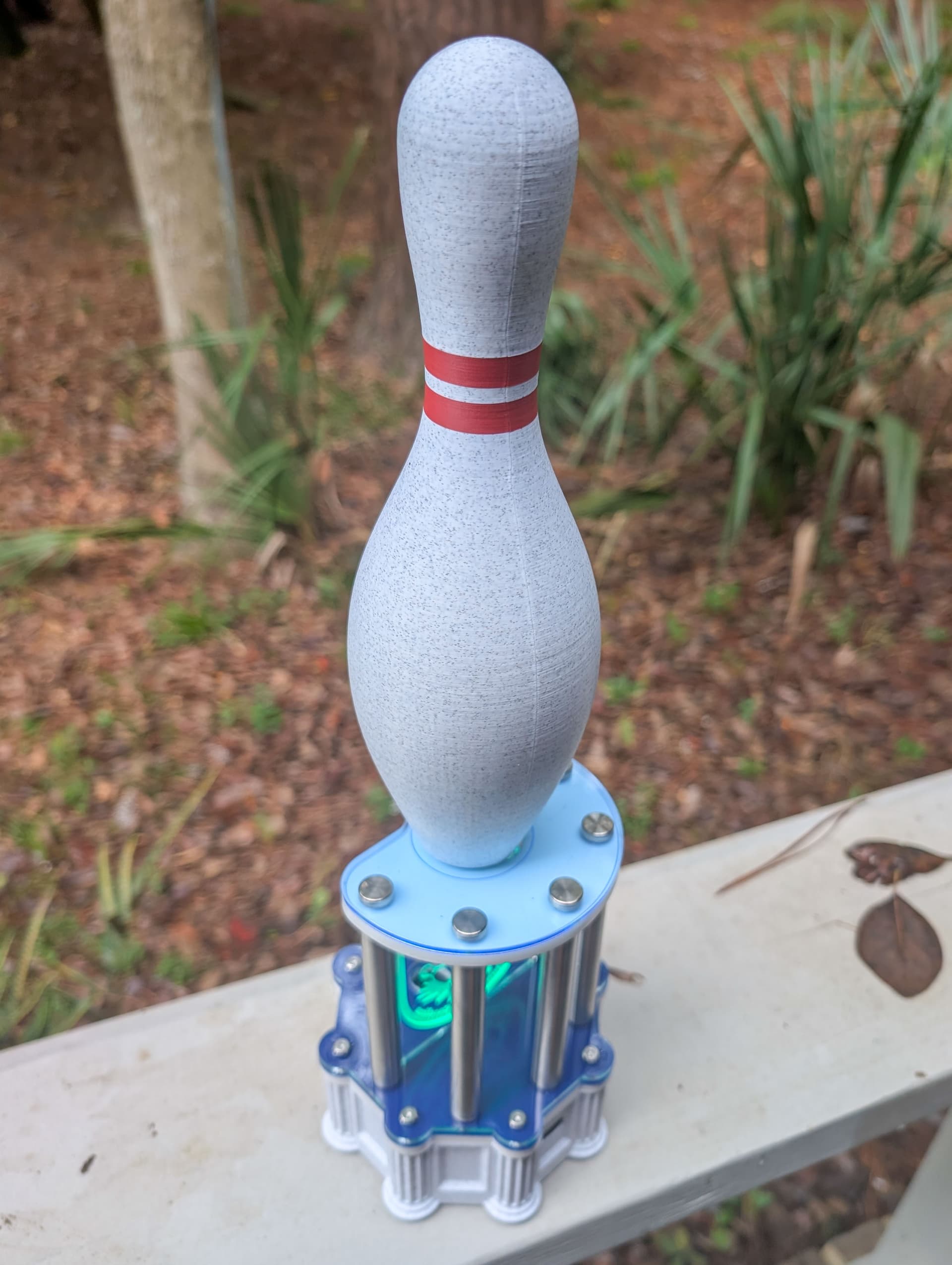

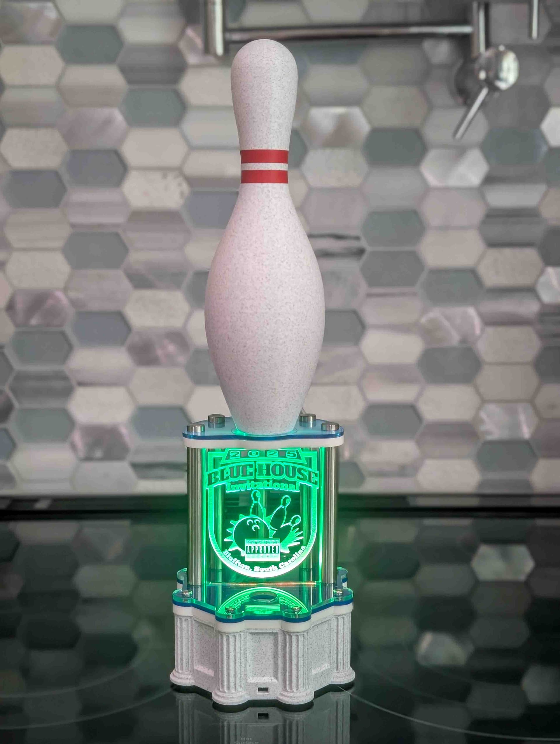

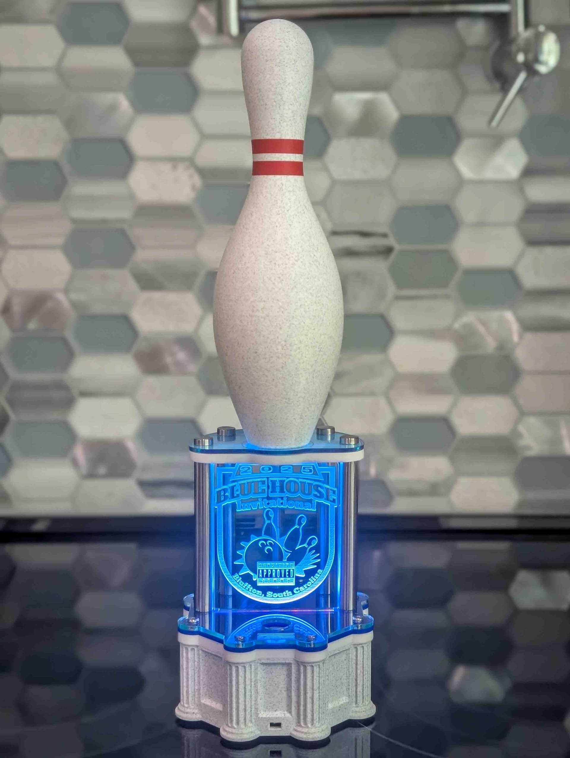

A couple of years ago, I made a bowling trophy for a fake bowling tournament when some friends came to visit me in South Carolina. Beers consumed, memories revisited, fun all around. We’re doing it again this fall, so I made yet another trophy. But this time I integrated an LED lamp into the design. 3D printed base and bowling pin with marble PLA, with laser cut and engraved acrylic. I added 100mm standoffs to give it a professional look and voila! It lights up and stuff…

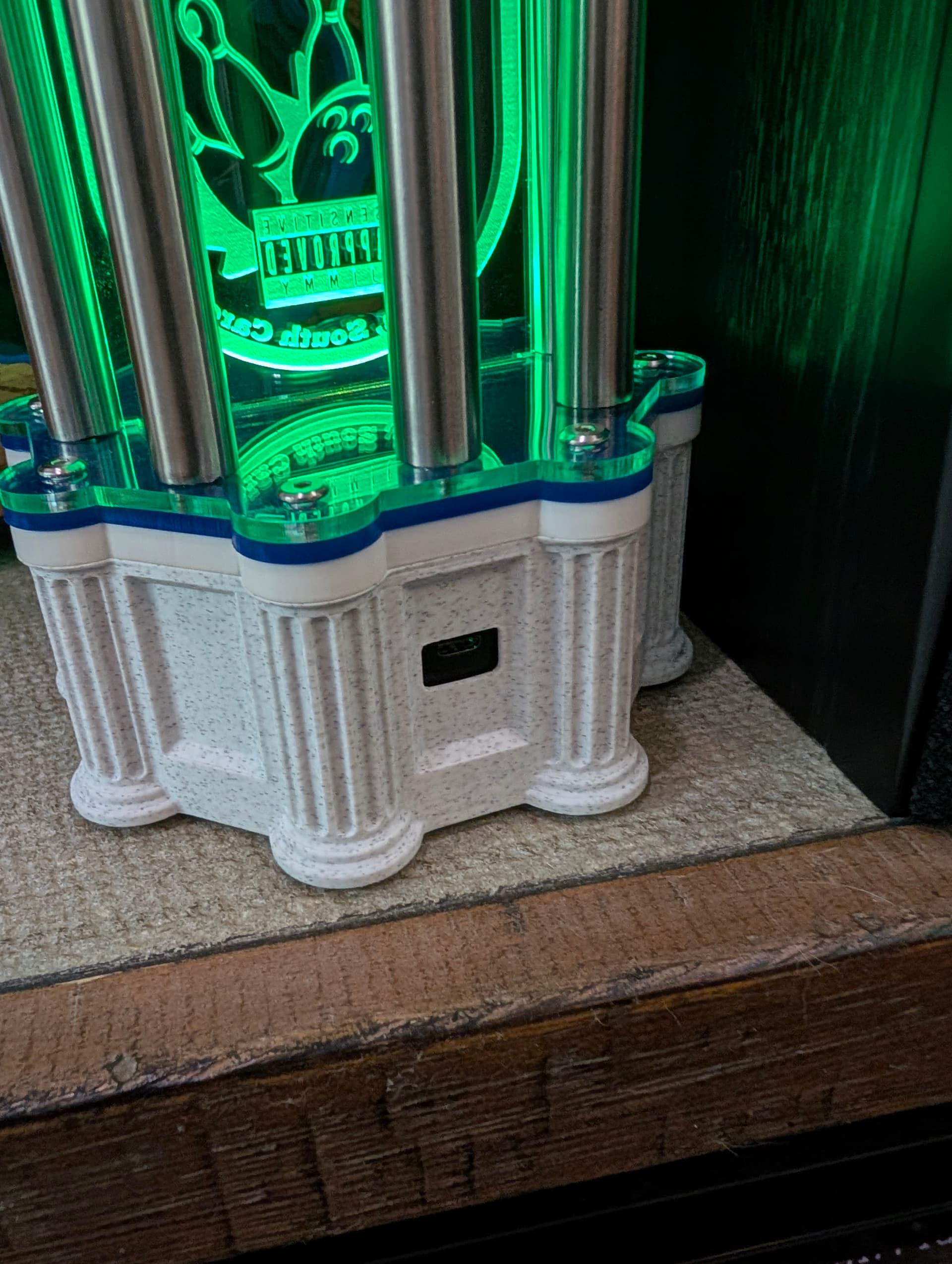

I’ve learned one thing you might consider - I’ll never make something with the LED base unless it’s wired to use a USB charger. We’ve all got plenty of those knocking around (or you can get them at the dollar store) and it’s not so much the expense, but the hassle of changing batteries. When I made a lantern for my daughter’s BCT (“Lantern of love”), I hacked the LED module to support direct wire..

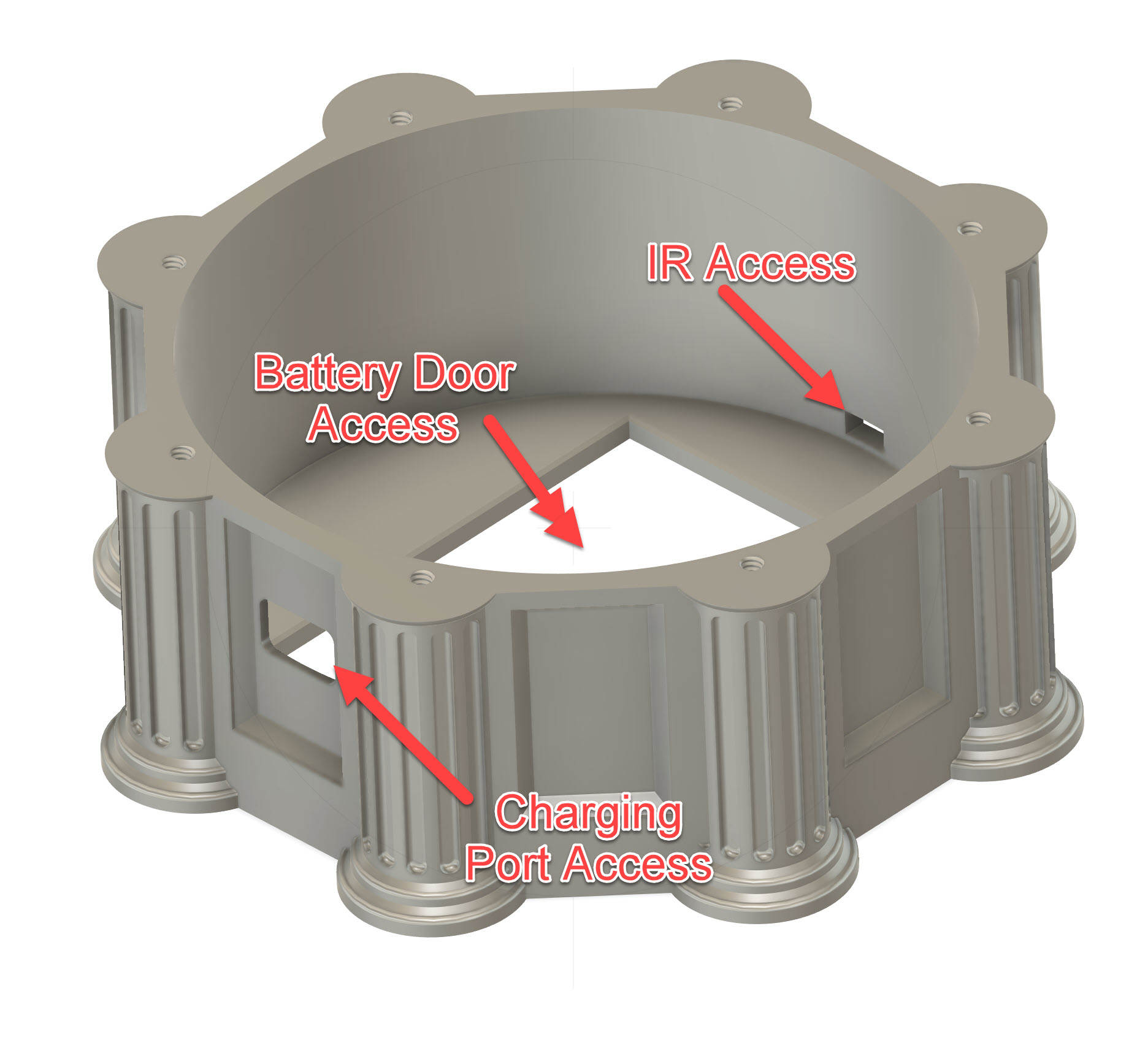

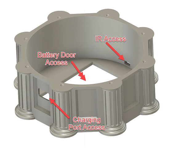

One step ahead of you. When designing the base enclosure in fusion 360, I made sure to include an opening for the USB micro cable in case they wanted to plug it in to the lamp base directly.

Trophy like that pretty soon your fake bowling tournament is going to turn into a real bowling tournament!
Beautiful job :bowling:
It looks amazing! I haven’t made an LED base in quite a while, but I like the ability to plug in also. Well done!
Of course you were! :man_facepalming:
For a fake trophy, it looks better than a real one. Beautiful work.
Nice!
Great job! It’s projects like this that make me think I should buy a 3D printer. And have more parties that involve a trophy.
Gorgeous! The winner of that trophy is really, really going to be happy to take that home! I’m sure it’ll be a hard-fought battle to win it!

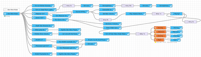

Or… use node red automations in Home Assistant to create tons of super needlessly complex automations because, well, because you can. I call this one Star Wars Mode. I just have to say “May the force be with you” to Alexa. I’ll go back to hiding in my hole now.
