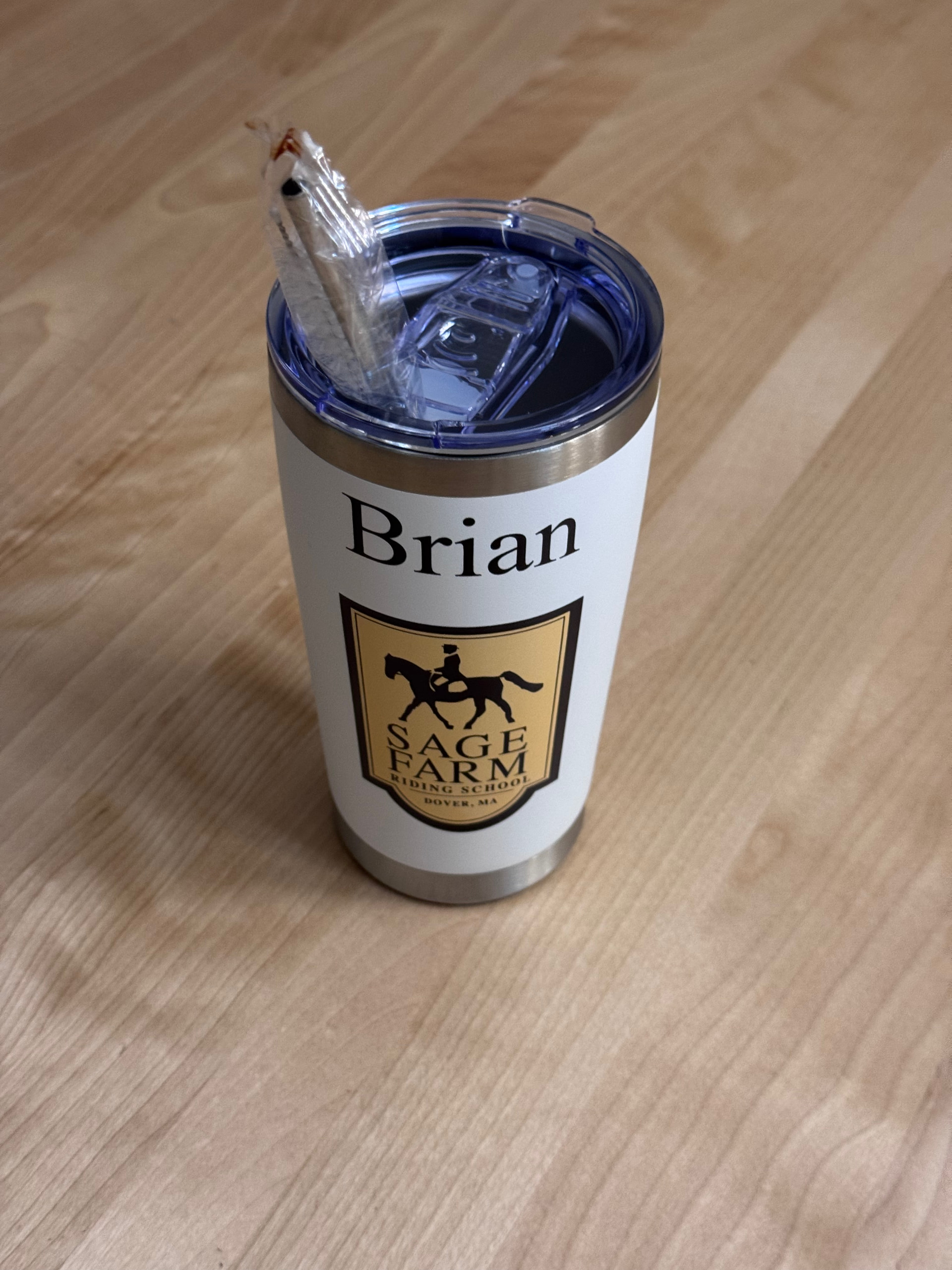

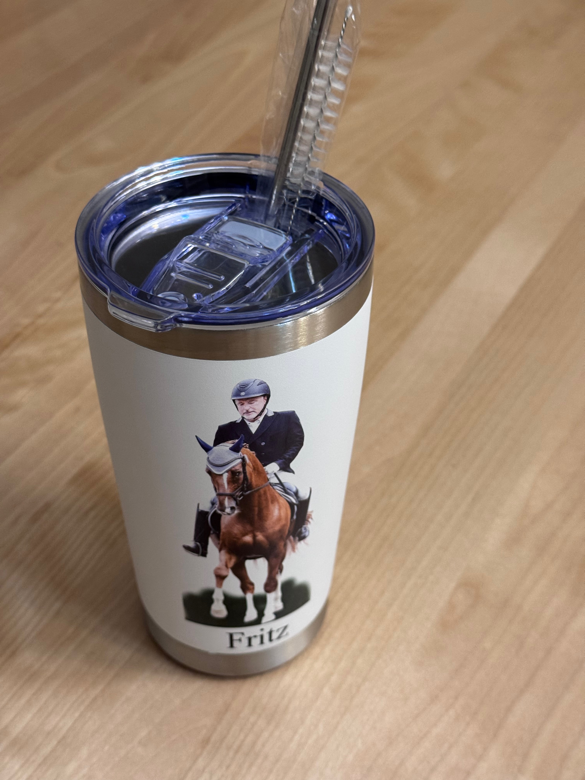

Now that I have ink inbound I did a first try at a rotary attachment project: I wasted 2 cups before realizing that even though it is a simple shaped cup the inner rotary wheel (the one that clamps on) was sitting on an internal ridge and that made it slip. So after putting the extra width wheels on (very clever, they click on with magnets) the project came out perfect, each year at the barn we do something for all the owners that stable the horses there so did the sweat scrapers a few years ago on the GF. I had watched a tutorial on YouTube here before doing the project. The feature I wished it did was the ability to split the project across the two sides. But I realized since it is a featureless cylinder I could use the midlines on each side as the centers on opposite sides. The logo is a SVG while the horse is a PNG. I did not use a white layer since the cup is pure white (OK colorspace snobs simmer down over there).

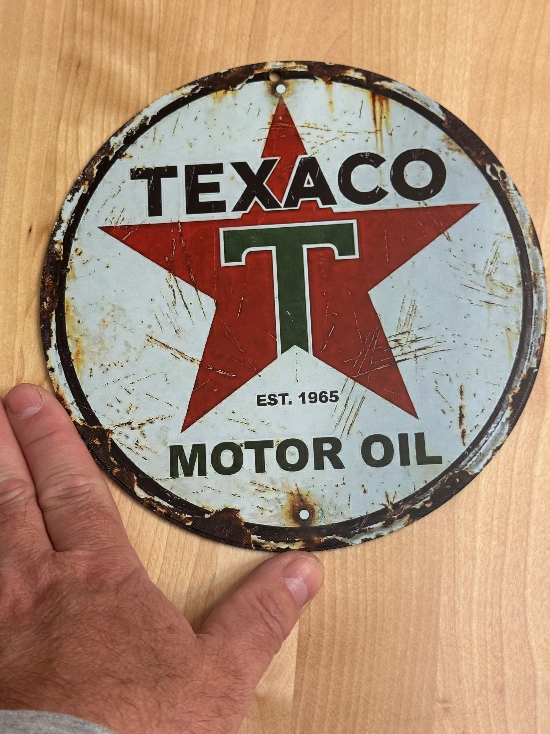

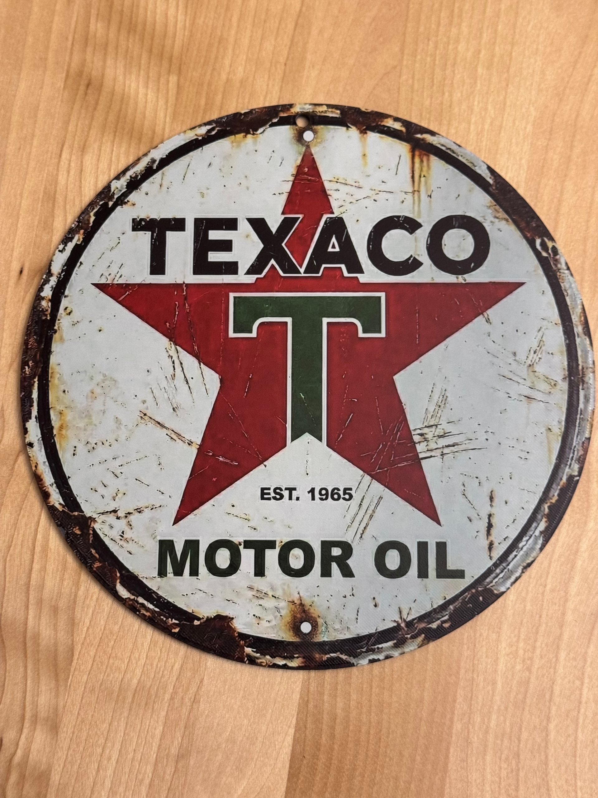

Today I tried an experiment for a friend who asked how well it can recreate a vintage gas sign (he’s a gearhead so has a fancy home shop). So quickly google searched a vintage texaco sign cut it out with photoshop it was all rusty and scraped up. I was lazy so didn’t glowforge the base but instead just created a 2.5mm thick 200mm diameter cylinder in PrusaSlicer and sent that to the printer, then threw the disk into the eufymake and dropped the image onto it. This is printed in White-CMYK flat, looks absolutely convincing (if I did texture print the rust would likely be “rustier” but overall looks amazing. The printer could have printed larger but that left the art at 300dpi.
Hand for scale (no my hands are not weirdly sized)

Wow! Very authentic looking. I think your friend may be requesting more signage for his fancy home shop.
Amazing! I have eufy envy. :smiley:
Great job! Very hard to tell it isn’t metal looking at it. I’m sure your friend will be super excited about it!

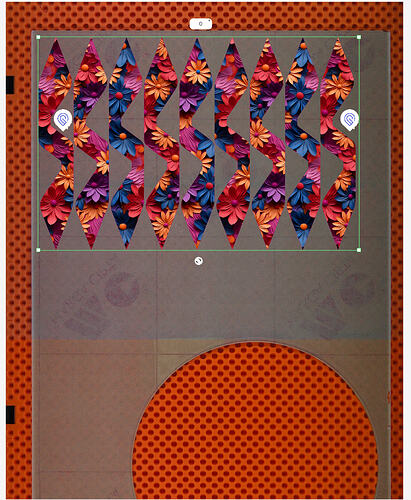

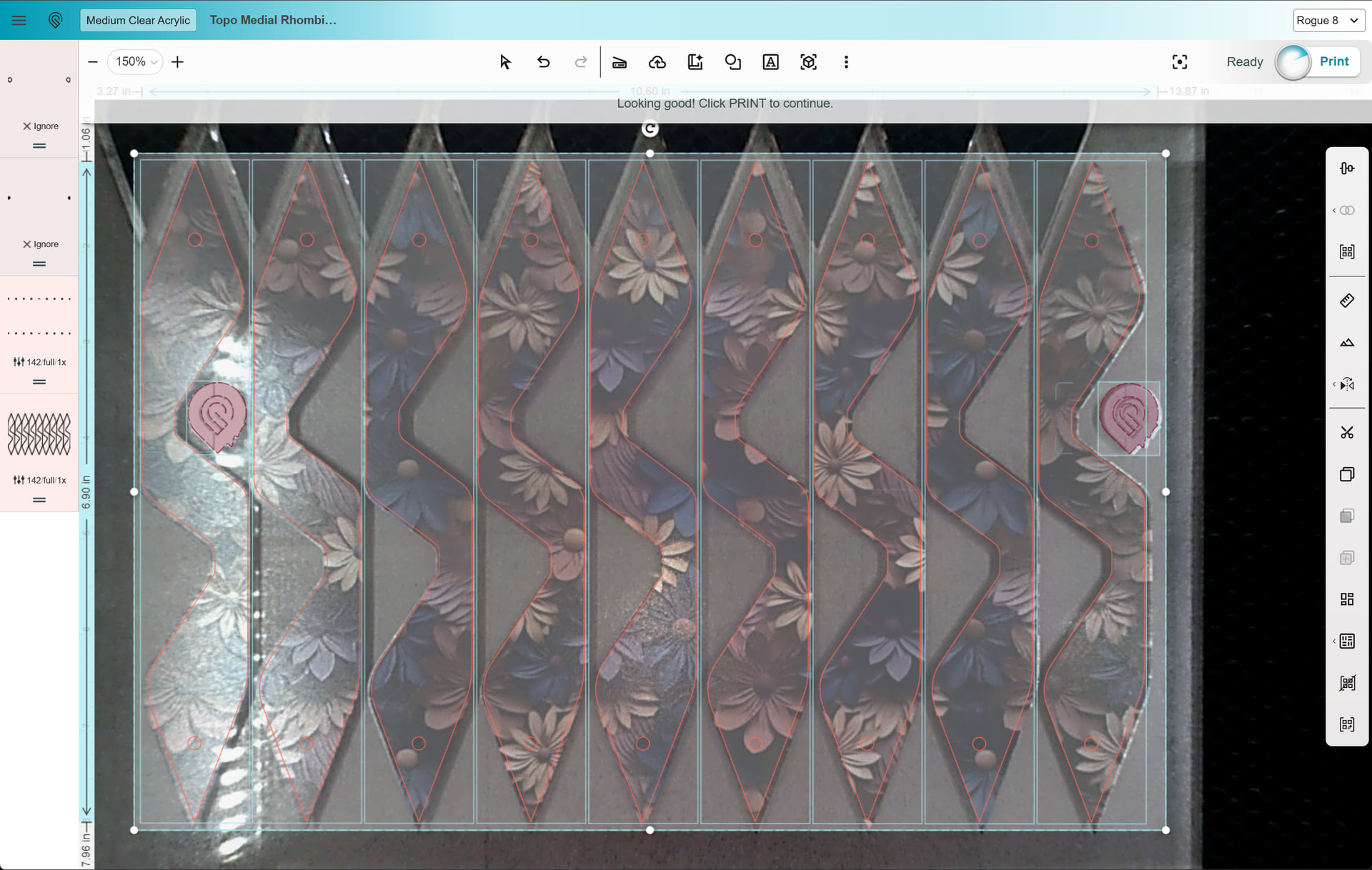

Quick snapmarks tip: Add a white background around the :glowforge: bug when printing on the Eufy, as the snapmarks tool picks it up better, especially on clear acrylic.

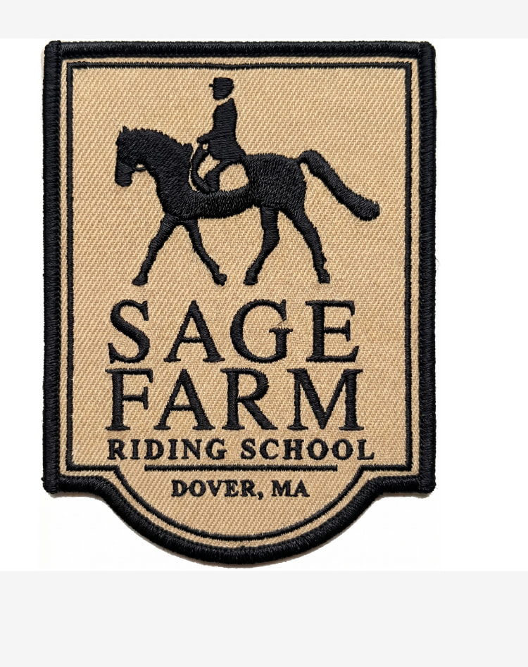

This is going to be the first patch, this is the SVG of the farm’s logo and used the AI editor in the studio to make it into an embroidered patch, which looks pretty cool actually. I love that it leaves the occasional tail of thread to not be too-perfect. I went with the Lone star adhesives Heritage leatherette which is laser safe and heat activated adhesive. Supposedly doesn’t smell as bad as real leather. Also going to try some hot-foiling on leather for bookmarks, which Ashlee Falco shows on her hot foiling tutorial.
