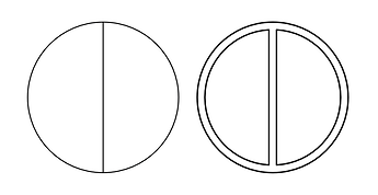

The key thing to remember when making art for the Glowforge is that filled shapes are engraved, and lines are drawn as lines. If a line cuts through it is called a “cut” and if it just makes a mark, it is called a “score.”
This bitmap image, if fed to the laser directly, would just engrave all of the black.
It sounds like you want just the outlines engraved?
look at this shape…
What do you want the final product to be? Even if we consider just the outlines there is more than one want to render it.

The pics I posted were a couple of ways to interpret “only the lines.”
What you want to do is surely possible but I, at least, don’t yet understand what you are looking for. Maybe you can draw what you want the engraved output to be?
