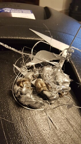

I’ve really enjoyed having my Prusa. That being said, it has been a source of some frustration, starting with this:
A keen observer may notice that this is not a dust boot for a Shapeoko3. I started the print, got the first layer down, then went away for a few hours to go to the gym. I came back to find that the first layer had lifted, gotten caught by the extruder, and generally kept the melted plastic from going anywhere but up and around the extruder, fusing itself to the extruder’s plastic components. In my attempts to separate the two, I broke several pieces from the extruder. I also managed to destroy the extruder thermistor.
Two weeks later I have the replacement parts from eBay ($20) and I cobble the thing back together to print. Everything is going great until I try to feed filament into the machine, and the stepper doesn’t move. Trace the problem to the stepper itself, which has come apart because I apparently skipped a step during assembly. The back pressure on the extruder pushed the stepper apart, shorting the RAMBo. $80, 45 days and some cussing later, the Prusa is back together and I’m just about ready to print.
Just as soon as I find the source of the new “Bed Thermal Runaway” error.

I was probably overdue for giving the bed a rubdown with acetone. I don’t blame anyone but myself, but it’s been a real learning process.

I too have a PRUSA. I have had great success with getting things to stick with using the ‘rough’ side of a dish sponge, with a bit of alcohol to wipe away any oils. If that doesn’t work you can ‘draw’ a copper wire brush across the surface which puts micro-scratches and makes for a great stick…try the sponge first.
I have had two PINDA probes and both of them are effected by heat. If you calibrate your unit when its cold (because you have to) then the probe will read higher than when its hot. Put another way, if you leave the probe over the print surface, and you pre-heat for ABS there is a good chance the nozzle with drag against your printing surface, causing damage.
To fix this I move the print table to the rear and the print head all the way to the right. the PINDA does not hang over the heating area.
BTW, you can also stop the printer by hitting the X button under the control dial. This is handy if you fear your probe is about to dig a hole through your print surface. Typically I move the paper back and forth and will kill the Z calibration if it begins to catch-drag on the paper. Its really a feeler gauge/protection against the wrong height.

Thanks for the advice. I roughed up the surface a little bit and have been keeping it clean between prints. I also seem to have success by doing the first layer of a small print and get everything up to consistent temp and there is less likely hood of warp caused pull away. Waking up and running downstairs to look at the dragon was like Christmas morning. I was just flabergasted by it.
