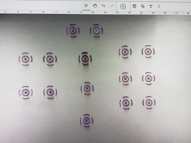

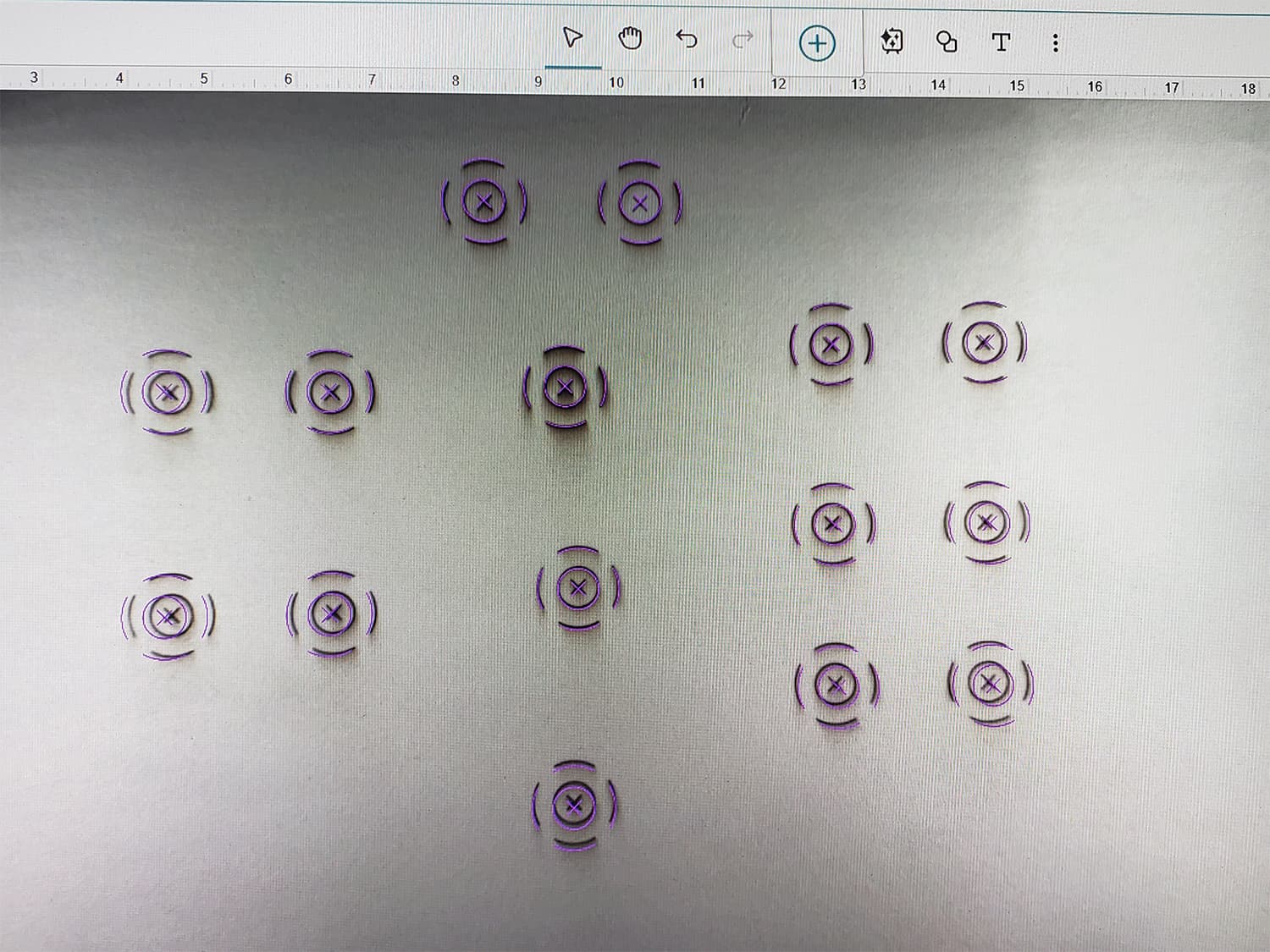

Output is off by increments the further from the center it goes
I have a pro and this week it has started to not recognize the placement of my files. The only place that is correct is dead center. The further from the center the file goes, the worse the distortion like it’s growing slightly.
I’ve tried various file formats, and as individual elements as well as grouped to see if the grouping would hold the size, it does not.
I’ve realigned the camera, the machine is clean and it happens on all substrates.
I took a picture of the bed with the files after the engrave so you can see the distortion and where it starts happening.
I’ve followed the instructions on focus, placing the substrate before importing any art, nothing seems to work.
If anyone has any ideas or suggestions, I’d appreciate them.

The Glowforge cameras are fisheyes. You can use Set Focus to adjust the math if you want a different part of the bed to be the focal point.
If I’m placing a bunch of items I’ll use set focus, place 1 item, then do set focus on the 2nd spot and place the 2nd item, etc.
It’s never been able to do a perfect alignment on the whole bed - though it’s significantly better now than it was a couple years ago.
Now, if you mean that your art is being printed with a skew that’s a very different issue. If that’s what’s happening can you post images to show what it looks like?
aaaahhh ok - that’s really helpful - no, not askew, just progressively out and away expanding

Your alignment looks normal.
