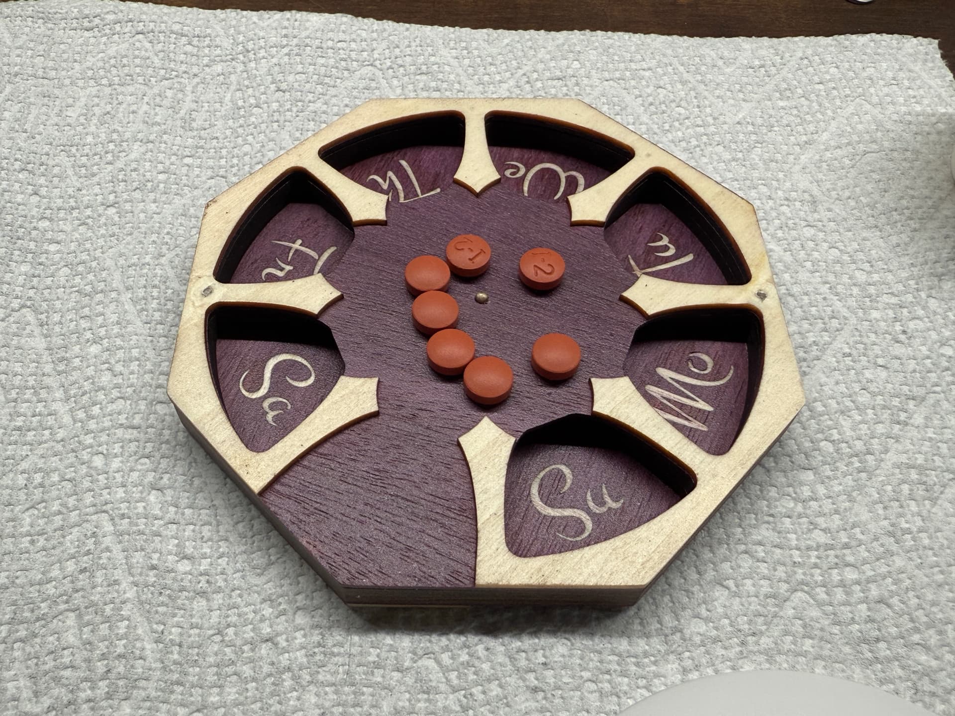

I couldn’t stop myself from coming up with “improvements” to @csembroski’s elegantly simple pillbox design.
For your amusement, here it is, though I’m going back to a simpler design in the future.
The top has acrylic windows so I can see if I missed a day. Unfortunately, they get dirty too easily, and I somehow managed to crack the acrylic. They also make the top thicker.
I changed the shape from circular to octagonal, which was genuinely an improvement as it’s easier to turn. The days of the week are inlayed rather than engraved, which is also a nice touch.
I added a third layer at the bottom which comes off. When it’s time to refill the pillbox, you put it on top, and pour out a few pills in the middle, then push them into the compartments. Despite my bad hand, I didn’t actually find this to be easier, but some people might find it helpful. Anyway, I won’t include this next time. It adds more complexity and thickness.

I don’t see a lot of fail here. Cool box. Veneer inlay with foil tape, or ?

I did try the foil trick once and it’s pretty amazing. But this was just cutting out the shapes and inserting them.

I don’t either - it all sounds reasonable and good on paper. But the end result, once you have in your hands, seems clunky (so many layers) and unattractive (smudged acrylic). I’m going to make myself another one without the “improvements“ (But keeping the octagonal shape.)

Nice but what about morning and evening?
yeah. I’ll need two or three. And a little stand to hold them.
I stack mine, taking off the bottom take the pills and put on top. That way I can see from across the room if the latest was taken. That way the pills get taen even if late. I have been working on how to do that with a box I made.

The woods were purpleheart, walnut, and aspen. It’s a great combination, but another design problem. The edges (not pictured) show a discordant layering, including the acrylic layer, and had to be painted.
The color shows another mistake too. The Miniwax Polycrylic finish turned the purpleheart somewhat brownish, really dulling its vibrancy. I had better luck with blonde shellac.
