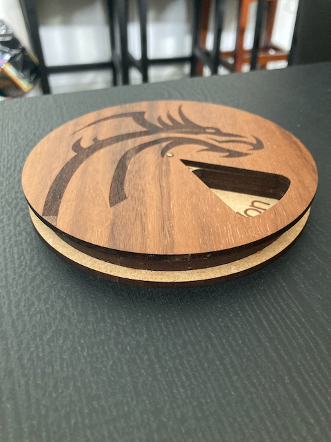

Hi Y’all,
I designed this pillbox for one of my friends. It rotates about a brass nail, and uses small, 2mm magnets to snap into rotational position for the seven days of the week. The lid comes off for easy filling. Also, you can add as many layers as you want to make the box taller or shorter.
First time sharing, hope I did this correctly! The layers are top, middle, middle and bottom.
Caution: It’s not child-safe or pet-safe for that matter, so be careful.
(Adding the Fusion360 files in case you want the original design.)

My friend likes dragons, but of course any clipart would make it fun.

The simple pivot on the brass nail, backed up by the magnets to keep it in place is a great idea! Thank you for sharing!

So I cut a cardboard version last night, and I’m thinking I need to flip the top over and engrave the underside in order to have a matching spot for the magnets - is that right? Steal the engrave spots from the top middle and center them on the top?
