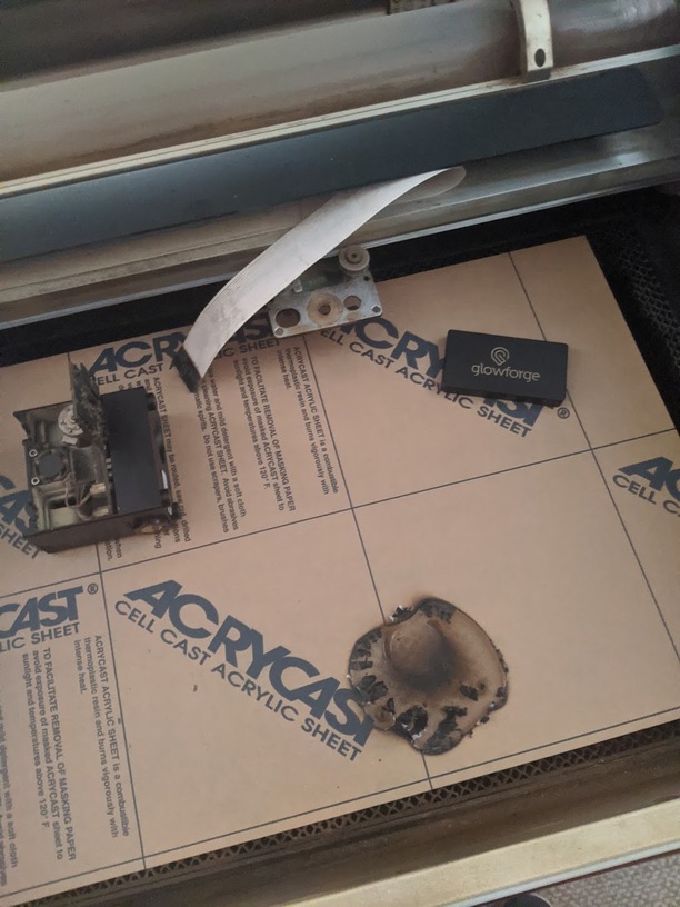

I’m not sure if I should post this here or not, I’m not sure if I have a problem yet or not.
I was engraving on 1/4th clear acrylic, which I’ve used this same material many times before without incident, but this time I got a overheated error and the gf stopped printing on its own. I got up to look at the print to see that there was a small fire around where the print head was and the acrylic had melted.
Now I’ve seen my share of little flames here and there, but this is the first fire I’ve seen. And it was still burning until I opened the lid and blew it out.
I’m only speculating here, but the only thing I can think of is that the print head must have stopped moving and was continuing to engrave the same spot until it got too hot and caught on fire. You can tell from the photos that the melted area is pretty large so it must have been there for more than 5 minutes or so.
I don’t have video of this… I wish I did. I always watch each cut/engrave at the start to ensure things are going as they should and this time was no exception. And then I usually leave it alone and check on it once in a while… but never more than 10 feet away at my desk. So I know the print or engrave started fine.
The print head was, and still is as I write this, very hot. Too hot to even hold by bare hands. Doesn’t look like anything melted on that. I notice blacken areas where the sensors are but those usually get dirty and can be cleaned, so hopefully this time is no different.
I also removed the lens and mirror from the print head and don’t see any issues with those either.
I’ll report back after I let things cool down for a few hours, and try to start the gf up again. I will do a simple cut to see how it goes.

But I have now ran it… after a deep clean to ensure there is no smoke or burn marks anywhere… and it ran just fine. And I did watch the full 20 minute engrave this time.
While this is good news, but still not sure why it stopped in the first place. Perhaps it stopped because of over heating and for some reason the laser kept firing even though the print head stopped moving? Not sure. But again, seems to be running fine now.
If the head was too hot to hold, that would set off the normal overheating sensors. I have observed that the internal fan operating with insufficient movement alone can cause such positive feedback loops that rather than cooling the head it keeps on heating it more. that has happened perhaps twice in the past year when I paused the machine.

I’ve extracted the log files from your Glowforge to review the print you noticed this behavior. Based on the logs, it does appear that the print failed due to the Printer Head being too hot. However, it does appear that after performing a deep cleaning, and checking all of the components from inside of your Glowforge, you were able to perform some additional prints. That’s great!

As you can see, it cleaned off pretty well. I did an overall cleaning as well… which I normally do anyway. And I had cleaned it just before this print too… always only use the Zeiss wipes and sometimes the spray on the glass…
I know it get too hot… I had saw the error / warning message for that. What I want to know, if you can tell by the logs, is if when the print head stopped, did the laser keep firing? Or did everything stop because of the fire and the fire is what melted the acrylic? I just want to figure out what started the fire.

This print was one of those cases where unusual readings of extremely high temperatures caused an alert, which paused the print.
Pausing the print stops both the laser and the motors, the same as when you pause manually.
