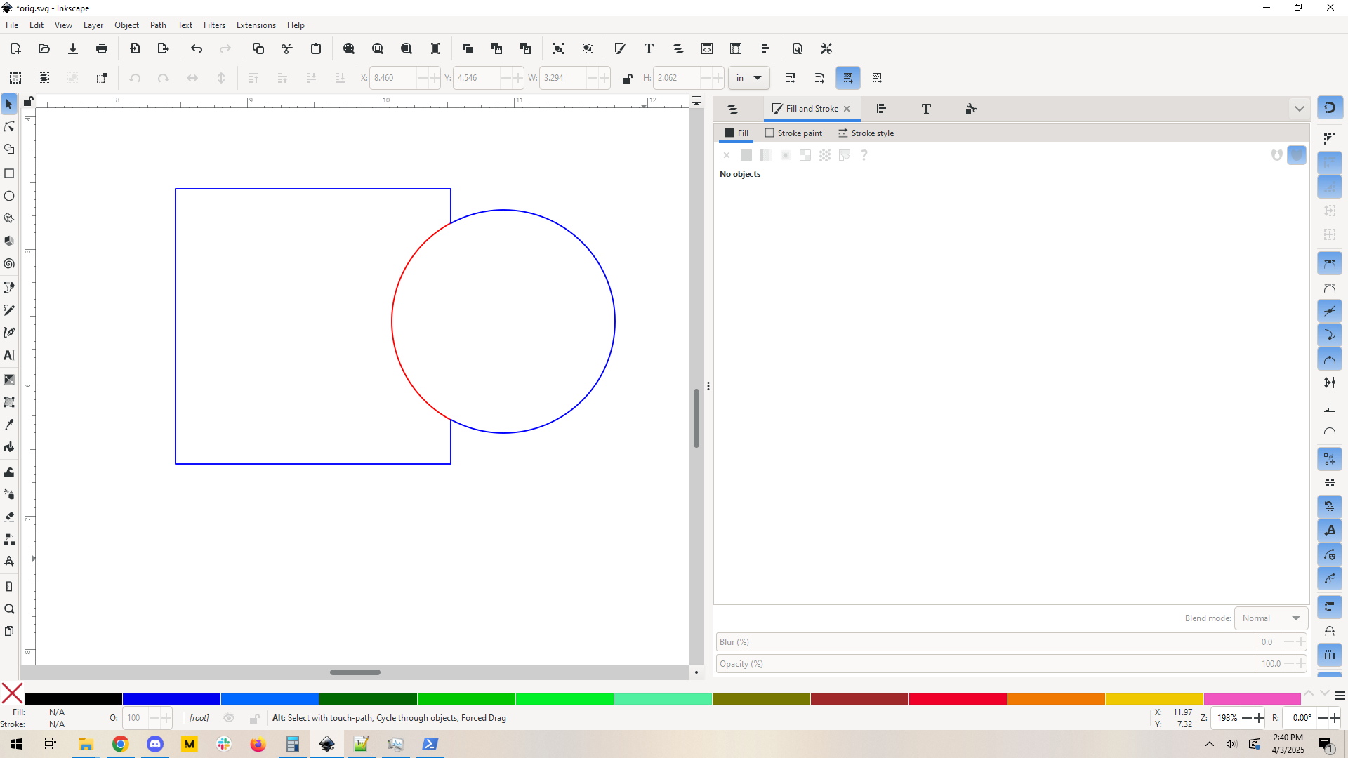

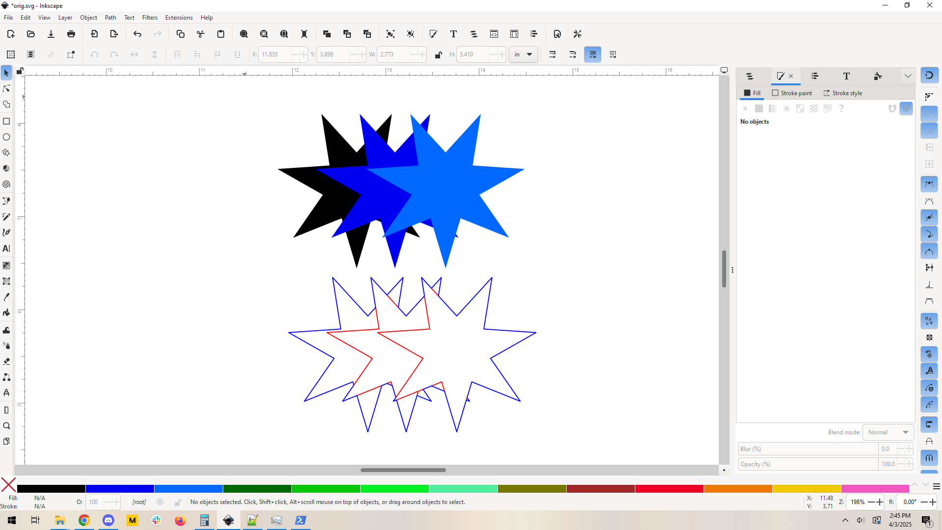

When you have overlapping shapes, it can be a tedious job to union the shapes and preserve the overlapping lines. I built an extension to do it for you. Here’s what it does.
It converts this:
to this:
I know most people are impatient, so here you go.

This is new beta stuff, and it may break. I’m only one person with one computer, you guys would be doing me a huge favor if you not only test it but also break it. If you do break it, please reply with the svg that broke it so that I can reproduce the issue and try to resolve it. Use undo to get the svg to the point where it is ready to break the extension, and save and send it along.

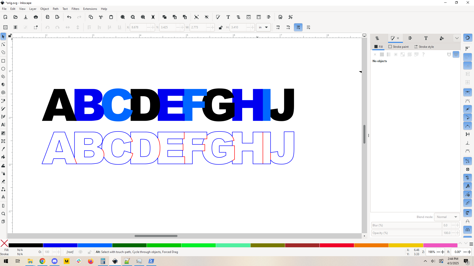

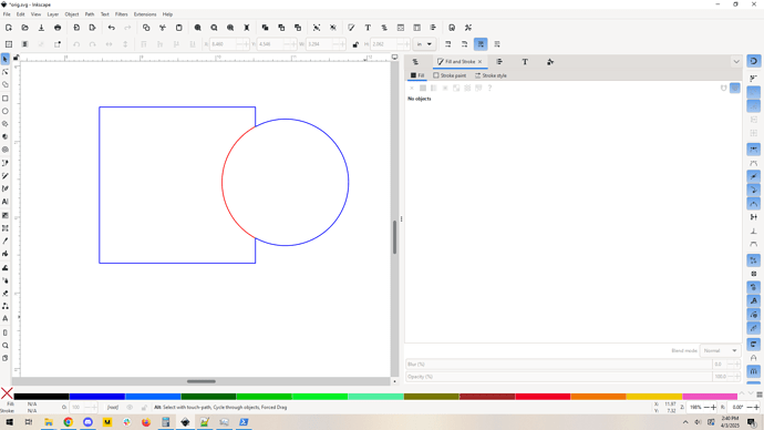

More examples:
And a stress test:
BTW, good guess:

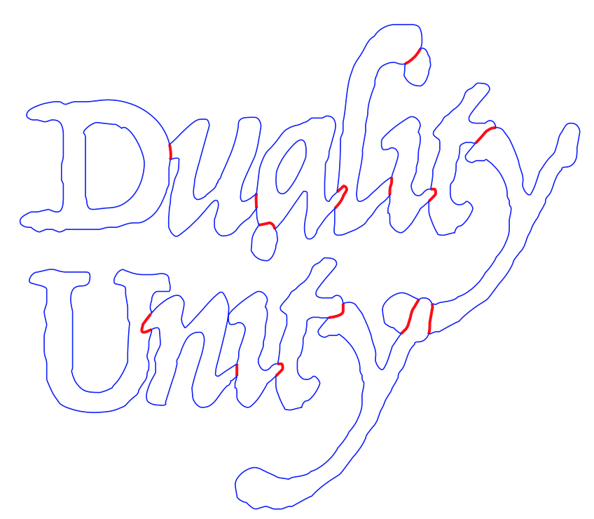

Here’s a more complex one I just made, inspired by the original lettering example someone else had posted using cuttle.
Looks like it worked properly?
Yup, no problems. Just sharing for reference.

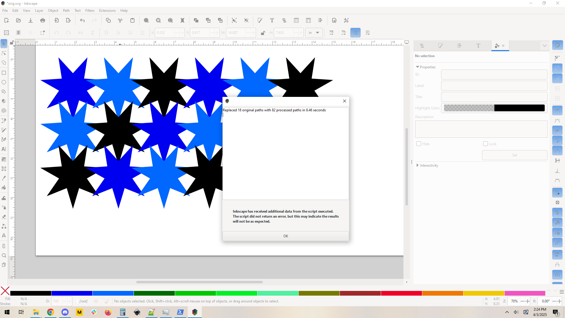

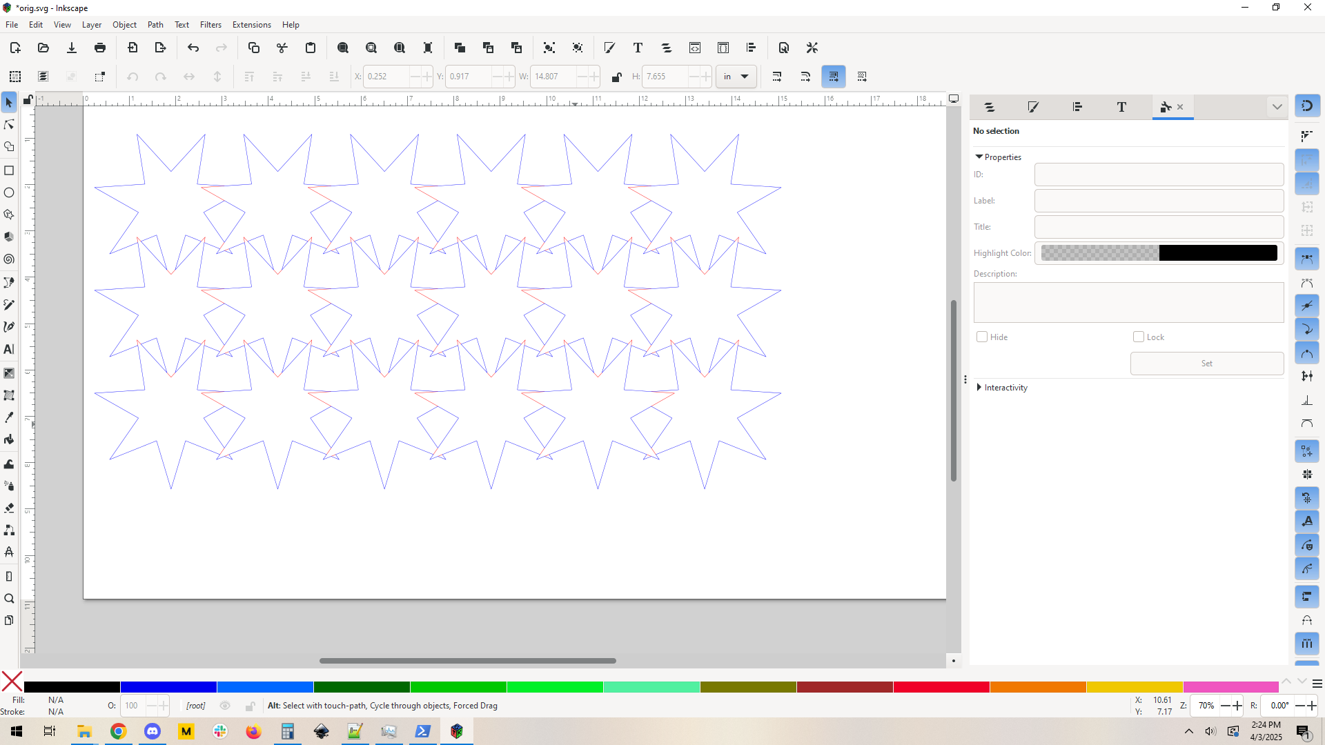

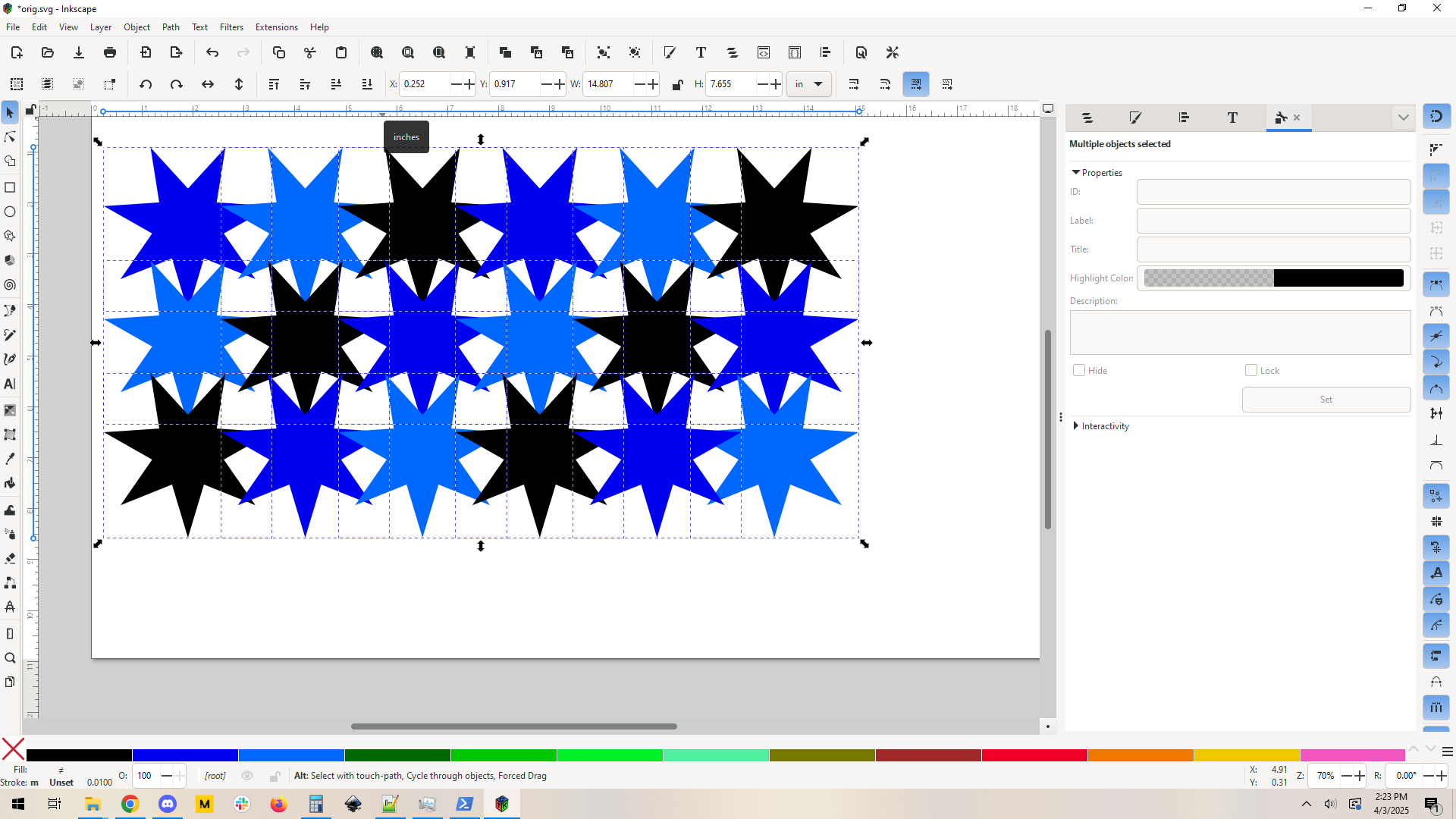

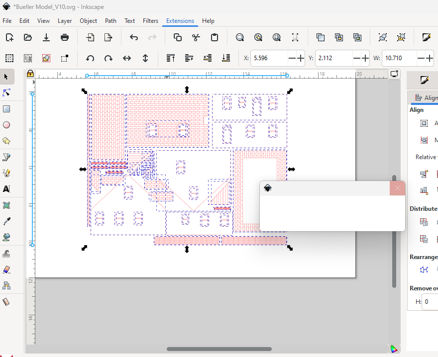

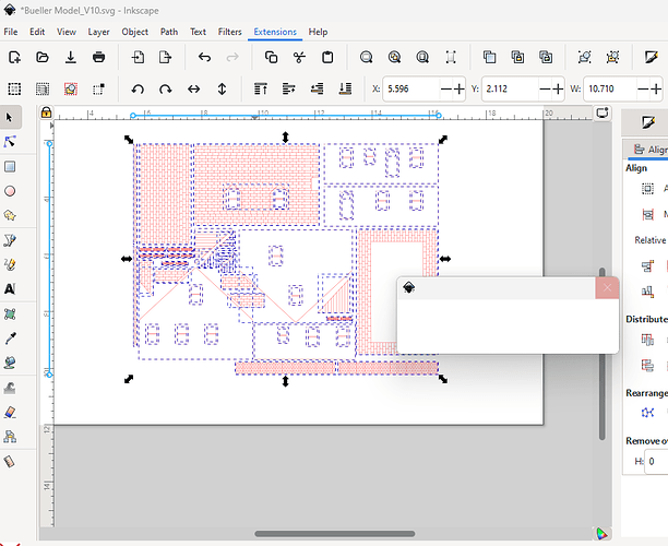

So it’s been a bit, but I did manage to break this. Well, sort of. It didn’t fail, it just locked up. I let it stew for a good hour and it remained locked so I shut down the program.
Bueller Model_PluginTest
It’s possible the plugin wasn’t expecting things that were completely inside, so this may be a bad usecase - but I wanted to give it a shot!
Can you explain in a little more detail about what you’re doing?
This plug-in is supposed to preserve parts of shapes that are overlapping each other… This design looks like it’s not the original use case but I don’t really want it to lock up.
