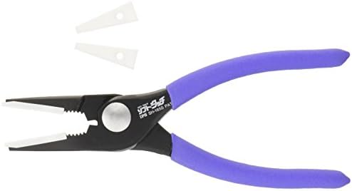

When assembling most designs the hammer works fine. However there are some designs where a hammer won’t fit or is just not the right tool.
I have been looking at this on Amazon:
Has anybody used this tool or has a better idea?

I guess it would help to know what you’re planning to use them for. I’ve never used pliers of any kind on a laser-cut project (or a hammer, for that matter.) Clamps, yes.
I have a pair of similar pliers from back in my RC modeling days. I used them so infrequently, I have no idea where they are.
My fingers are just not that strong anymore to assemble many of the Glowforge (and other) designs and a hammer is necessary, or glue - which I hate. Also, after assembling, some projects need tweaking and pliers seems to be a good choice.
Looking for anyone who has experience with these or other pliers.
Well, when I used them, as mentioned above, it was for RC modeling related work - which did involve a lot of wood, especially balsa. They weren’t any different from regular pliers, which is why I never really used them a lot. Just a gentler hold with regular metal pliers worked just as well, and I could get a set of six different nose types at harbor freight for a few $$.
I think they are really designed for things that need a really firm hold without damaging the surface - like brass pins and such.
When I need non marring pliers I just wrap my existing pliers in masking tape. Maybe give that a try before you buy the tool?
Good point! I’ve put duct tape on the jaws.

I take my regular needlenose pliers and tape a piece of leather to the insides - it gives you a nice padded lip with lots of grip.
I would recommend parallel-jaw pliers instead. this will give you more grip along the entire upper and lower surfaces rather than just at a point. Ever had an object twist out of the grip of your pliers? this will solve it, and has padded jaws as well.
