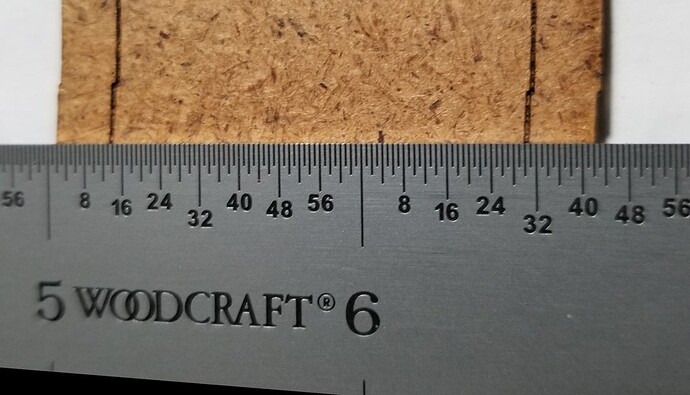

This is afollow up to my 98% success post.

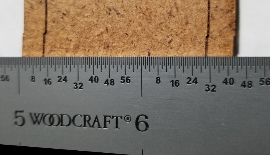

The offset of the score on the left side side of the longer design was about 0.010"
and about the same for the cut line. Harder to measure on the right side, but less than 0.010". Does the alignment always converge to the same result or do random factors cause different runs of aligning the same part give different results? Would it be possible to report how far off the alignment may be? Clearly, the method can align such that there is no noticeable difference in the two aligned paths. How does one know when the alignment is good before executing the cut?
Hi Jeffrey,
Thank you for providing this infomation and posing these questions! I’ll be sure to review this with Ivan next week.
Thank you for this additional report and the thought’s you’ve shared!
Regarding the app sharing how accurate the alignment result might be ahead of time, the app doesn’t have that ability currently, but that’s a great idea for a feature! I’ll share the idea with our product team with a note that it came from a Glowforge owner.
I also spoke with one of our engineers to see if they had any additional advice to get even better results during your Pro Passthrough prints, and they shared the feedback that wider prints are more likely to have even more accurate alignment between slices than narrow prints. If a design is particularly narrow, it may help to add some symbols to the left and right of it and set them to score during the print. Please let me know if this information helps!

As far as adding additional visual features to the design or material, any shapes can be used and even drawing on the material itself with a pen has been a strategy we’ve seen people use successfully in the past.
