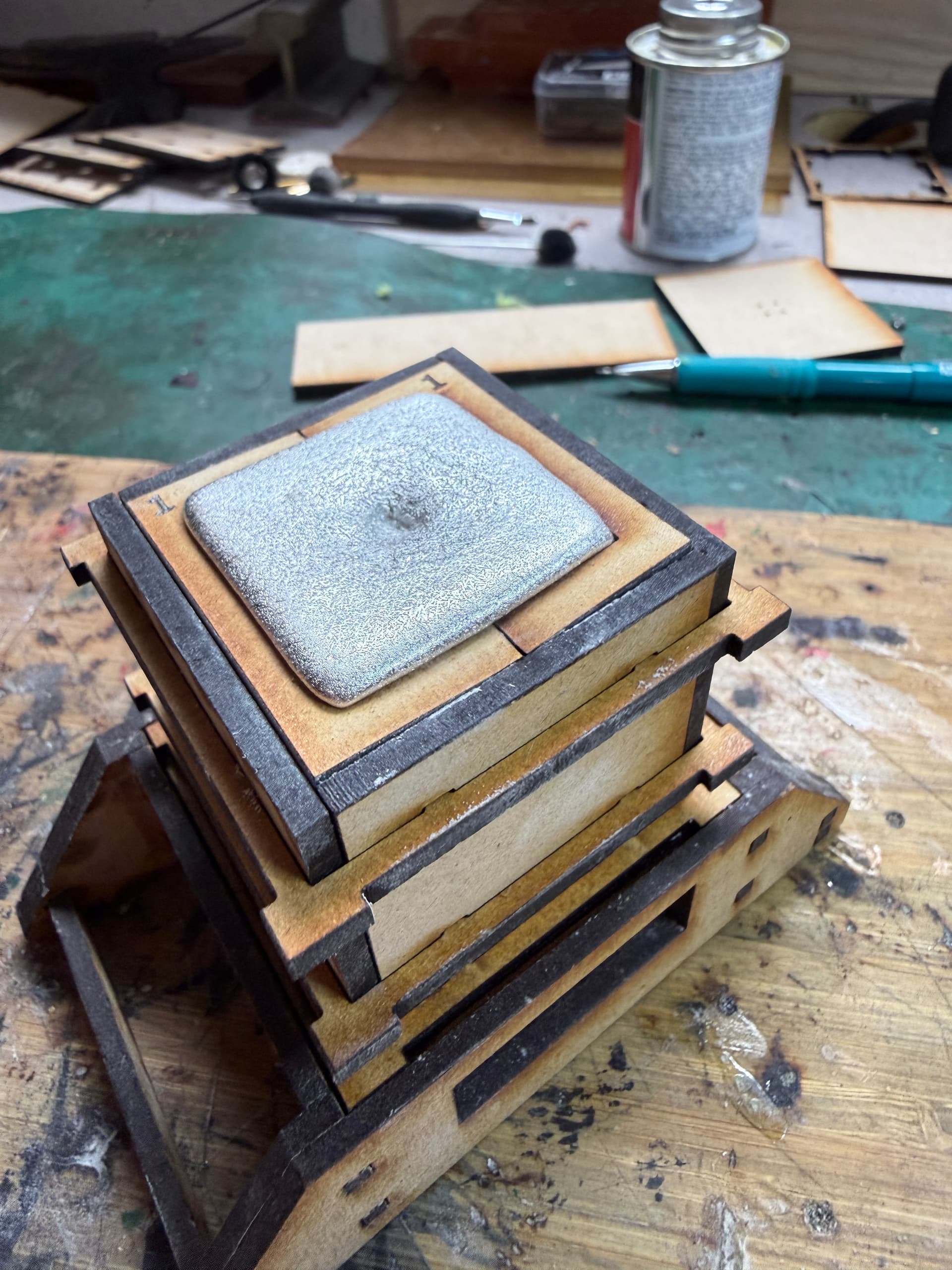

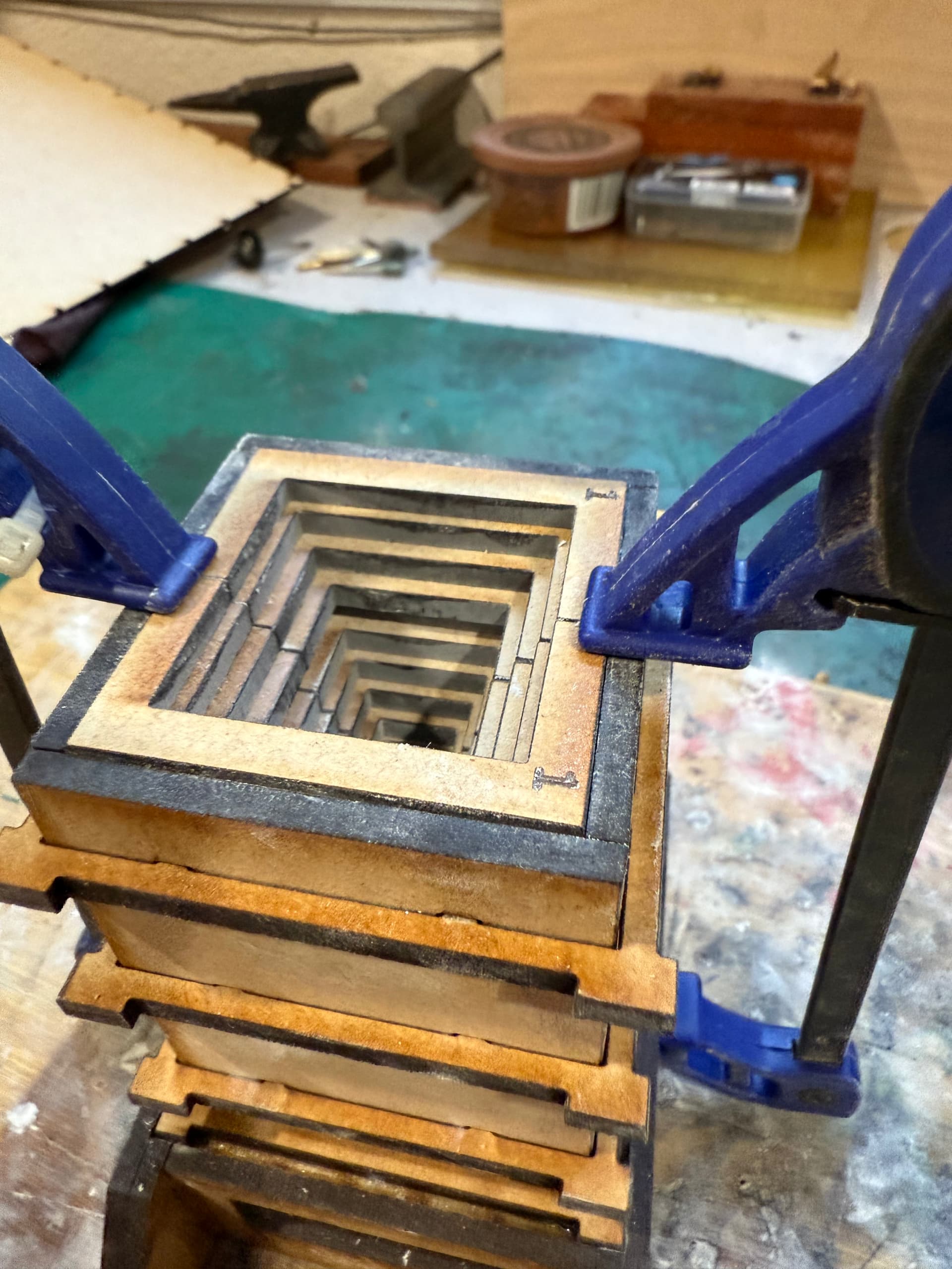

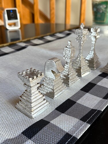

Pewter chess pieces made with draft board molds
These are some pewter chess pieces made using draft board molds.

Oh wow! That is fresh! Hmmm…what are the hurdles of getting into pewter melting?

working on a set and a leather coverd board…taking a long time.. :grin:
Thanks for sharing this bit of inspiration. I hope you will share the completed board and set when you are finished.

What’s your plan for the two colors? Paint or an additive to make the pewter darker?
It’s not an additive but brushing on or dipping into a solution of liver of sulfur will blacken pewter.

i’m going to try and paint them. anyone have ideas on the best paint?
just need some pewter and a thing called a hot pot
You might consider making the other side round instead of square on the bases, then do what @jamesdhatch suggests.
That will get you light and dark pieces that are easily identified by both color and shape.

The best alloy (IMNSHO) is Britannia pewter. It goes back to the 1800s and used by the Sheffield pewter artisans. It looks and tools like silver.
But what’s more important is the lack of lead in the alloy. Most domestic shelters don’t use lead in their alloys but it’s a crapshoot with overseas producers. If your ingots tend to tarnish black, it’s got lead in its makeup. If you have questions about sourcing or whether it’s really lead free you should test using a lead testing kit.

We always painted pewter miniatures with acrylic paints - anything that’s not labeled a student paint will likely do fine :slight_smile:
