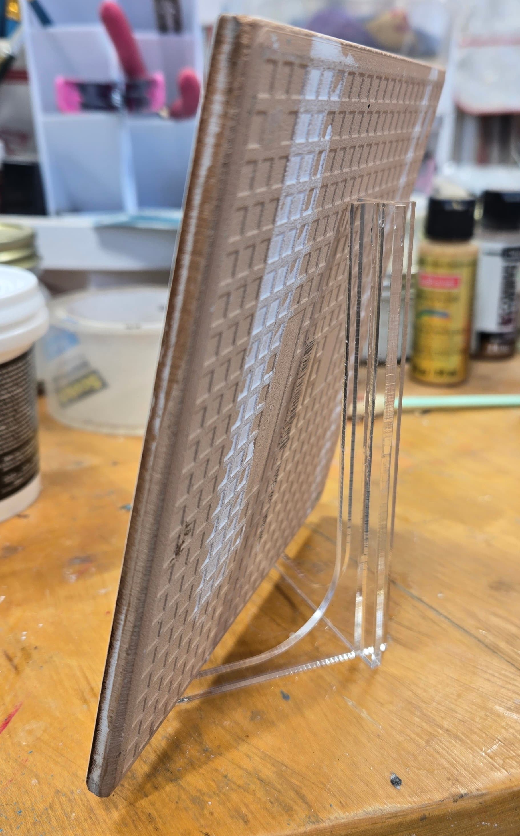

Hey everyone,
I hope this isn’t taken as an affront, but I toyed with the design a little bit because the fit was just a little too tight. I’m also working with a partner and we both decided that some back leg support was also needed. So taking all the comments in the thread to heart (specifically the scaling around the slots) this one seems to slide together just right. Enjoy.
Yantra Stand2 Yantra Stand2 Yantra Stand2.ai (49.4 KB) Yantra Stand2.pdf (49.2 KB)

Hey Steph,
Thank you got sharing this file. I am trying to figure out how to adjust the slots to fit 1/4" thick wood. Any suggestions on how I can do this? I am very new to glowforge so any help would be greatly appreciate it :slight_smile:
The OP has not been on the forum in almost a year.
Measure the actual thickness of your material (1/4 is rarely 0.25"), then adjust the slots in your design software so the slots are a little under that dimension to account for kerf (usually around 0.001" or so, but test first).
You could try this recently posted variation by @trun which is parametric (you can customize it).
It lets you type in the material thickness — which automatically adjusts the slot — and download an SVG.

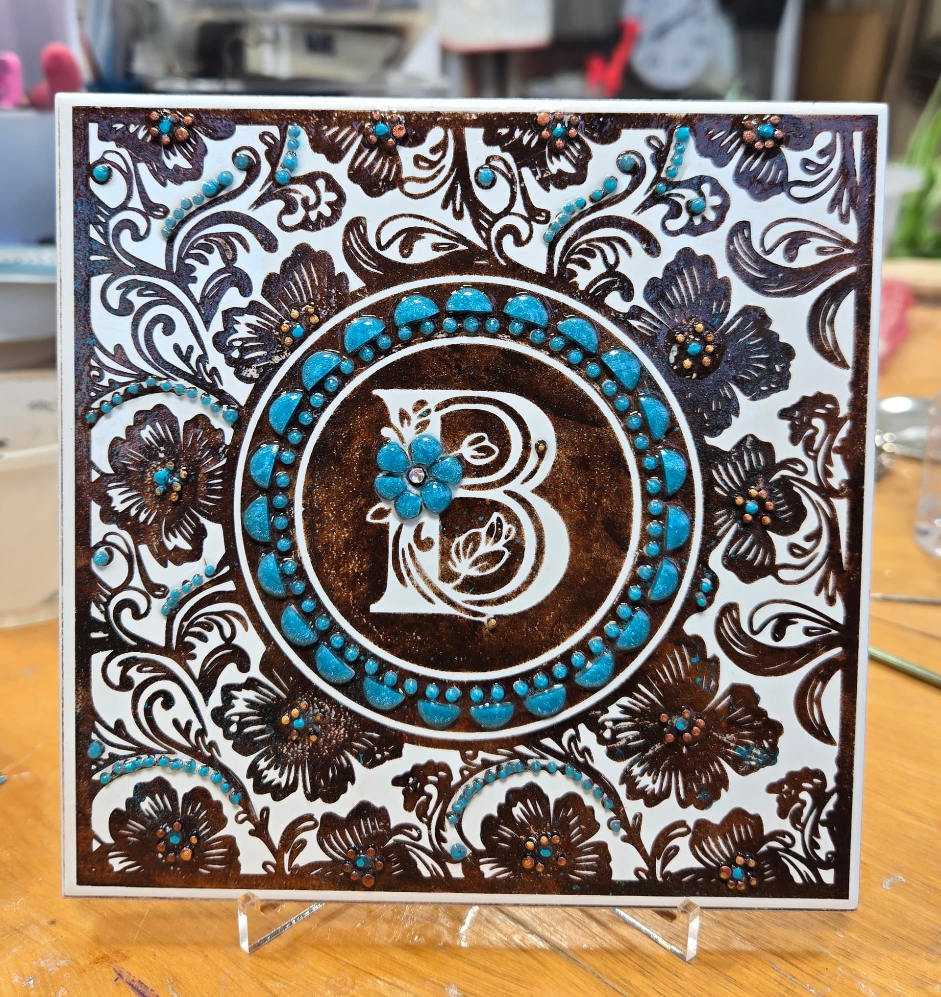

@deb_gaines717, we’d love to see a picture of what you did with yours :smiley:
This isnt totally finished. I still need to add another coat of Brite Tone varnish on it. I etched the masked white tile with my Glowforge on settings 700 /Full/Dot/340 LPI twice. The masking with diagonal & horizontal lines allowed me to center the tile better with my design.
Then I sponge painted the brown acrylic in, let dry, & removed the masking. Any over paint on the smooth tile easily came off by rubbing with paper towel. Then, because this is for my granddaughter, i made the copper & turqoise colored shapes out of polymer clay & glued them on after baking.

Oh & the stand was quick & easy! Thanks Steph for posting
Gorgeous. I love the clay enhancements. They really make it pop. Quite distinctive.
Thank you, I appreciate that.
That’s lovely! I like that the stand is both supportive, and completely invisible :smiley:
