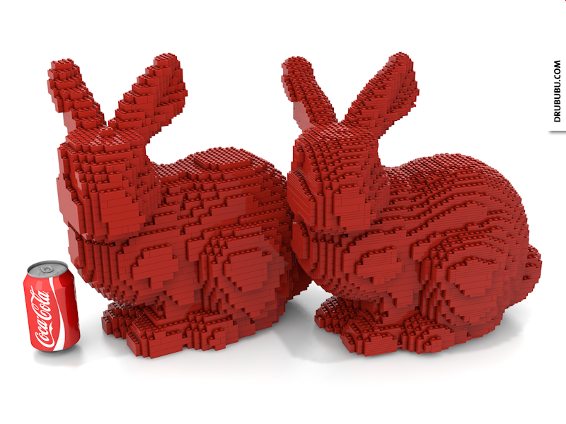

My son wants to take a 3D model, and “pixelate” it. So a 3D model of Mario would be converted to something like this:
Once it is pixelated, it would be nice be able to see each layer separately. This would be similar to what 123D Make does with slicing. But first we would need to pixelate the model, and then each slice would have to be subdivided into individual squares.
Specifically, he wants to do this to make “Lego instructions” for some 3D models. Each “pixel” would represent one Lego brick.

I have seen a few programs that will do this. Unfortunately i don’t think any of them were ever fully released.
LScript Studs-out Lego looks like an interesting option.
https://code.google.com/archive/p/lsculpt/
Legolizer looks like it would be awesome, but unfortunately it isn’t available for purchase. But it sounds like he will convert models for people for a price.

There are photoshop actions that turn a 2d picture into “lego” look. What if 123 Make cut the slices then you used that on each horizontal slice? (albeit very time consuming, but in theory?) There is the online brickify that will convert a file into bricks. Also legolizer chrome download(and I found a script for 3dsmax online to convert to “lego” bricks- in a cgarena.com forum)

It brought me to this page: http://www.cs.princeton.edu/~min/binvox/ Which looks like it’s for creating minecraft models.
I was able to take this:
and turn it to this:
I still have to play with the program inputs to adjust the voxel size.
Once I figure that out, if I resize my input model appropriately, I could probably use his program to create the block pattern. Once I have that pattern, I can use 123D Make to cut it into slices.
It’s not pretty, but it should work.
I would still like something a little more kid-friendly.
In case anyone wants to try this program out themselves. Here are the steps I used (in Windows):
  1. Download the program to your computer (http://www.cs.princeton.edu/~min/binvox/)
  2. Click on Windows Start and Type “cmd”.
  3. In the command prompt window, type: cd c:\users\[yourusename]\Downloads (where [yourusername] is your windows user name).
  4. Type: binvox.exe -d 45 c:\Users\bgatien\Desktop\Dinosaur.stl, (substitute the path to your stl file) This will launch the slicing program. It takes a few minutes to execute.
  5. Once you are done, you can view the voxel file. I downloaded the viewvox.exe program from the same site, and typed: viewvox.exe c:\Users\bgatien\Desktop\Dinosaur.binvox
I was able to change the block size by playing with the -d option. I think by default, it makes a 256 x 256 voxel model. By specifying a different -d value, I get something like this:
Now I just have to figure out how to convert from one of his output formats (.binvox, HIPS, MIRA, VTK, a “raw” file format, minecraft .schematic format, Gmsh .msh format, and nrrd format) into something that can be read by 123D Make.

This might be of some use: Kiri:Moto & Meta:Moto
Awww, I was too late to the thread.
As I read the initial post, my first response was: ‘The easy way is to do a Google search for “Minecraft ______”’
@polarbrainfreeze’s approach with the binvox seems VERY similar to just using a Slicer with 0 perimeter walls, 10% infill, rectilinear fill type, and 0 degree Fill angle.
That would make you lots of nice squares to fill the model. Make your layer height be your desired block size, play with % infill to obtain proper block size in those dimensions. Remove or complete all partial blocks.
Back when I was following the ZBrushWorkshops training, one of the lectures covered the evolution of the adaptive skin function. Among the things shown was a regression of a sculpted model to what this thread refers to as a pixelated (or voxelized) form.
It doesn’t have to start with a sculpt. Any STL or OBJ mesh can be imported into ZBrush. Here, a sculpt previously created in Sculptris is brought into ZBrush 4R7.
The target tool here is the Unify Skin function. The higher the resolution, the finer the pixilation gets. The slider goes down to 16, but here I cranked it to 128 and set Smooth to zero. Hit the Make Unified Skin button…
…Aaaaaand nothing happens. The 3D sculpt in the canvas hasn’t changed.
That’s because instead of ZBrush destructively changing the 3D sculpt, it ADDED a new object to the sculpt collection. This area permits working on concurrent sculpts while they stay quarantined.
Just click on the recently added item and it’s instantly loaded into the canvas. Voila, one-click pixelization of any 3D mesh.
ZBrush menu > Zplugin > 3D Print Exporter saves the object as a common OBJ or STL mesh. Bring the pixelated STL mesh into Rhino3D.
Drop a vertical line in front of the mesh and do a Curve > Curve from Objects > Project Curve command. Rhino asks for an object. Facing it head-on, click the lion mesh and the resulting projection has now created a line profile for that layer.
A Rhino3D ninja would probably Transform > Array a series of lines before executing a combined Project Curve command. In one swoop, profile curves for all layers gets created.
Better still, blast a hole through the side of the lion mesh at the start of all this and each layer of the projected curve will now also have an accompanying registration curve.
Export the projected curves accordingly to the Glowforge.
