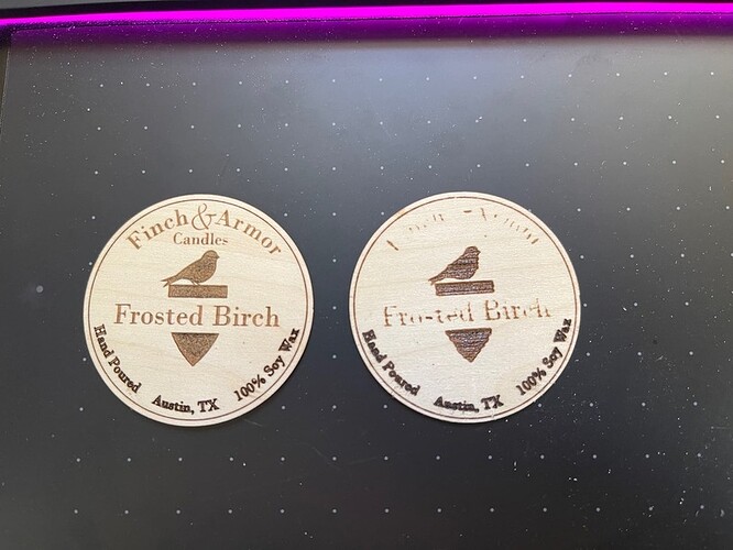

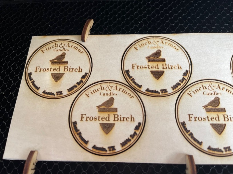

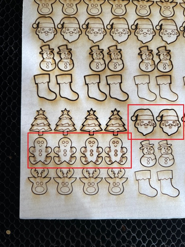

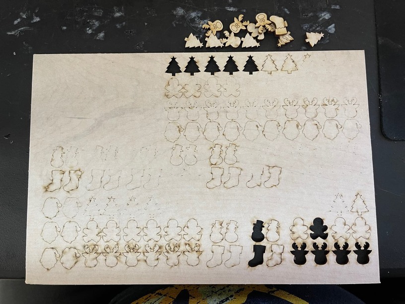

The biggest issue as it is impacting my business is lately I am getting very inconsistent engraves and cuts. Here is a job I ran today on 1/8" Hard Maple.
It didn’t cut all the way through on over half of the pieces. I thought it might be an issue with this piece of wood, but ran 3 more times on other pieces of wood with the same outcome.
There are also spots where the score lines almost look blurry compared to the other score lines.
I do a ton of engraving on Maple veneer as I use it as labels on our candles and recently I have bee having very inconsistent results such as this.
It almost seems that these issues are worse when pieces are being worked in the lower left quadrant of the Glowforge.
Anyone seeing similar issues or have any magic words, this is starting to impact us for upcoming Holiday shows. Also, I do regular maintenance about every 20 hours of run time, so all lenses and components are clean.
The further forward the work is being done, the farther the laser has to be thrown - so things like dust or scratches on the mirrors or lenses can increase errors.
Also, the losing focus can sometimes be because debris has gotten into the channel the lens moves up and down in, in the head - especially check the little tube that goes between the tiny fan on the motherboard and the tube.
When you say
Do mean it didn’t cut in exactly the same spots, or just that some spots didn’t cut? If the latter - do you have that issue using PG and PG settings, or are you using non-PG material and/or settings? If the latter, are you settings input each time or saved - some folks had issue recently with saved settings getting messed up.

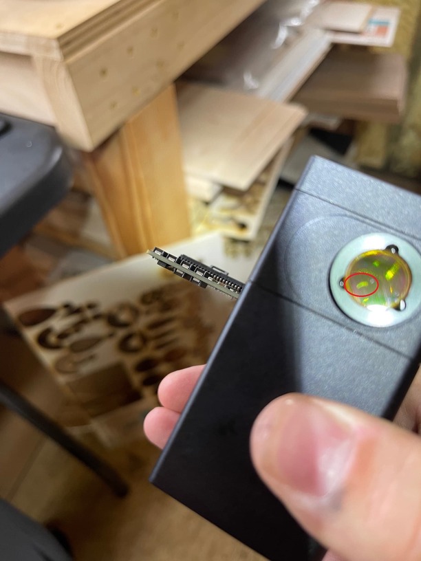

Well the good news is I did a deep clean on the Glowforge this morning, including cleaning the air assist fan and did the same job and it came out much better. All cuts were fully through the piece and the score lines were sharp. There was still a little bit of distortion with the engrave parts, but I may have found the overall issue. When I pulled the printer head off to clean the lenses, I started wiping the side lens and it was loose. I unscrewed it completely to inspect it and noticed on the “inside surface” of the lens, there is definitely a scratch. Very hard to capture a pic of it, but I got a blurry pic of it. Hopefully Glowforge support will get back to me so I can get a replacement lens.

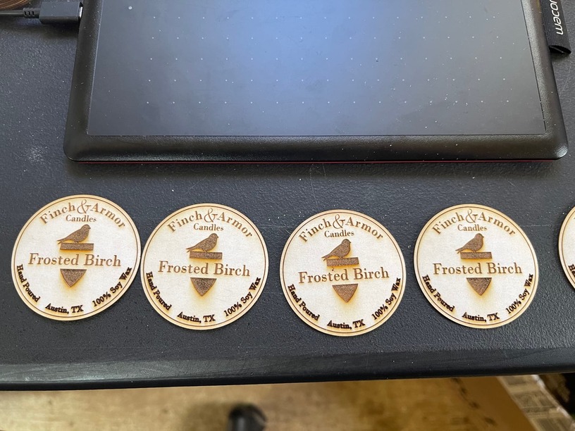

Hi Jeremy! I am still having lots of trouble getting consistent results. I am waiting to receive the new lens, but I am beginning to believe the issue is not with the lens. I made these labels labels last night and they came out perfect (as they always did up until 2 weeks ago).
I ran another batch right after these finished and some labels came out alright, but others came out horrible.
I didn’t change any settings, I placed the new sheet of veneer in approximately same spot on the crumb tray. In this pic you can see one label came out almost perfect, but the one right next to it came out terrible. If this were a lens issue, I would expect the results to be fairly consistent, not wildly different on the same job.

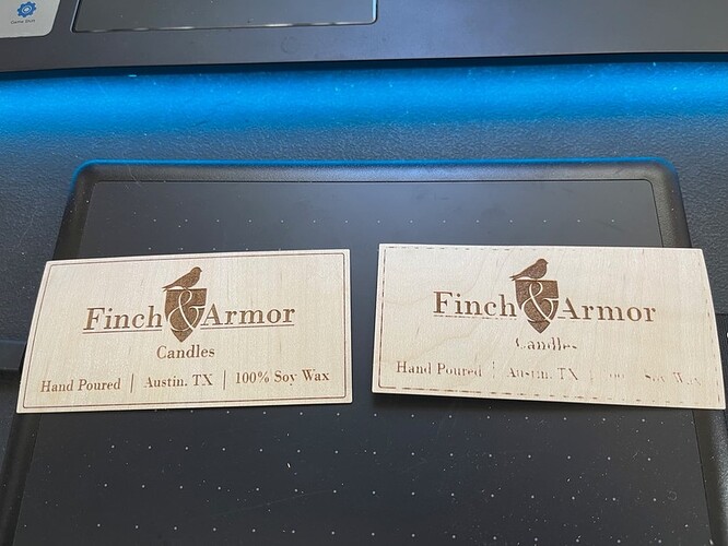

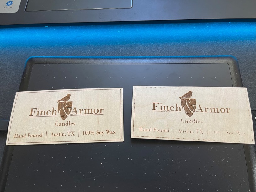

Here is a side by side after unmasking of a label from the good batch and one from the second, bad batch.
The engrave didn’t even penetrate through the mask in several places and the scored text at the bottom is not sharp and legible as it is on the left label.
I am also still having the issue every 5-6 jobs where the UI says still cooling and the exhaust fan run on low and will not shut off until I power cycle the Glowforge.
Also, I called the support number this morning and waited on hold for about 50 minutes and then got an automated message to leave my name, phone number and a description of the issue and someone would call me back, but then didn’t allow me to leave a message, it just disconnected the call. I would appreciate some assistance from support.
In your last photo, the one on the left was engraved at the correct focus height, and the one on the right is what you’d get if you engraved the same design but at the wrong focus height. That should narrow down what’s going wrong to something involving the focus setting… the autofocus dot missing the material, or the glass windows on the bottom of the print head dirty, something wrong with the focus mechanism itself that moves the lens up and down in the print head like debris in that cavity, or some kind of software bug resulting in the wrong focus height being used.
