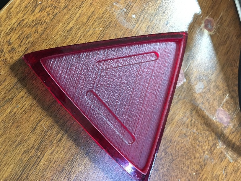

Here’s some more random photos. One of them is the acrylic after being defocus engraved after regular engraving. Gonna try just doing defocused from the get go

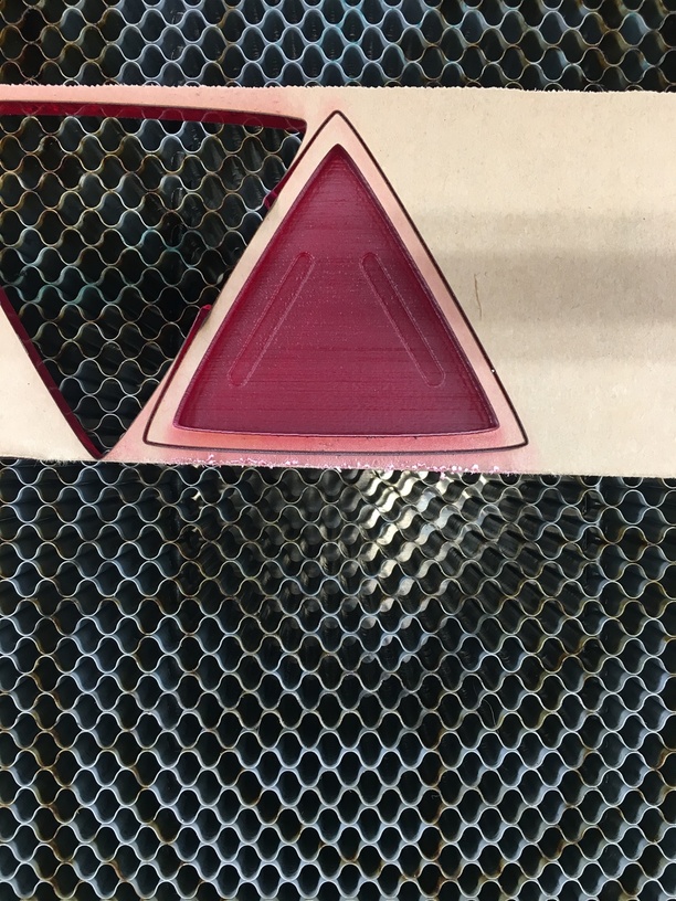

Did you produce the outer bevel on the acrylic triangle with the forge, or was that done another way ?
John
Heres what my file looked like. Cut outside perimeter. Engrave black is a deep engrave, engrave grey is a shallower engrave.
I wish I had a photo of the outside cut on this though, its so clean. really happy with the edge quality the glowforge is giving on acrylic.
I must assume then that it’s just the lighting that makes it look like the outer edge is bevelled ?
No actually a failed cut attempt (accidental incorrect focal length) rounded the outer edges. Defocused engraving rounded the inside.
That’s a very useful bit of knowledge. Thanks :smiley: :smiley:
NP. If you do a defocused score you could probably achieve the same results on purpose! =)

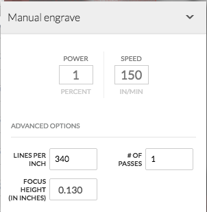

Is there a thing in the UI for defocused, or just manual focus and lying to the machine?

You set the focus height at the bottom. 1/4 is going to be the worst thing to attempt to defocus engrave because its right in the middle of the focus range, so youll have 1/4" defocus range on that max at the beginning.

A quick workaround is 1/4" spacers, to bring it to the top of the focal range.
