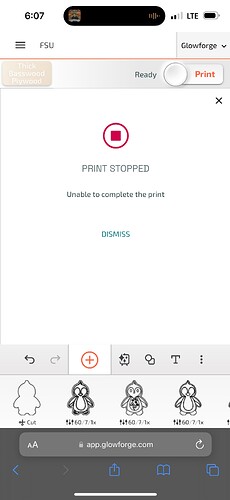

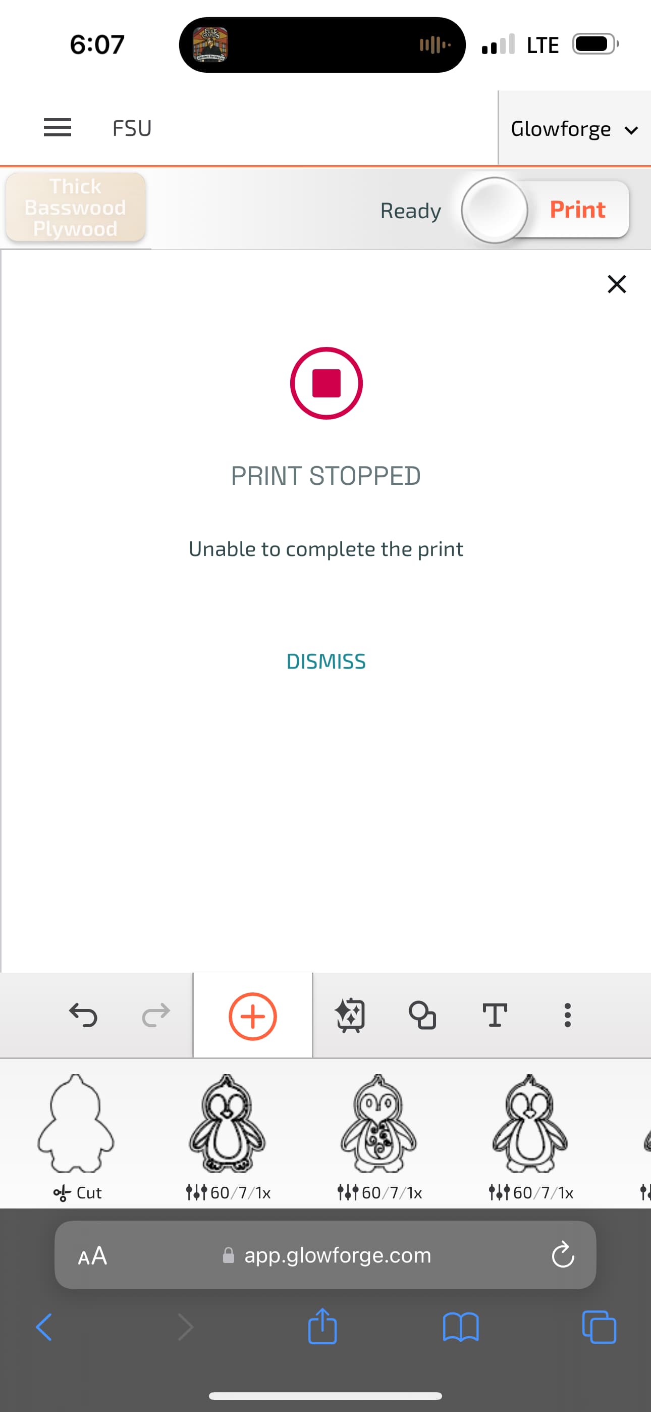

Print stop. Unable to complete
Can anyone help us try to figure this out??? I have been having issues for a couple of days and today my husband contact glowforge but they closed at 3 so they hurried him off the phone. First the machine sounds as if its running and when we go to check the laser isnt firing and the arms have stopped moving, this is occurs after its completed probably 3 mins of the print. Last night the thing was turning on and off all by itself and tonight its just not working. I did noticed that it feels easier to pull the head from the harness as if the magnets arent working as good as they did. I have only had this aura since November and here we are, and I cant complete my work. If someone could give us some ideas that would be great. I attempted to attach video but apparently its too long.
