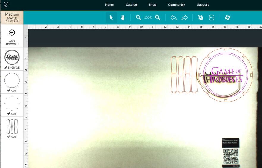

My engrave started fine and then suddenly shifted to the left and started printing flat on one side as if it is hitting an end stop (which may well be what happened). It looked fine in the work space and accepted the print but behaved as if I passed a limit. Is there something I am doing wrong or is my machine hosed?

I powered the system off, powered back on and ran the gift of measure as far to the right as it would permit. It did not encounter the same issue. However, the general shift to the left seems to be getting worse. If you look at the image, the actual cut is over 1/2 inch to the left from where it is displayed in the work space.
