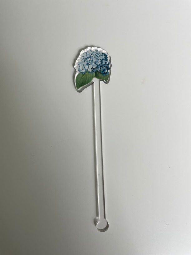

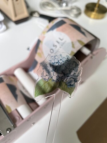

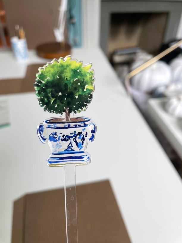

I’ve been trying to do the same thing for a few months now and it’s still not perfect. I designed the sticks in silhouette studio because that’s the program I use. I then cut them out of acrylic using my Glowforge. In step two, I print the images on sublimation paper and then cut them out with my Silhouette Cameo. Lastly, I sublimate the images onto the stir sticks with my heat press. My issue is that the image is translucent and the colors only appear bold when it’s either painted white on the back or if the acrylic is lying flat on a surface. I’m not able to get bold colors on both sides. I actually ordered some from another seller to see if I could figure out the process but no luck. it almost looks like they used a double-side print and decoupaged it to the acrylic but I doubt it’s that complicated. If I find out anything else I will share it and please do the same if you are able to figure it out.
Tans for the information! Can you send a photo of what you mean for the image being translucent? I’m not familiar with the sublimation in the sense that I’ve not done it yet, but I just ordered a sublimation printer and am in the process of ordering a heat press.
Here are two photos of the stir stick after it’s been sublimated. Translucent means that light passes through it so it’s se through as opposed to something that is solid where light does not pass through it. So when I have the stir stick up against a white surface it looks great but when you hold it up it’s see through. The stir stick with the bush in the blue and white pot is one that I’ve purchased and it is clear that oneside is a type of printed paper. It seems as if it’s been printed in mirror image so that the front image and the back image line up. Does that make sense?
Ohhh yes, now I understand what you mean. I think it’s because they’re doing UV printing, which would be great if they weren’t $15k :crazy_face: lol There are places here in Dallas that will print on acrylic for me and then I can cut but I’m afraid it won’t line up as accurately in the glowforge because you’d have masking tape on top. Whereas they can cut, lay in the UV print bed and move the images around just like we can on the Glowforge. Or maybe there’s a whole different process they use
