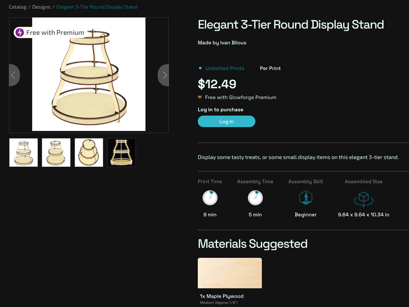

I not sure if the designer actually cut the project that was submitted, or the listing is wrong. I don’t see how it fits on only one sheet.
There are two pages if you actually download the project. Each page is for 1/8" material.
GF should probably correct the listing, then - it clearly says 1x 1/8" Maple Ply.
Someone once posted who to contact, I have no idea. I’ve never used any catalog designs.
My view is from my Dashboard after “purchasing”. I have the free with premium option.
Kind of misleading then. Prior to purchase, you should know how much material would be needed.
