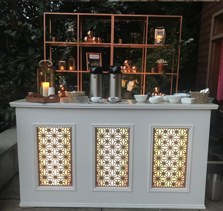

work is shut down so I will actually have more time to GF than ordinary. my alternative is yard work. to the tune of 8 hours yesterday. much nicer feeding stuff into Beamer. LOL
OK Awesome I really need this feature! I do the big stuff mostly hand cutting up this design to feed it through was not a fun or quick task

Ok, so I got the chance to move my machine this morning to test this awesome feature. Excitement was short lived… the first time. User error on part of it, system non-alignment for the other part. The second time the machine did pretty much what I expected from the pass through slot. YEAH!!!
Feedback from overall use:
Hang tight to the left side not the right. It worked perfectly hanging to the left side rail but didn’t on the right side rail. The score lines were a hair off, but since it is being painted it is fine. The cut lines were perfectly aligned. So… I am happy to report that the second test showed that the beta pass through feature does work when you don’t have user error. Now back to sign making. Thanks for everyone that helped me today! I would still like to try with cardboard or other types of materials than wood, but going and getting stuff is not an option at the moment. Excited about this feature and can’t wait to make even bigger things!

It was actually set to engrave on my normal saved settings. I did say score but meant engrave. As soon as pass through beta was selected my engrave lines completely disappeared from the screen. I wasn’t sure if that was a fluke so ran with it. Should have trusted my gut because they didn’t engrave. I may not be a super experienced user yet but do have my settings dialed in for engrave and cut on a 1/4 inch piece so I know I did that right.
So you’ve got a design file that is too big for the bed and the UI initially says ā€œNo Artworkā€ right?
Then you go up to the menubar and you select Passthrough (beta) does the No Artwork message disappear and the design change from gray to colored?
That’s when your engrave lines disappear?
I’ve done a bunch of engrave passthroughs with the auto-alignment about 3ft long - no real cuts though. I’ve had a couple of issues but not missing engraves.
Would you be comfortable posting the file or sending it to me in a PM?
Sent you a PM. So I turned everything back on and here is what is happening no matter what order I do it. I start with a blank slate (nothing on the screen workspace in the design space). You are right it says No Artwork. Then I upload my design. Still No Artwork because it is too big. Then I can select beta pass through or go set my cut/engrave settings. As soon as I set the engrave settings for the inside cross marks the engrave piece disappears off the canvas into never never land. I have tried it several times and my engrave lines just disappear no mater which order I do things. :confused:
EDIT: One thing I noticed was if I change them from Engrave back to Cut they show back up. But if I change them back to engrave they disappear again.

The inside cross piece lines are just lines - they don’t have width (to the GF) so they can’t engrave, they can only cut or score. That’s nothing to do with the Passthrough, that’s just the way the GF handles things. If you turn them into an object with fill, they work as engraves. Just make them very skinny rectangles in effect.
The diamond has both an outline stroke and a fill. You can engrave, score or cut. But since it’s the cut, the fill is superfluous.
Ok, so THANK YOU for your help! That was it the score lines did work. The cut was flawless (I will go back and update the original post. But the score line was still off a hair. But since it is going to be painted it isn’t a huge deal since the outside line was perfect. :slight_smile: THANK YOU!
