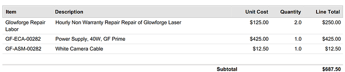

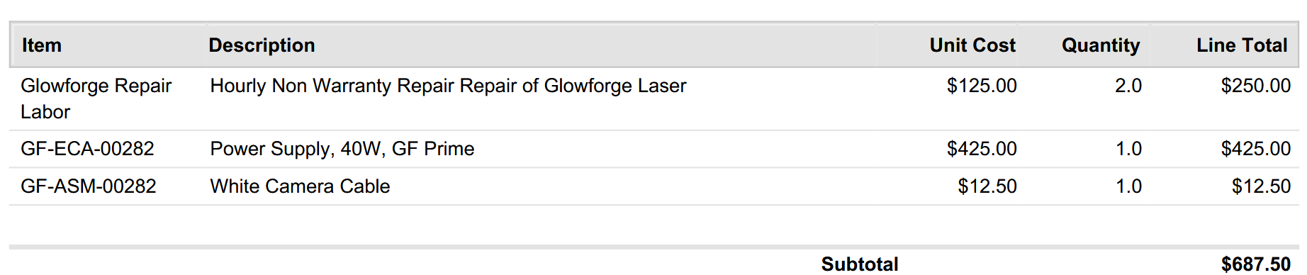

  1. I filled out the Glowforge Repair Form at Glowforge® Preferred Service Center – Wiregrass Made
  2. Jonathan S replied via email with a breakdown of possible causes for my Glowforge’s symptoms and an estimate for the repair cost
  3. I agreed to move forward, they replied back with a $300 invoice to cover shipping both ways then provided a return shipping label
  4. They repaired the machine and sent an invoice, which came in about $200 under their top estimate
  5. I paid the invoice, they shipped back my Glowforge and UPS delivered it yesterday evening
I didn’t inquire about replacing the tube or a warranty. This is the invoice:

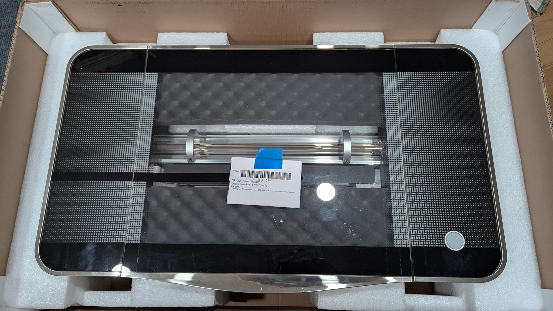

And “Phoenix” has come back from the dead a second time, this time shined up almost good as new. I don’t know how they got the tube this clean again! Tested and working.

Last year my 5+ year old GlowForge Pro needed repair. After taking many pictures and trying all the things Support told me to do, I was offered a refurbished machine. I took it and it lasted for about two months and Glowforge sent me another machine. That one lasted just over a year.. This time no refurbished machine was offered. They did offer a $1000 discount on a new pro machine and told me about Wiregrass Technologies. I didn’t want to spend $5000 on a new machine so I sent an email to Wiregrass. They sent me an email on how to proceed. So last week I paid the $300 shipping fee, packed up my machine and UPS picked it up. After a couple of days Wiregrass sent me an email with an invoice for $304.50. I paid that and just this morning I received aN EMAIL from UPS saying that my machine would be delivered tomorrow between 2:00 and 4:00 pm. I am so amazed by Wiregrass’ efficiency.
My machine arrived yesterday (Sunday) and today I gave it a workout. It works perfectly and looks brand new. Wiregrass cleaned it - even the laser tube. I’m very impressed by them. They did a great job.
