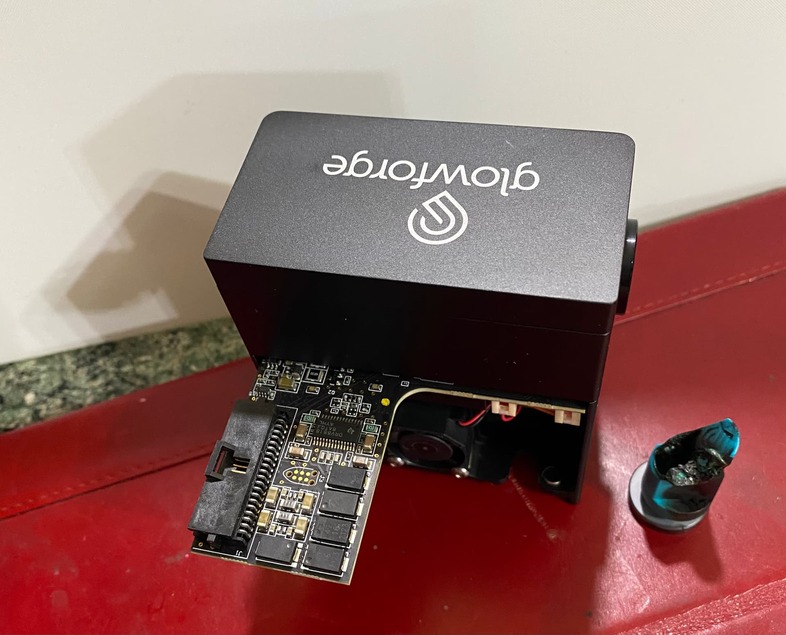

UPDATE This is why the machine is not working. I was inspecting the laser head and discovered this. The mirror was turned upside down.
This is beyond bad. This is scary dangerous!!
The laser coming in from the left side of the head melted the plastic on the mirror instead of hitting the mirror… since it was upside down.

Here is a picture of the laser head that held the upside down mirror. It is brand new
Glowforge 3 is still hear ready to be shipped. Eric came home from lunch at took the printer head off from Glowforge 3. I then connected it to Glowforge 4.
I could not do the printer head calibration that is required. Message appeared that read “offline”. It was not offline.

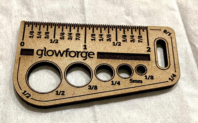

I decided to just go ahead and try printing the gift good measure Printed the Gift of Good.
Measure. Absolutely perfect.
Ouch. Even worse then.
So you’re up and running then good to hear. Looks like the factory that produces these machines needs a little more quality assurance.
I do not know how support is going to handle that I am keeping the printer head from Glowforge 3 and returning Glowforge 3 with the printer head from Glowforge 4.

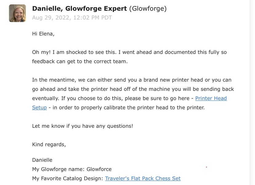

Support is great. They are letting me keep the laser head from Glowforge 3 .
When I receive my shipping label from Glowforge I will ship out Glowforge 3 with printer head 4.

Here is the letter from support.
