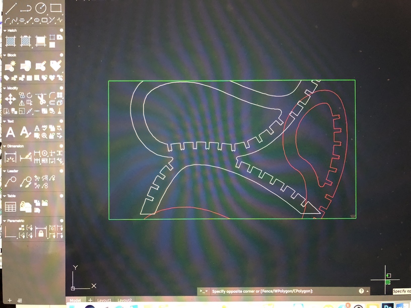

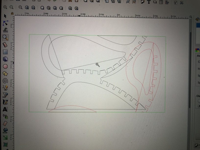

Hi I’ve made a file to cutout on the forge in AutoCAD and as advised am opening it and saving it on Inkscape as I always do… however there’s lines appearing from nowhere on this one.
Does anyone know why these appear and how to sort it out without having to redraw the whole thing?
I think you see issues like that when there is an open shape and the software attempts to close it.
Keyboard shortcut in Inkscape Control+5 will put the view in outline mode, and you can zoom way in to see if that’s the case.

Yeah that is the case… unfortunately control plus 5 hasn’t worked. Il send the file if I have no outcome soon. :+1:
Edit: is there anything I could do in AutoCAD to resolve the issue?
If you can turn on nodes and look at the paths, I think you will see open paths on the top and bottom edges.
Otherwise, you are looking for a function along the line of ‘Close Paths’

Yeah I checked for nodes but there are none open. Not sure how to deal with closed paths.

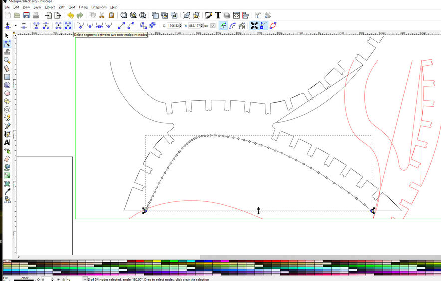

In inkscape you need to go in line edit mode select and break the straight line thus
and In edit you can make the design fit the page and eventually get this, That you can DL as an SVG

I’ve basically made that rectangle in AutoCAD to fit the gf.

Just noticed there is one other problem though… after opening up in Inkscape the layout seems to have changed…

The first image is from AutoCAD as that’s the one I know how to use unfortunately when I got the gf I couldn’t save and open the dwg or dxf file in gf so I was recommended to open and save as svg file in Inkscape however it’s chnaging the file. I’m working in mm in AutoCAD.
I’m afraid you have more than one issue with the file…there are quite a few places in it where what looks like open ended single line paths have been closed into shapes that are going to burn twice as the laser follows the path…you can see one of them here if you zoom in:
Here’s the problem that you’ll run into trying to repair the file. The issue with exporting DXF files from some of the CAD programs is that the lines come across as unconnected short segments, and depending on which program you pull them into to fix them, you can get different results. It looks like Inkscape is closing the open paths, and not necessarily in the way that you want them closed. It’s a recognized problem in dealing with some of the CAD files.

Thanks for your reply… the double lines you mentioned are also shapes being automatically closed by Inkscape which has been solved by deleting segment between 2 non endpoint nodes as rbtdanforth explained but when I open the AutoCAD file it changes layout. As for setting up the page… I’m only opening and resolving the file to be opened in gf. …Unless I have lines to delete.:smirk:
