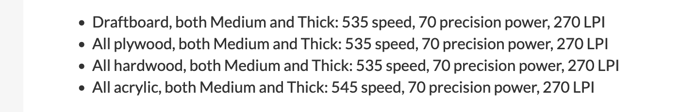

Until we figure out what’s up, you can put in the setting manually. This was the SD Graphic preset for most medium and thick plywoods and acrylics: 1000 speed, full power, 270 LPI

Sometime in 2020 the SD engrave settings were changed for some Proofgrade materials. I don’t remember if acrylic was one of them. If you have the premium subscription you can open a past print and see your settings just to check that they were 1000/full/270.

I know it is not convenient, but don’t stress out. You can set them manually until they return. With premium, just choose past prints and you should be able to see what settings were used for a particular job. If you don’t have premium, start with the ones @dklgood suggested above; 1000/full/270
From what I am reading in the discord, this is happening across the board. I have used the settings from @dklgood and it’s working great!

Hi everyone - The SD Graphic Proofgrade preset is back in the Settings menu (we just made the update, so it may take 24 hours for everyone to see it). We appreciate you letting us know. Thank you!
