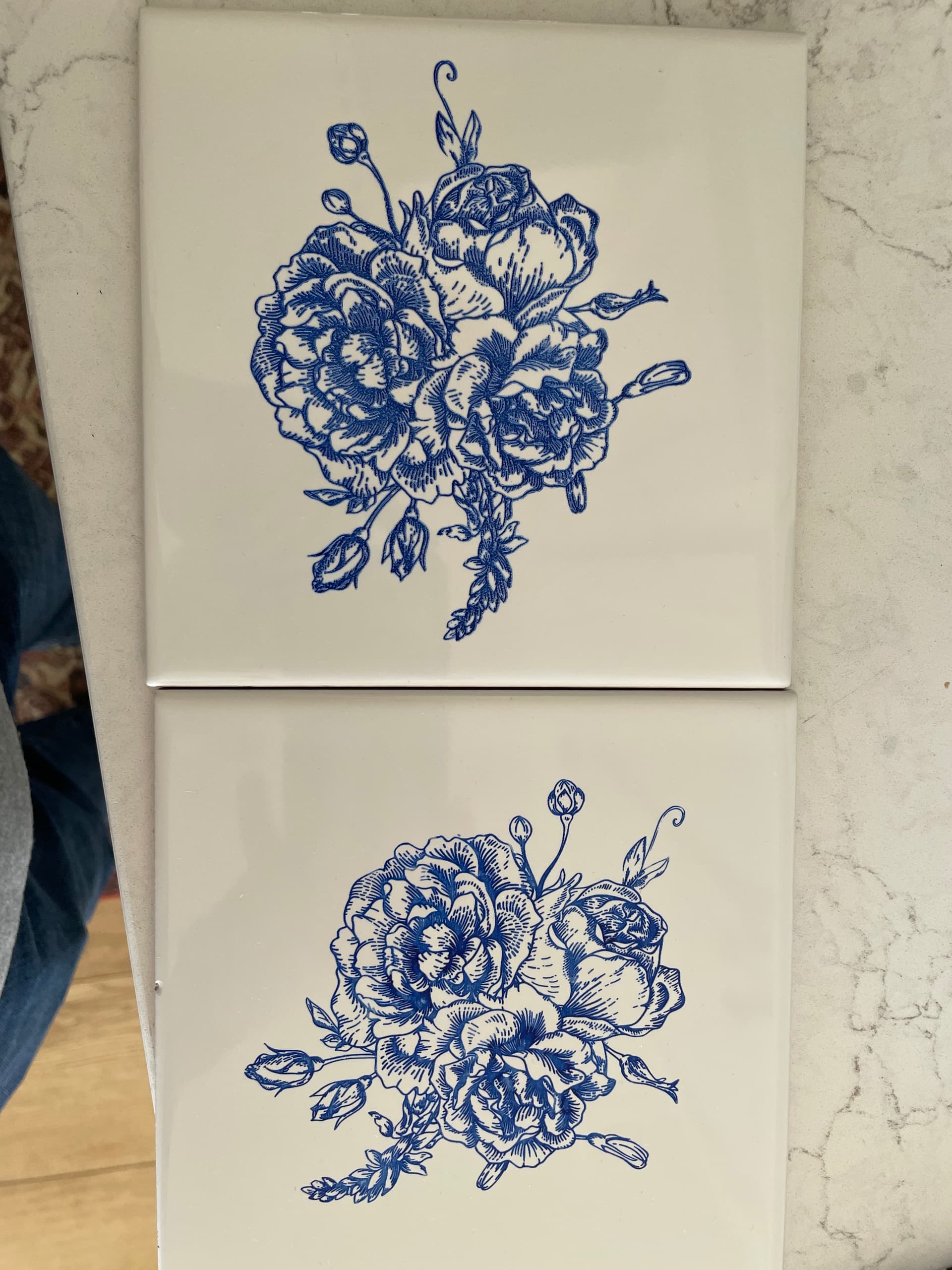

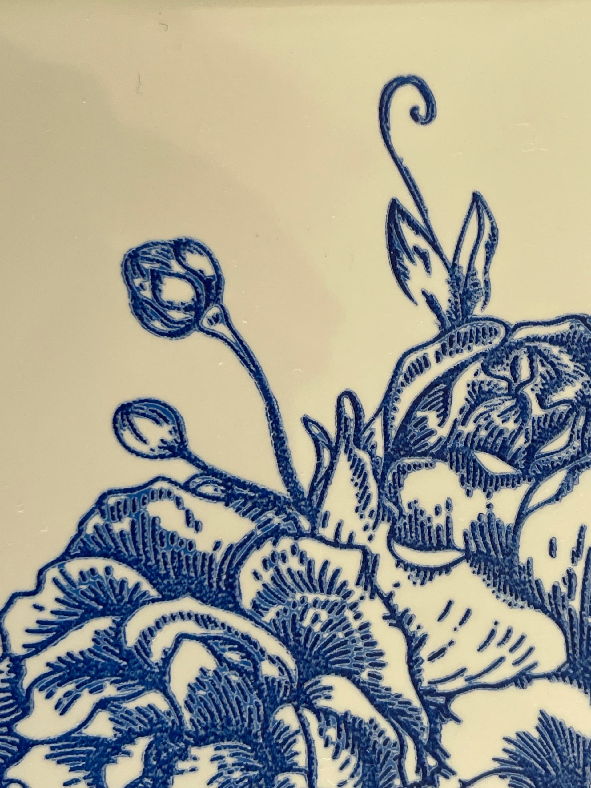

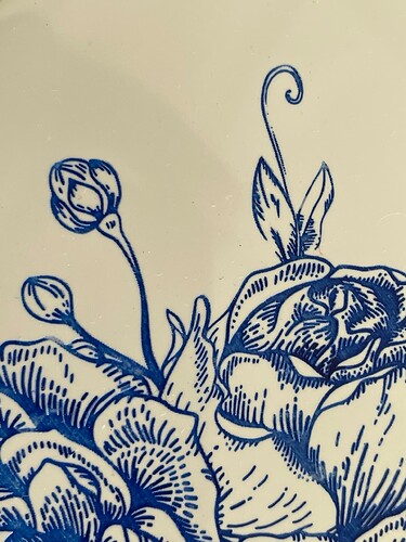

A year or more ago I engraved on tile for my brother. He came back and asked for me to do it again, so I used the “Ceramic Tile” setting that I had saved, assuming it would be the same. But the result was fuzzier. The lines not nearly as clear. I’ve played with different speeds to no avail. An autofocus did make it more crisp, but still not as crisp as the original. Any ideas of what else I could do?

Unfortunately, I don’t remember the previous settings. It was a long time ago. We did some playing today and discovered that slowing down the speed did help. Then turning down the power helped more. It’s still not as sharp, but it’s closer.
What you are doing is heat shocking the tile glaze so it “explodes” as the laser goes by. I would think therefore that faster would work better than decreasing power as the heat would have less time to widen the line.
