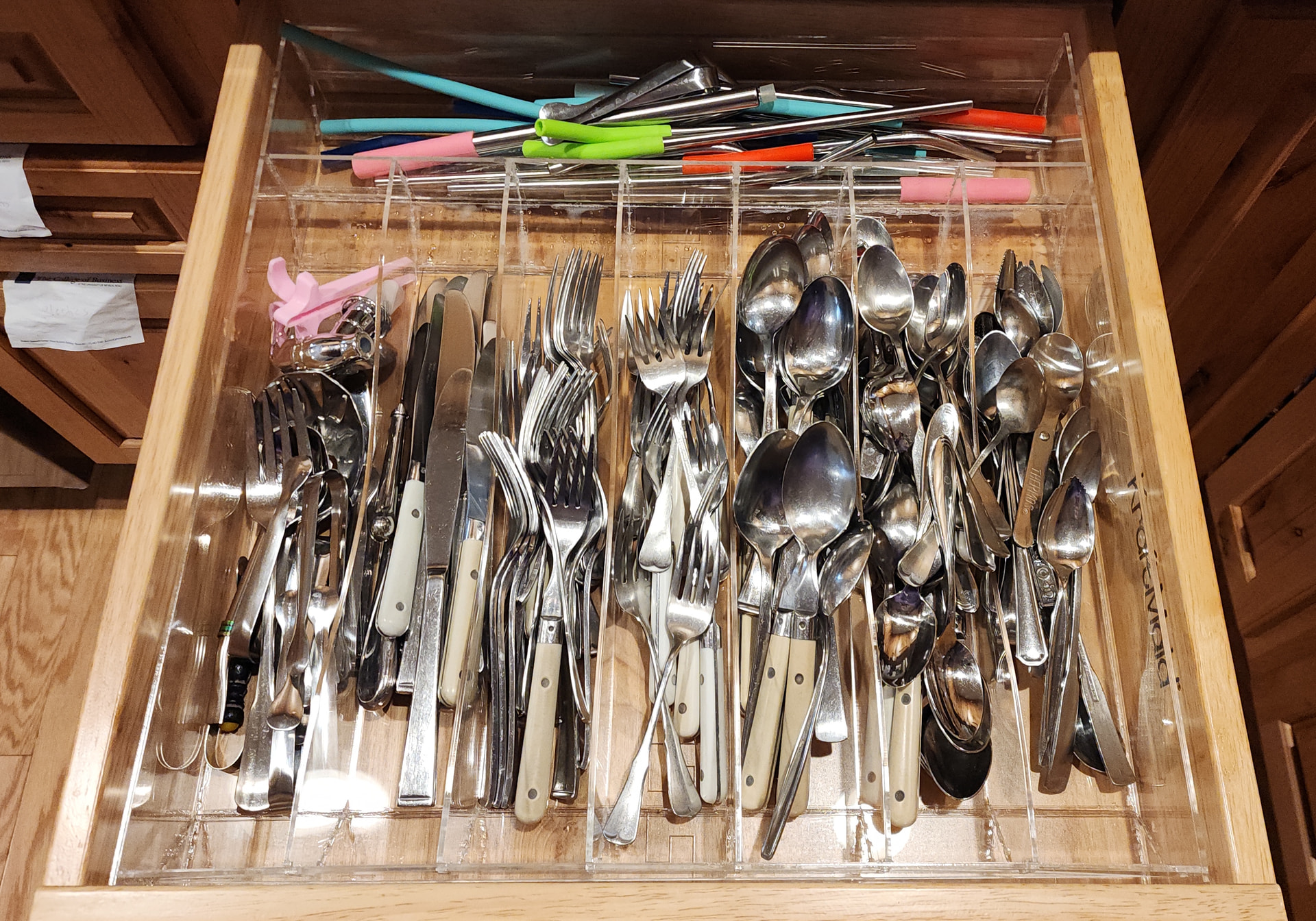

Silverware Drawer
My sister moved into a new house and was using cardboard boxes to separate her silverware. As she was now walking distance from me I offered to make her a better one.
The lesson I learned is - use a silverware drawer generators, it’s not worth designing from scratch!!
It’s ab fab in the end, a little hard to photograph being clear acrylic, but check it out :slight_smile:
That’s a fantastic insert! Might have to look at doing one of those for my misses as well!

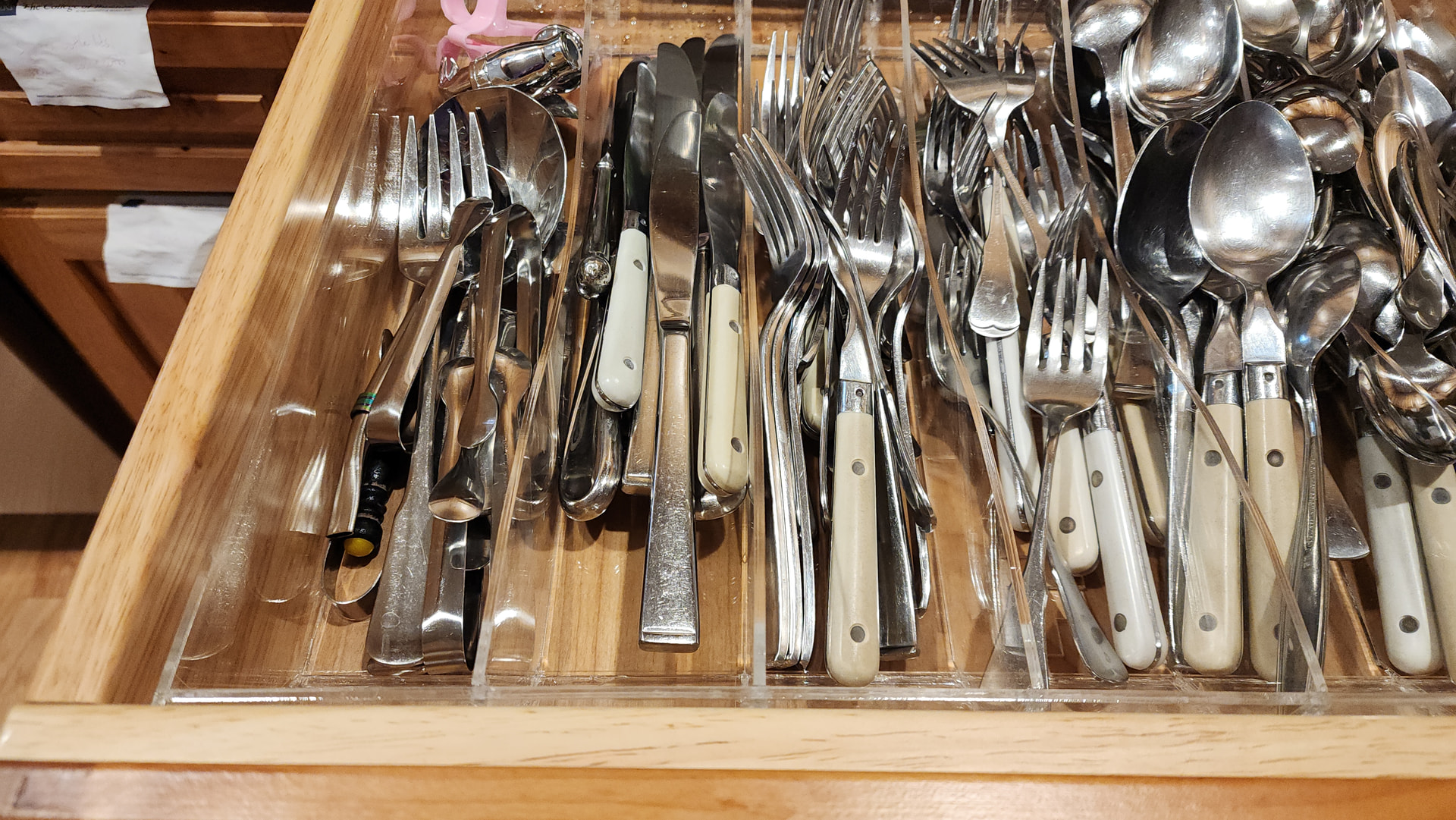

How’d you assemble it? Glue?

It’s finger jointed, and then yes, acrylic cement. It’s very solid despite the size!

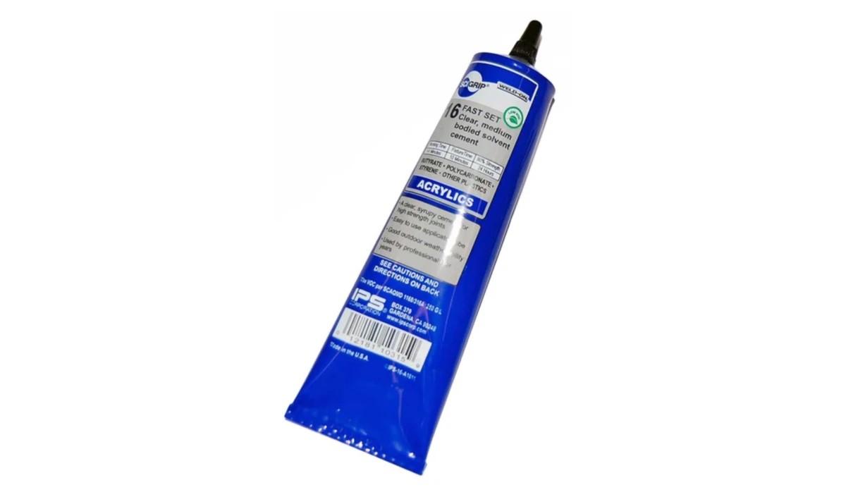

What brand name glue?
Thanks!
Weld-on in the tube (so it’s a gel rather than water consistency)
