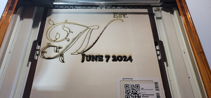

So many misprints on my Aura/eta on bug fix?
I’m not sure what to do. I’ve deep cleaned, calibrated, set focus, made sure my ribbon wasn’t catching, used different types of files, Proofgrade materials, non-proofgrade materials… I’m losing money on materials and orders. Does anyone know when they are going to fix this issue? I can’t keep my business afloat if I continue losing money becau
se I can’t make anything.

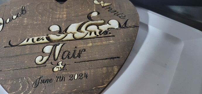

I am having the same issue where any prints that take more than 5 minutes the cuts are off and even those are hit or miss sometimes. The engraving will be great and then the cut will be up to 1/4” off and further off on each pass out of alignment. Even with the new update it’s still not cutting properly. I can’t very well clean the rails in the middle of a print. It’s not dirty rails. It also happens on proofgrade materials and on other materials.
Sorry that doesn’t really help you but know you’re not the only one who is frustrated.
