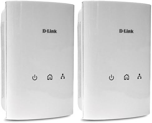

if youre on the same power lines, you can use a ethernet over power, and hook an access point up to it. I use this method in my bedroom at the house, and even play xbox games over it. works great. this is what I use:
You can also get something like this, which basically has the access point built in!
Powerline adapters are amazing when they work, but in my experience this is very hit or miss with your houses age being a major factor. They are pretty cheap though, so worth a shot.
