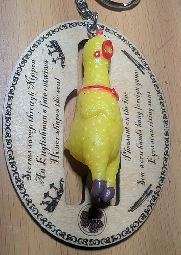

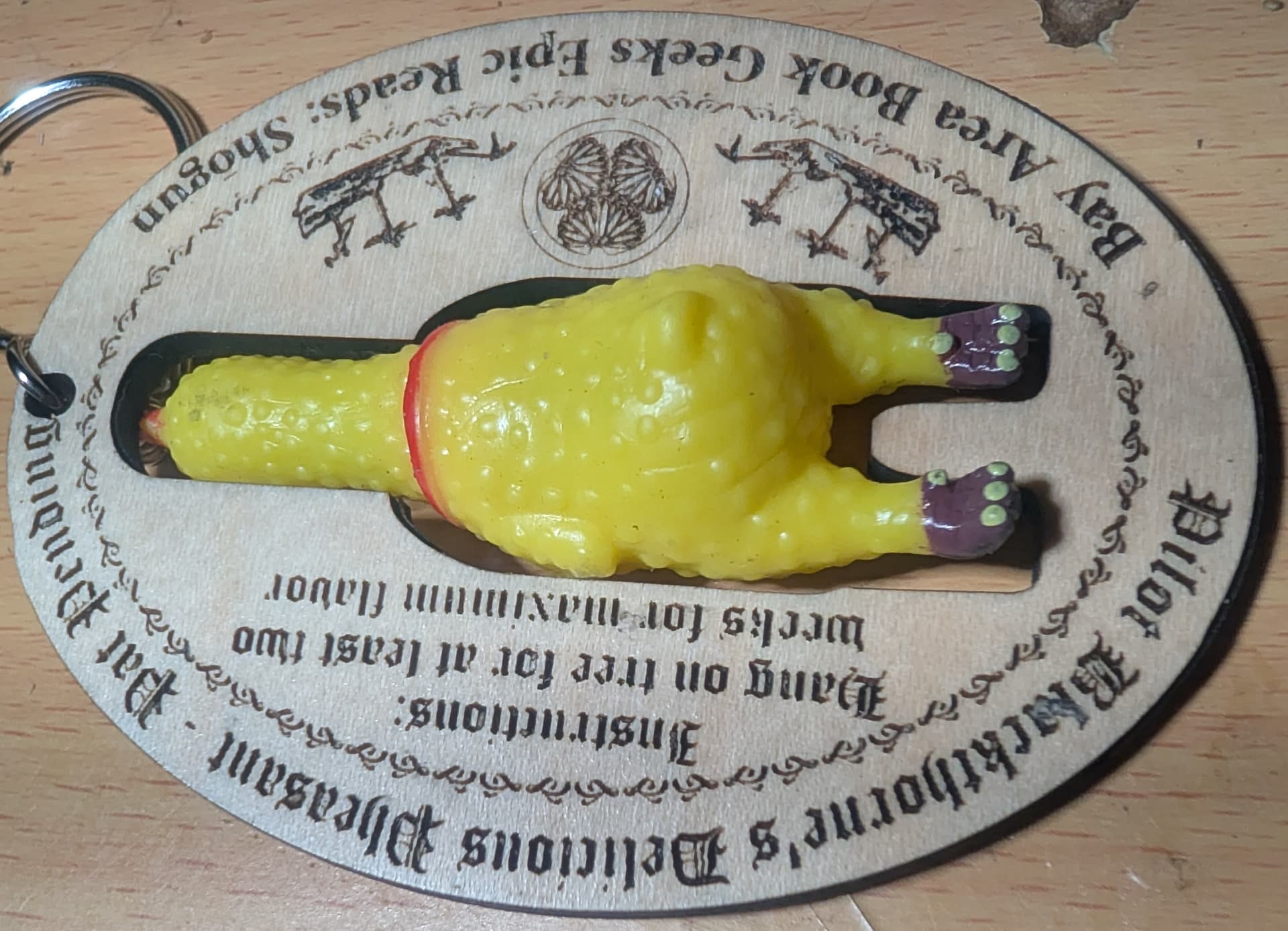

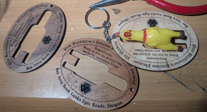

So I got a set of these then added a wooden surround I designed to make the rubber chicken into a rubber pheasant. I also called on chatgpt to write me a few haiku with shogun as the theme and it did a better job that I could have done but presumable a terrible job by real poet standards.

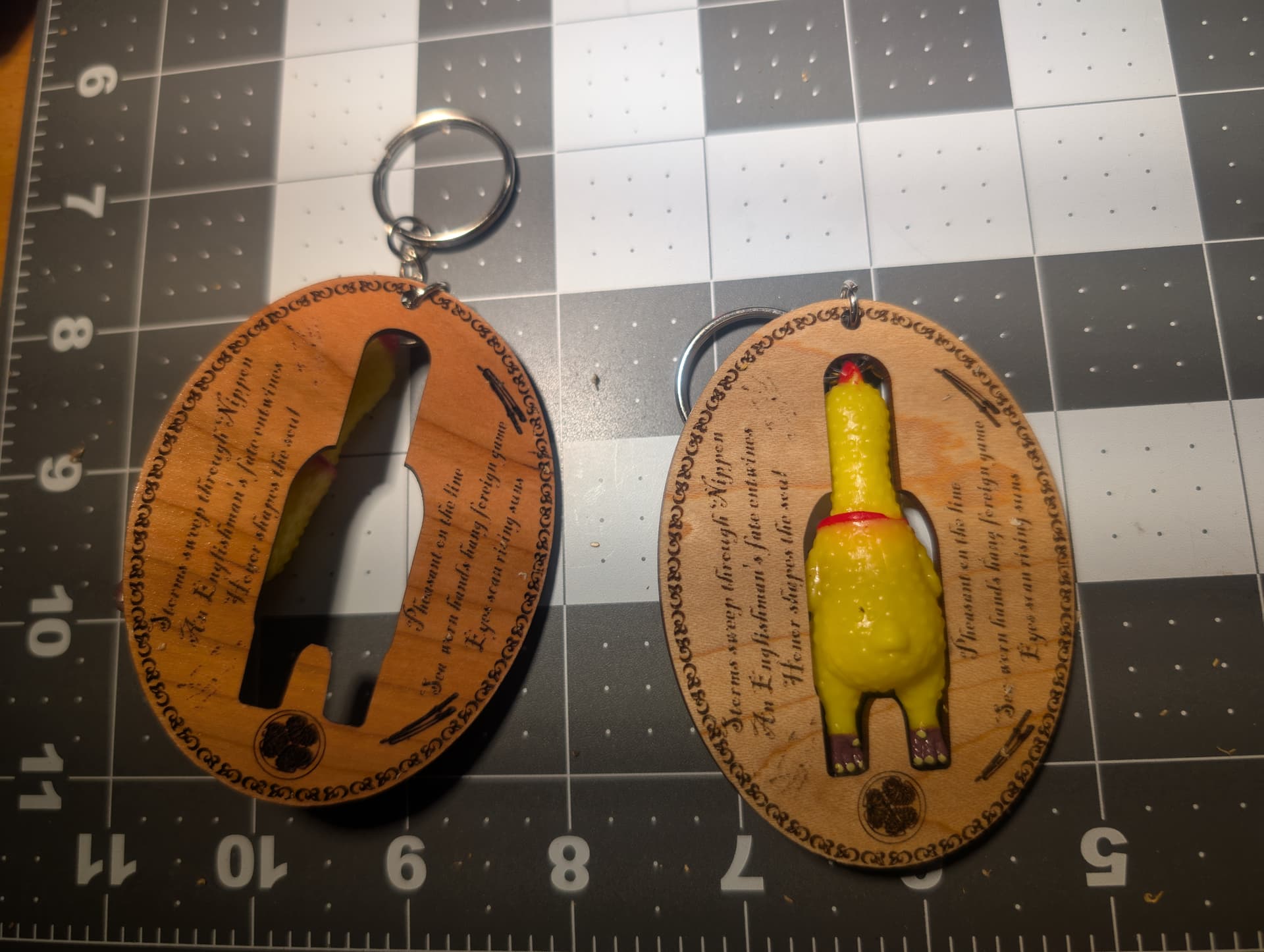

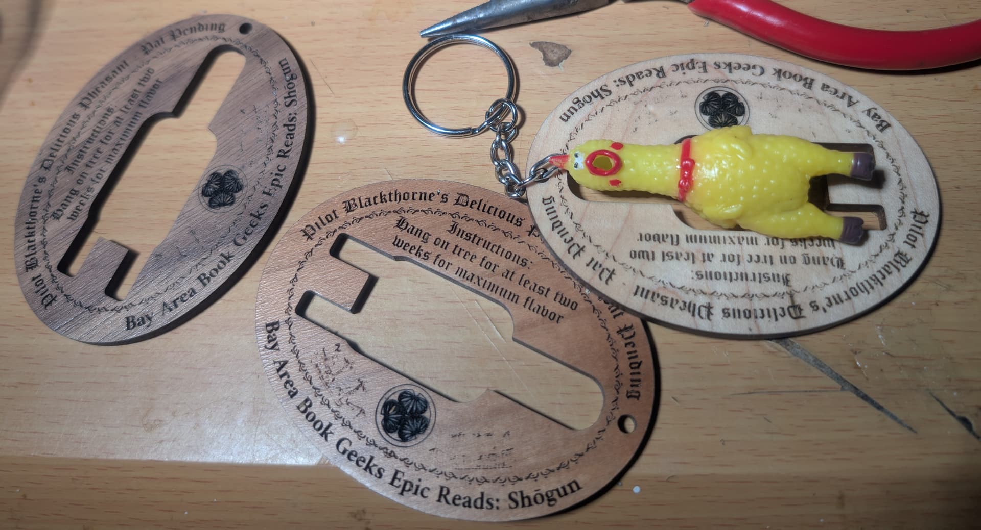

These are my prototype versions trying out the different hardwoods I had and checking the settings etc. You can see there is what was meant to be a ship but it didn’t etch correctly I did fix this later and then broke it again somehow so half the finished versions don’t have the ship, I ran out of time to fix it.
The flower like symbol is the crest of the Tokugawa clan which became the symbol of the shogunate as used by the real historical person that Toranaga is based on (Tokugawa Ieyasu).
I like the maple and cherry versions the walnut felt a little too dark given the size of the text perhaps if I filled the etch of the text with some lighter colour paint or epoxy it would have worked but I didn’t really have time to do that.
I did my usual technique of securing the wood with magnets and tape then cutting side one then using the remaining wood as a jig by carefully going in and then flipping all the pieces in place. Then I made a duplicate of the first pass to align the otherside and get everything nicely in place.

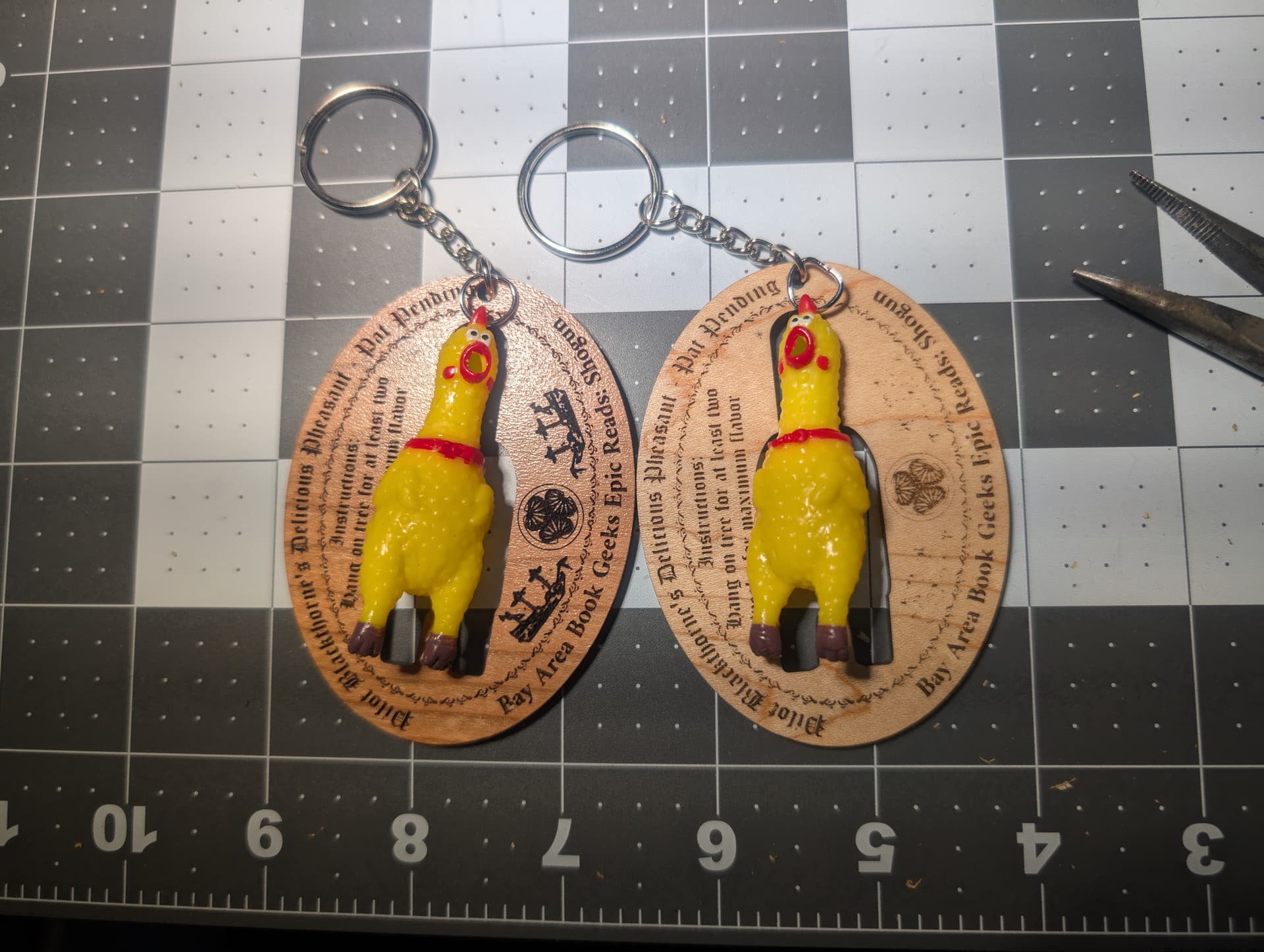

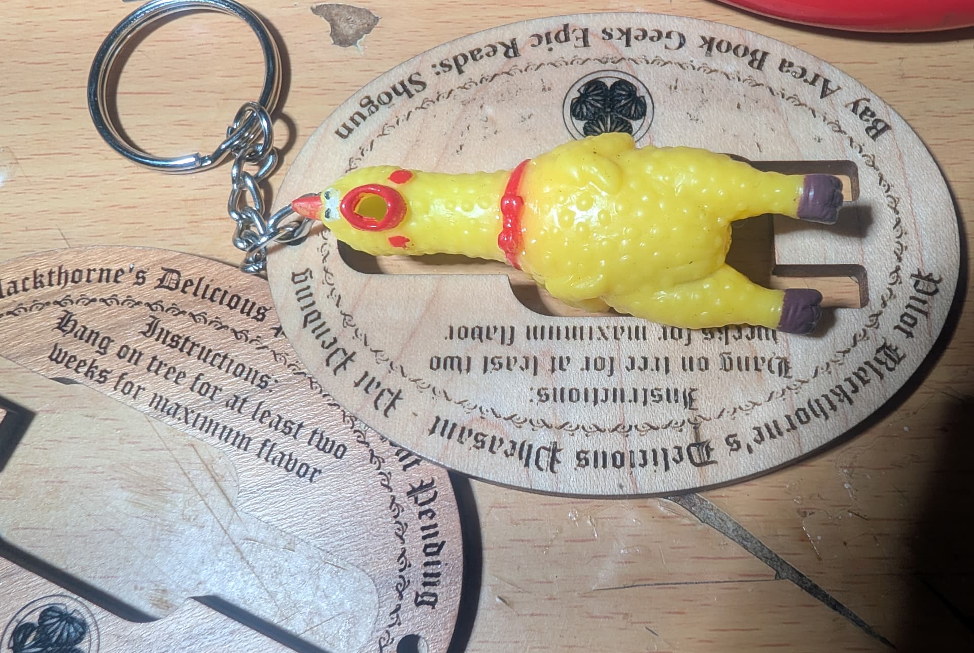

These are the finished versions as you can see the maple one lost the ships for some reason.
We had our celebration at the weekend and people seemed to enjoy these little mementos
the fact that the “pheasant” squeaks is a nice bonus :smiley:

It’s a little strange that the ships are lost on some proofgrade, but it happens. I remember proofgrade basswood losing details that showed up fine on cherry or walnut, like it just couldn’t burn through the finish.

Solid technique. For projects like this where you’re following an outline with a border even a standard pocket jig like you’re talking about might not be accurate enough due to kerf.
