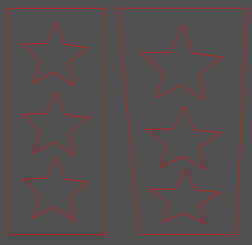

I need to be able to change the ‘taper’ on a drawing in inkscape, but can’t find a method in the program.
I’ve attached a rough idea of the problem.

It’s necessary that all the contents of the bounding box are given the same change of perspective.

It’s to enable me to change the ‘angle’ of a design within one fan section, so that I can change opening angle of a fan.
If the design is laid out with a taper, lets say, of 5 degrees, I want to change that to 5.5 degrees.
This would change a 24 section fan from 120 degrees to 132 degrees.
Conversely, I could change the number of sections, and keep the overall opening angle the same.

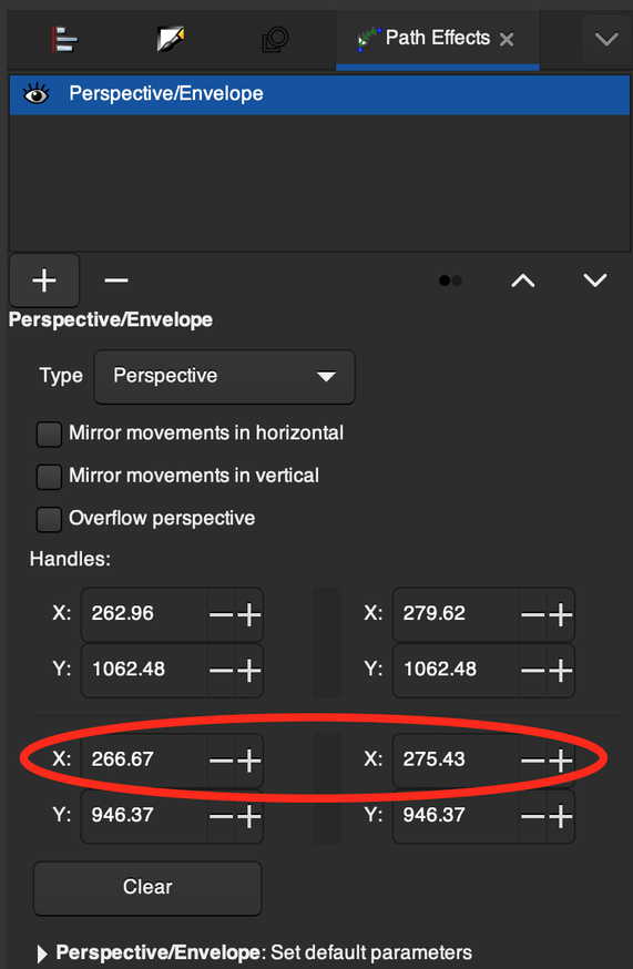

I used Path/Path Effects and add the Perspective/Envelope effect, then adjust the handles.

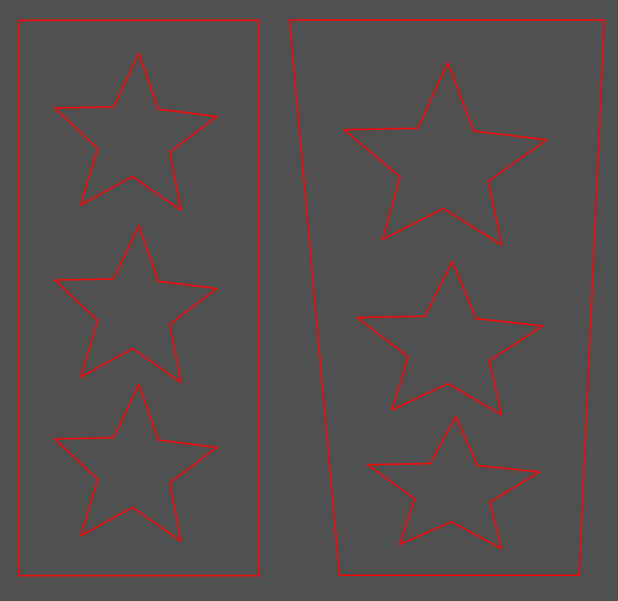

perspective_test
This is the real problem - change the drawing on the left into the shape on the right!

Same process. Apply Perspective/Envelope path effect, then just adjust the handles - the bottom corners are the lower X/Y pair…

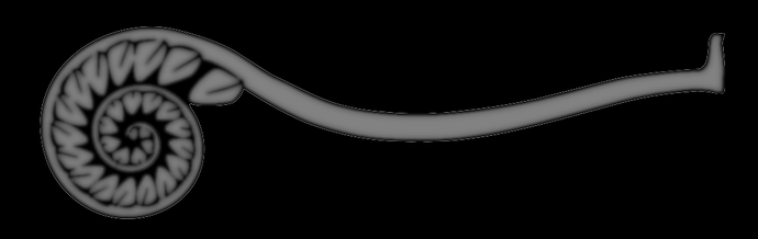

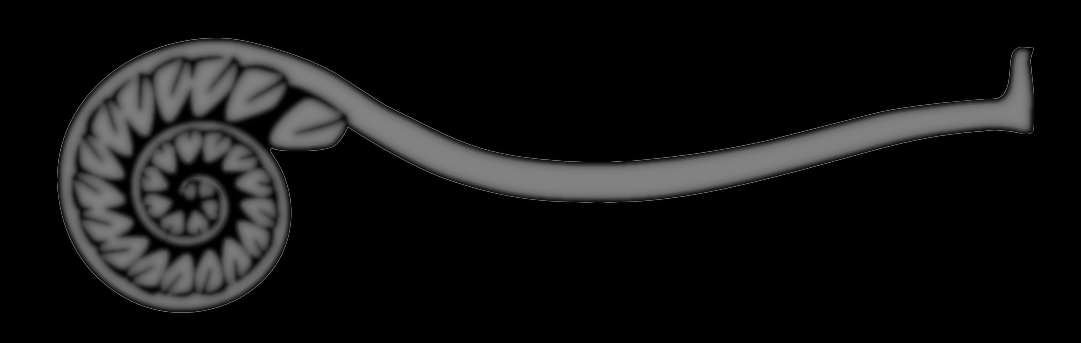

I have had that issue from many perspectives. One I had a series of leaves that I wanted to taper in a spiral. You can place a large leaf at one end of the distance and a small leaf at the other and say that you want 8 steps and by three or so kinds of taper it will provide all the 'tween points. By replacing a spiral with the result I had a spiral of leaves going from big to small…
In a different situation, I used two rows of 5 points to get a more hourglass look in what had been a straight pattern so you are not limited to just 4.
