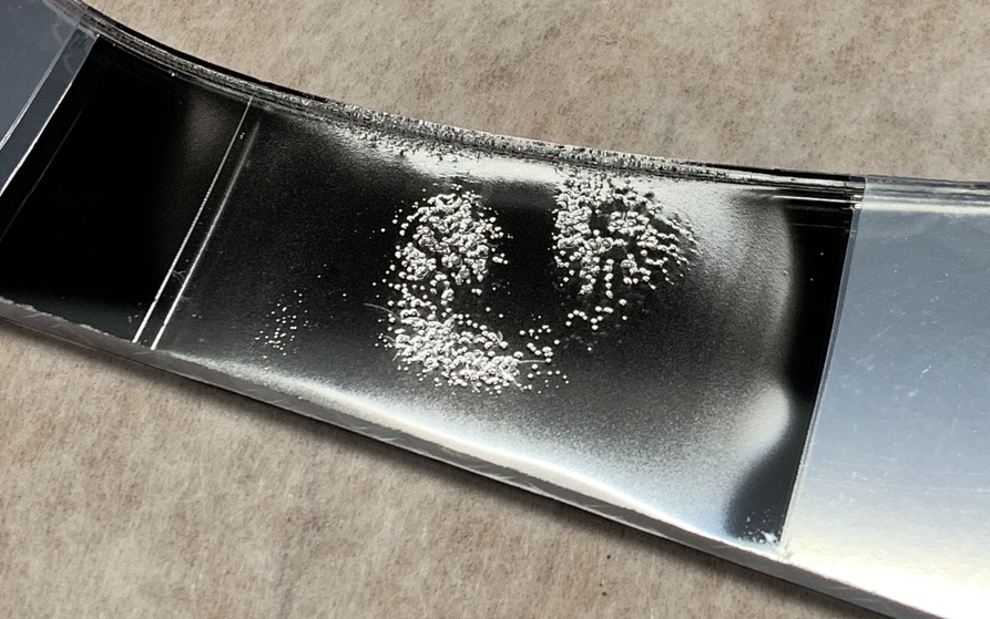

Does anyone know why this is happening to my mirror acrylic? It looks like scratches but they are on the inside, not on the surface.

It is called crazing and has been discussed quite a bit here in the forum. You can search “crazing” and get an idea of what people have done to limit it. Did you cut shiny side up or down? What settings did you use? I have had pretty good luck with 1/8" mirror acrylic cutting shiny side up without the plastic masking some suppliers have on their material using Proofgrade acrylic settings.
Thank you! I never would have thought up the word “crazing” to research it lol. I did cut shiny side up but I put a blue tape for masking over it & used proofgrade acrylic settings
That doesn’t look like crazing to me. It might be flashback, but that’s not consistent with flashback symptoms exactly either. You can see evidence of flashback alone the edges (the regularly spaced “pits” in the edges are consistent with flashback), but the damage to the mirror on the rear looks different, almost like a defect in the acrylic. Have you peeled the masking off on a small portion to verify that the acrylic looks ok to start?
Crazing looks more like hazy areas that are filled with small cracks. Did you try to clean the acrylic after you cut it? Crazing can be caused by using the incorrect cleaning regimen.
There was a thread recently about avoiding flashback in acrylic by raising your material off the bed, I don’t have it handy, I’ll go look.

I peeled off the “seran wrap” type covering that came in the front of the acrylic & replaced with a blue tape (like a painters tape) for a mask & there is nothing on the back. I cut shiny side up, not from the back
And after you peeled the saran wrap off, did the mirror look ok?
@JessicaLee, if the defects are inside the acrylic and located away from your cuts, then I’m wondering if you simply got a bogus sheet of acrylic. Some of the marks appear to be biased towards the mirrored side, which could mean there may have been some debris present when the mirror finish was applied.
I’ve also observed the mirror finish delaminated by the incoming laser (mirrored side up), which is vaguely similar to some of the marks on your sample:
I haven’t devised a solution to the laser-induced delamination yet - perhaps cut in two, lower power passes

Yeah might be a weird flashback or some sort of delaminating, though if it’s delaminating I would expect it to be concentrated next to the cut lines.

I think it’s stress relief cracking. The acrylic wasn’t annealed and the cuts released random stresses in the plastic - it’s exacerbated by the mirror coating.

If it is stress cracking, would you see that only in the surface mirror material? If you zoom in, the damage seems very superficial, it doesn’t appear to travel through the acrylic. I’m still thinking this is a surface damage caused by either the laser with some weird flashback, or by physical damage from contact with thesharp metal edges of the honeycomb.
I had some scrap mirrored acrylic and a blowtorch, so…
Just lightly sweeping the flame over mirrored back insta-created a haze in the finish, and a slightly slower sweep of the flame started blistering. Still doesn’t look exactly like what @JessicaLee posted however.
Heat seems to be the enemy of that mirrored coating. Not surprising, but a stark contrast to how well-behaved acrylic can be on its own.
I haven’t tried cutting shiny side down as @evansd2 describes, but I imagine protecting the mirrored surface with tape would be essential. Just speculating, but perhaps a paper-based protective coating might be a better thermal barrier than the plastic coating the mirrored acrylic ships with…
I’ve had this happen and it seems to be the reflective coating heating up where it’s touching the acrylic. It seems some colors do it worse than other, but I could be wrong though and it’s really jut a WAG. I have really good sucess using these setting/method with mirrored acrylic on my Basic. Acrylic doesn’t vary much in structure and it all cuts generally the same so maybe run a little test cut to see if the crazing (or whatever it is) still happens?

Crazing tends to be more localized to the causal agent (like chemicals, alcohol, etc) exposure. Stress relief cracking is usually pretty random following strain patterns in the plastic. You can see the strain lines visually with polarizing lenses or filters.
This is an odd material because it’s not homogenous - the mirroring is applied to the acrylic substrate so one, either or both could have weird strain patterns in the plastic.
