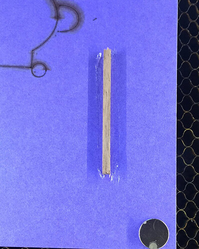

Haha–should have seen this before I did it. For my first attempt the piece shifted while being cut due to the air assist.
I didn’t have a dowel but I did have a piece of 1/8" square walnut rod. Here’s the Before (stuck down to the paper this time):

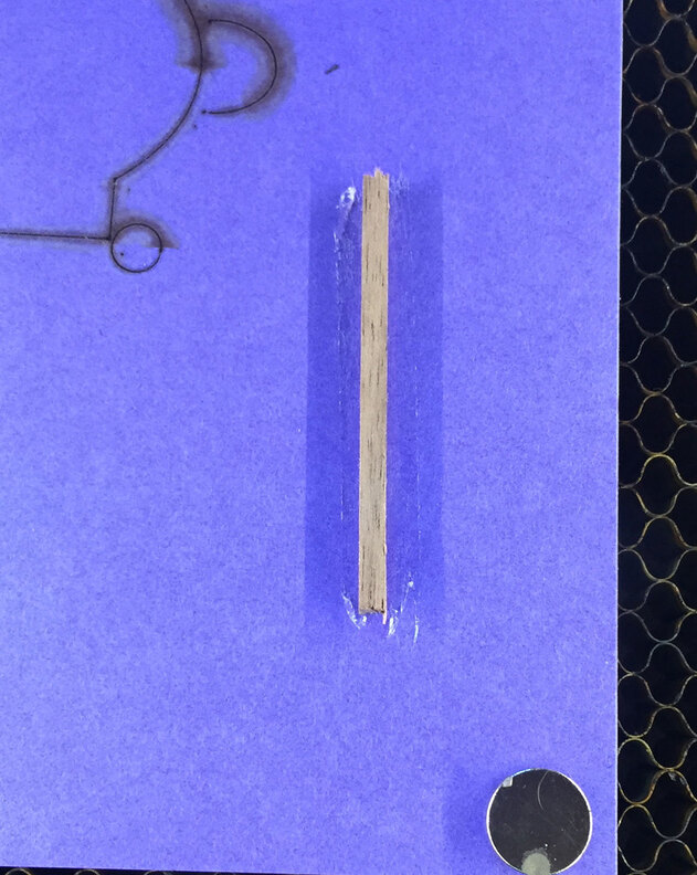

After (didn’t get it centered very well, you’d want to use a jig):

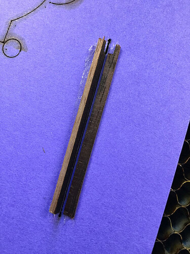

Here’s the split piece:
It seems like 1/8" is very doable as long as the rod has no bends in it. Probably you could go smaller.
