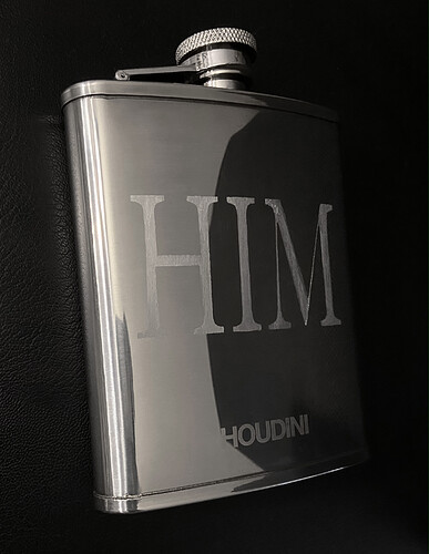

It’s possible but you’d have to void your warranty and cut a whole at the bottom of your machine. I did mine after the warranty expired. Then you’d have to use marking spray or use a coated tumbler. Another way is stenciling by using the glowforge to cut out stencil, taping it on the metal and using a hand tool to engrave the design (as shown on the flask)
