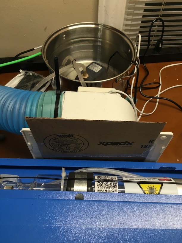

The laser comes with the laser unit, a water pump, and a fan. The water pump is submersible, and I had a pot sitting around I use for vaporizing acetone to smooth 3d prints, so that will do for now. This feels incredibly unsafe and destined to have issues. A lot of people put these on the floor just in case. For tonight its here so I can get all the air bubbles out.
Next is the fan. If you look in the picture above you can see a thin slot and some mounting brackets for the fan. It is WAY taller than this slot, and the mounting pieces on the fan are much thinner than the allotted space. Luckily I had some HDMI end covers sitting around that were the right size to take up the slack. I covered the open part in the top with some cardboard (cant say I dont have some to spare haha!). It moves some air, but feels really ineffective when inside the unit. Either way, its attached and doing its best.

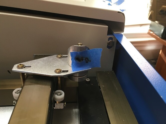

Next up is the alignment of the beam. So many things to take into account here. There are 2 mirrors with 3 adjustment knobs on each. You have to move the carriage around and test reflection from each one in the proper sequence to make sure you are getting a perfectly aligned beam. Unless the carriage is bent and unsquare which im starting to think is the case with mine after all that shipping.
In order to tell if a mirror is aligned properly, you block off the next mirror down the chain with a piece of tape or cardboard or anything you can see that will get a burn mark from the laser. You then move the carriage to each corner of the bed to see if the marks land on top of each other. If they do great, if they dont, well… they probably wont.

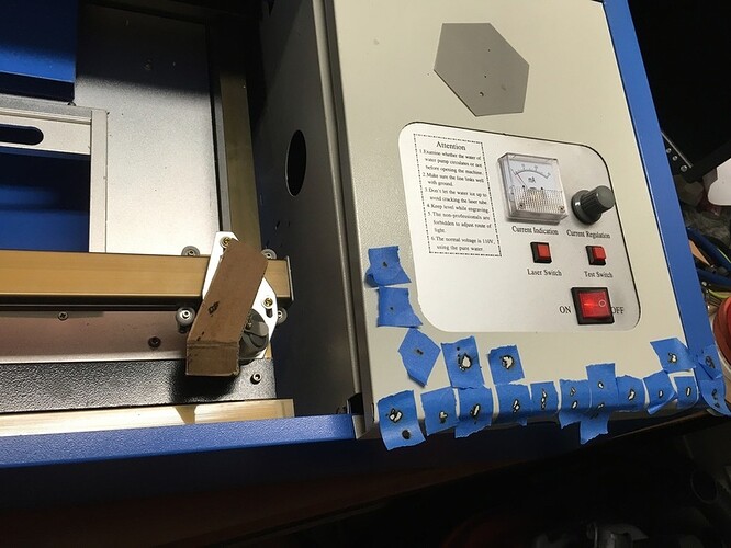

As you can see in the following picture, things arent lining up quite so well out of the box
And after another hour or two of messing around with it, it seems its only out of alignment in the bottom right corner. You can see the remnants of all my attempts! I could make an abstract art piece out of these haha
So after all that it seems im going to have to do a little more investigation into whether that corner is really out of square or not. Everything in this unit wobbles and wiggles, and when you try to move the carriage you can tell that if you moved it back it wont be in the same place it was to begin with. No rigidity here.

Mine was. It was about 1/2" out of square in the lower right. Just grab a speed square and try to tuck it into the corner. You’ll see if it’s out of alignment.
If it is, you’ll need to take the rails out to get it squared. That’s easy enough but for you, first you need to get rid of the bed (I did mine so long ago I don’t remember how many screws or where but it was pretty obvious at the time). Then there are 4 bolts - two on each end that you take out and the whole rail assembly comes out. Make sure you pull the cables for the stepper motors - grab a picture of the connections so you get them in the right place (if one is the flat cable FFP type that won’t be hard - except which direction is up is something you want to make sure you know - a picture helps).
While you have the rail out, take the blue exhaust manifold out. It just gets in the way and it restricts the air exhaust. Again 2 or 3 screws/bolts. Nothing tricky, hard or hard to get to. Throw it away.
To square the rail I needed to jump the belt a tooth or two. No need to mess with the X-axis rail or the head - it’ll just be a question of getting the belt lined up right. There’s a screw & adjusting nut on the far end of the rail. Loosen that and you’ll be able to push the end of the X-axis rail toward the out of square end and feel it jump the belt teeth (the axle on the stepper motor is toothed). Run the rail to the end and measure at both ends of the X-rail to get it right. It’s easier to jump a tooth towards the front of the machine than toward the back so take it a tooth or two at a time. When you get it right, tighten up the screw on the end, making sure you have the same slack in the belt as is on the left side.
Re-assemble and re-align the mirrors.

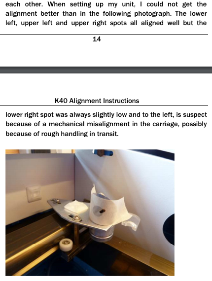

I saw that yesterday, and found this part funny, but spot on:
I checked for square right after pulling it out from the box, but EVERYTHING was out of square. The bed wasnt anywhere close to square with the casing, but I figured there might be a chance the bed was square with itself. It seems thats not the case. Ill take it apart some night this week when I have a chance.
Looking at that picture - loosening the ring nut on the head and turning it counter clockwise would get that centered on the mirror. Then it’s tiny adjustment time with the moving mirror to get the two spots overlaying each other.

oh thats a photo from the document, not mine. Mine are all aligned except in the bottom right corner because the chassis is bent a bit.

Mine was off in the lower right as well but I just had to jump the belt on the right side a few notches. There’s a screw on the upper right rail you can loosen and then manually move the belt over the toothed drive wheel. Measure the Xrail on the left & right side and when it’s the same tighten up the snugging screw.
