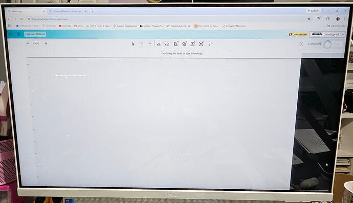

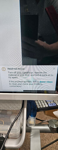

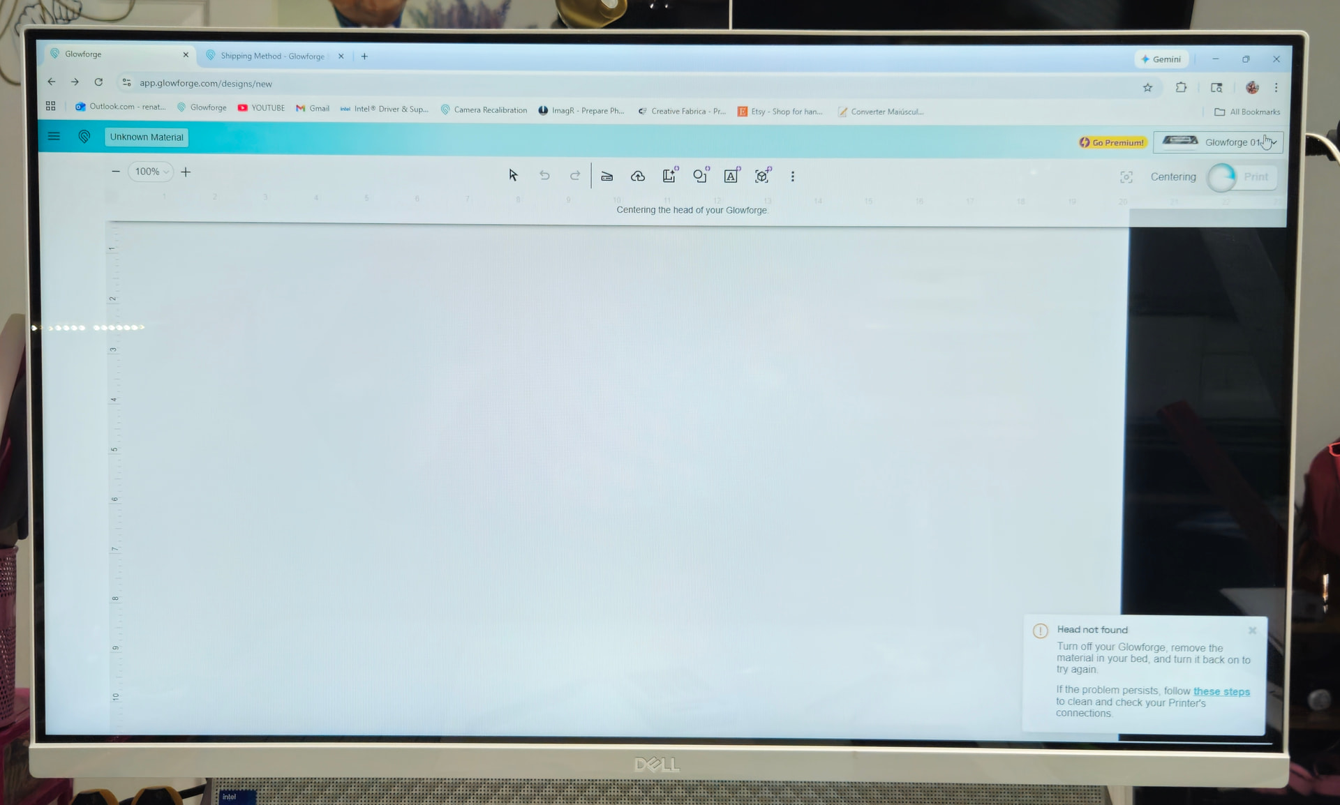

The Glowforge does not show the work screen and does not find the print head. All the cables seem to be properly connected. When I turn on the Glowforge, the printhead doesn’t move at all. I only hear some clicking noises, and the screen displays a message that the machine is focusing. However, nothing else happens, and soon the message appears that the printhead was not found.
I clean the camera and machine it’s extremely clean.
I put on the center camera e head laser and still don’t working at all.
I add some videos a s photos . PLEASE NEED HELP

Just make one cut and when I back start to do this. Homing for a while and then appear the message head don’t found
