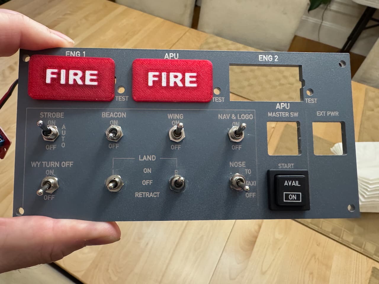

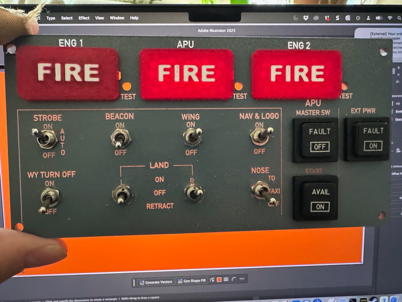

But one thing that super irked me was during the startup (I am sure a real A320 pilot would be horrified at my oversimplification) I have created my own startup checklist for the airbus (a mere 98 steps by simplifying things) but several key steps are on the overhead panel which is less fun to spin and get to in the sim. And that would be a huge build to build a real overhead panel. But I am willing to give up some realism and just create a box with the switches I need (yeah the air conditioning packs can manage themselves), so the key elements are the APU (small turbogenerator in the tail that you use to startup the plane), fire warning and extinguisher panel, and the external light controls. So these panels are complicated to build since they are backlit, and have several types of switches and lights. For backlighting I use 50% translucent white acrylic (the 3mm medium thickness) and you prime then paint the panel (in the correct Airbus blue-gray RAL spray paint) then laser off the paint (very low power setting). It looks amazing. However, you of course learn all the things you never thought about in actually physically mounting the switches etc, so many generations of panels, and now finally I have figured out that the panel needs to be 2 sheets stacked when assembled (only the front has the paint surface the back is purely for mounting switches). The “Kory” switches have 2 colors of LEDs in them and are engraved by a fiber laser (they look and feel amazing) from 737DIYSIM, and while I have built my own from his design, I admit I simply ordered these as is. The fire indicators are red and white PETG printed as a 2 color design on the Prusa XL (on the textured bed, they look amazing in real life and are brighter than they appear in the picture).
First version without any backlighting
Second version simply in front of my laptop with the screen filed with orange. The real version is lit with 240x Orange LED strips and really pops, and I will share once done. The left fire indicator is complete and has the back box with the LEDS (really bright white 240 strip) while the others are just open in the back as need to fix some wiring.

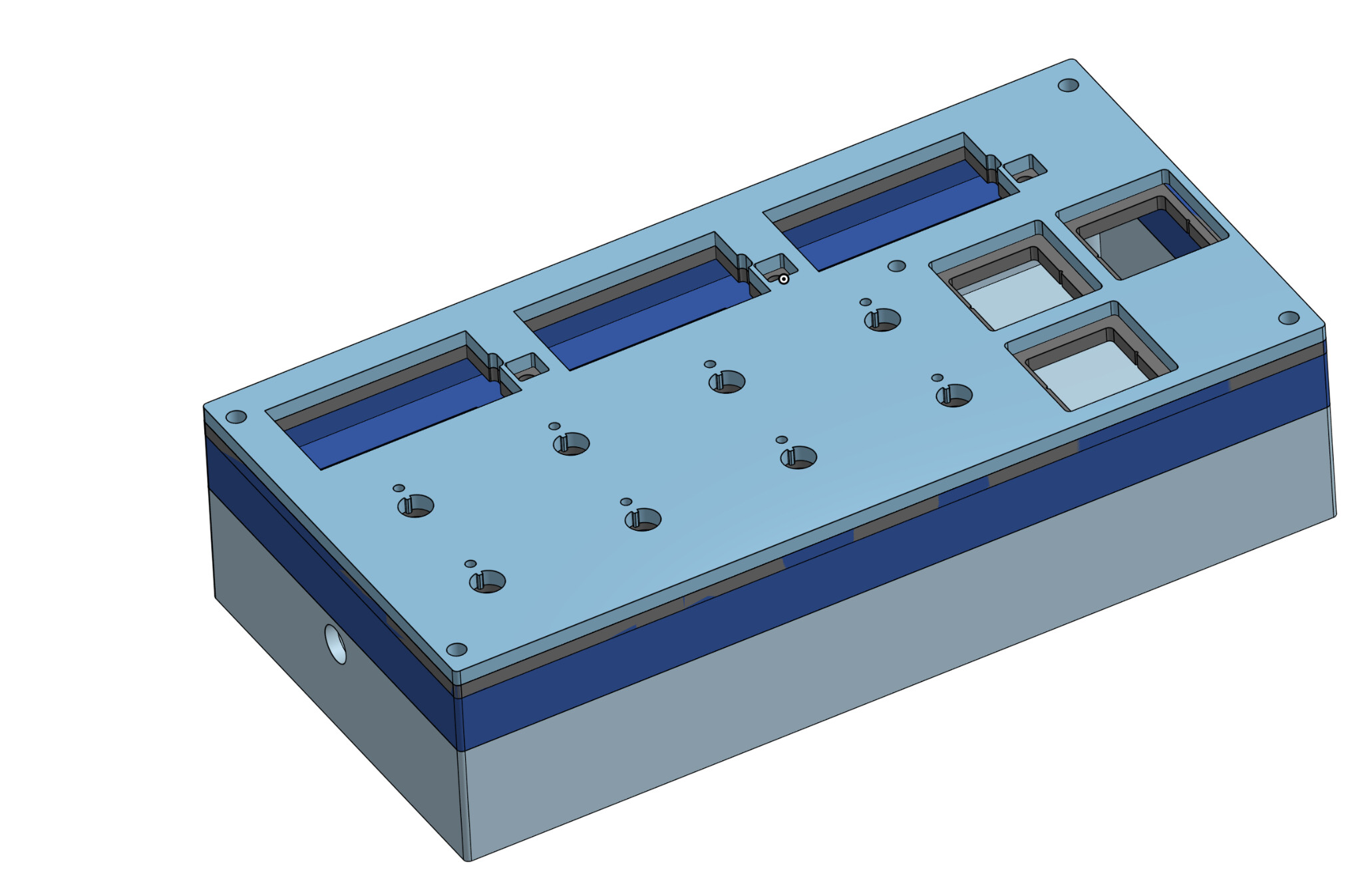

Next version

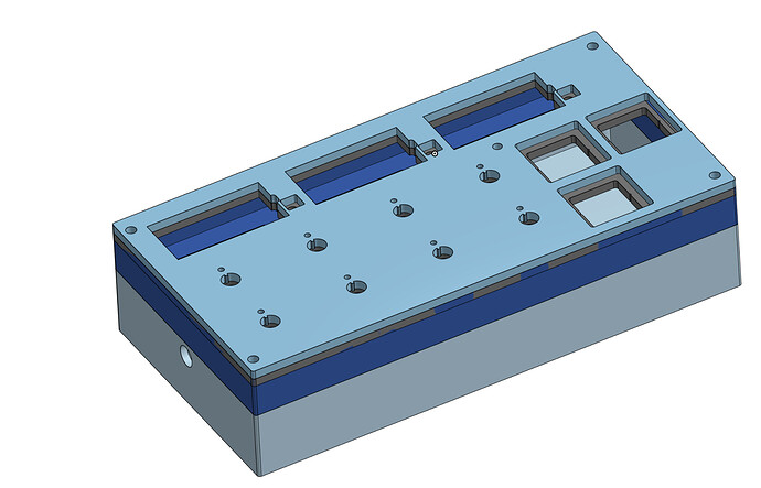

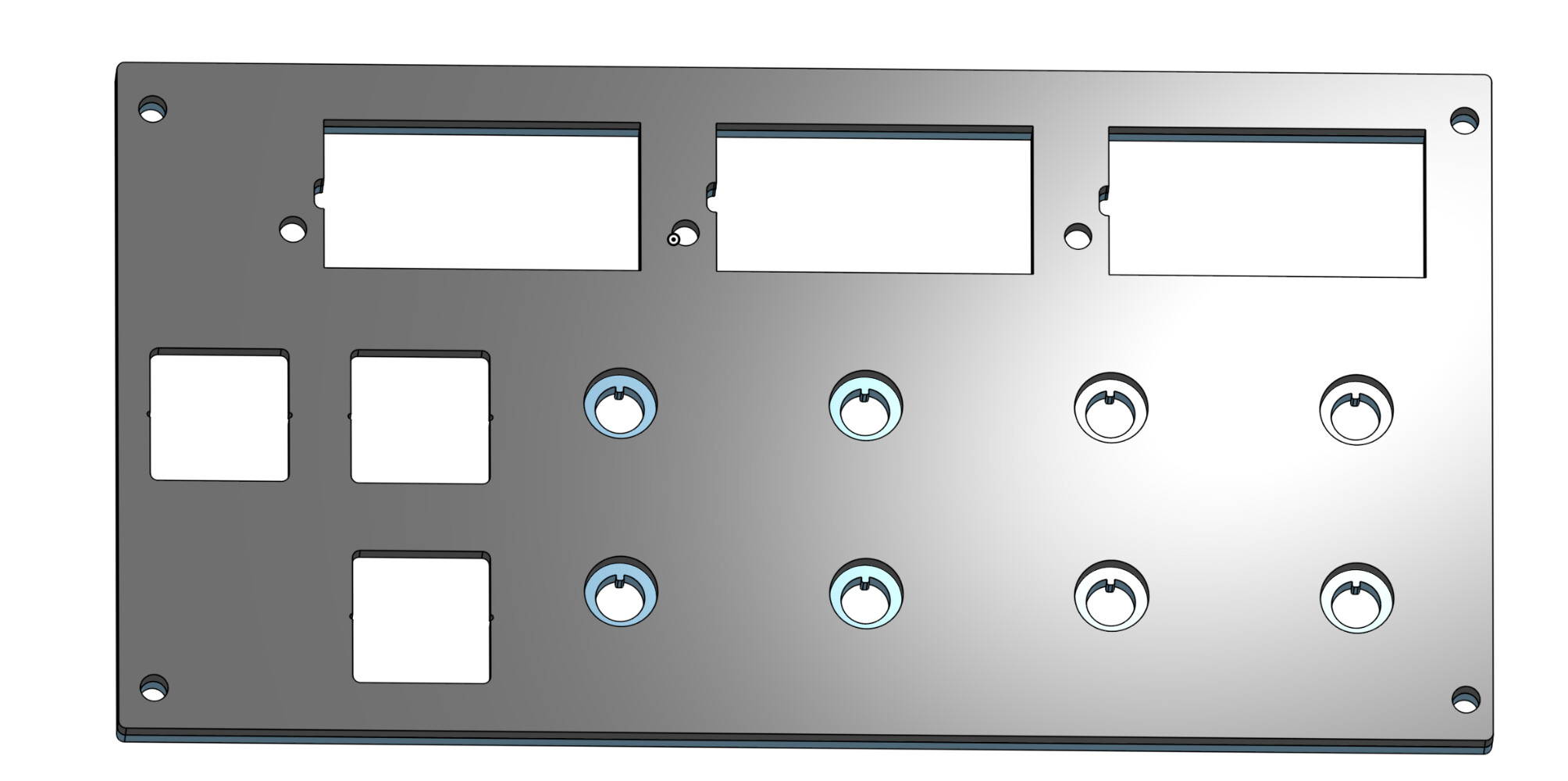

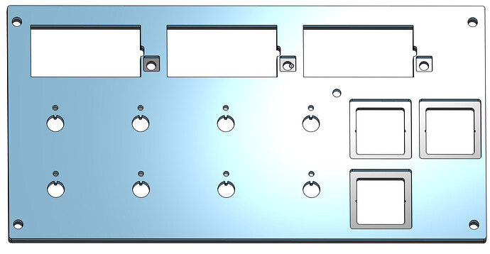

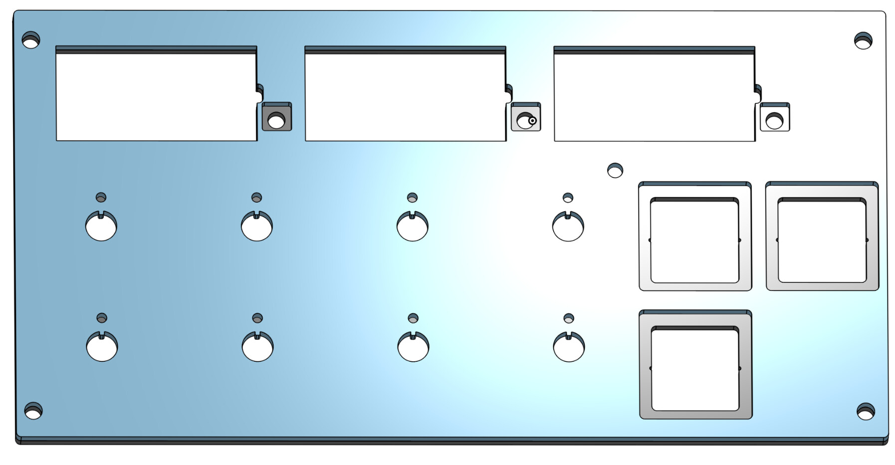

The next version is as mentioned 2 layers with the upper layer have much large cutouts so the washer and nut sit below the panel. They also have much better locating pin holes for the toggle switches (on-off-on or on-off) so they stay locked in the upright position).
front view

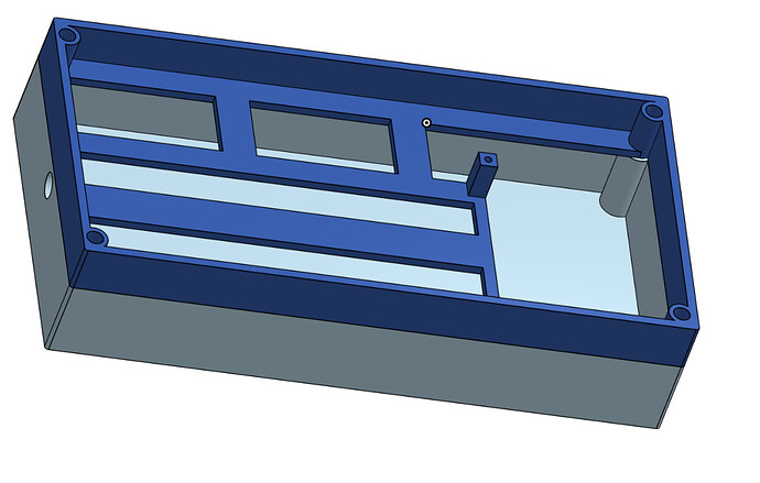

Rear of panel
And that all fits on the 3D printed case (the blue layer is for the LEDs to get stuck to

It’s all from just making many, many failed designs and remembering why it failed. Real engineers know how to do it right the first time, but if you buy a big sheet of acrylic and are willing to waste a bunch of it, you can learn a lot!
BTW: For those looking for VERY specific spray paint colors (i.e. to match an existing piece of equipment, may I suggest scratches happen. Yes technically these are automotive touch up paints, but they have all the RAL colors (damn those Europeans for their metric dimensioned Pantone hating designs! :grinning_face_with_smiling_eyes: ). For those curious the Airbus panel color is RAL 5014 (not the test paint I used in this photo above, that was from a separate project. The next version will be in the right colors…

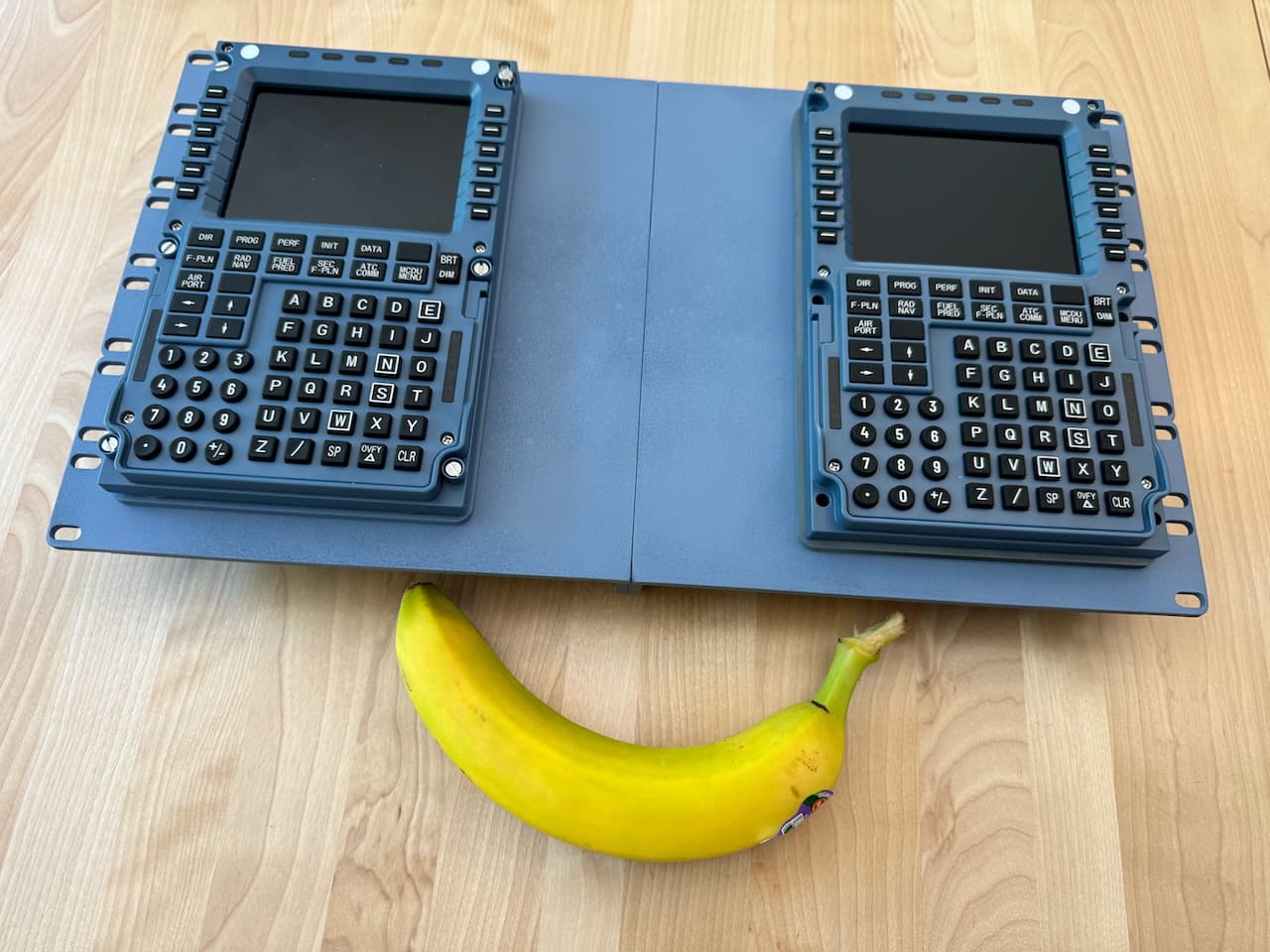

Just to put the scale of all this in perspective this is the 3D printed dual MCDU panel (that banana is not Airbus standard…). The panel is extremely rigid due to extensive ribbing on the back. I released the panel on Printables if anyone is interested. When I am done (this was a test panel, the final FO side is printing now, the Capt side’s paint is drying in the workshop) I will ding the panel up with some rubb n’ buff silver to make it look real…

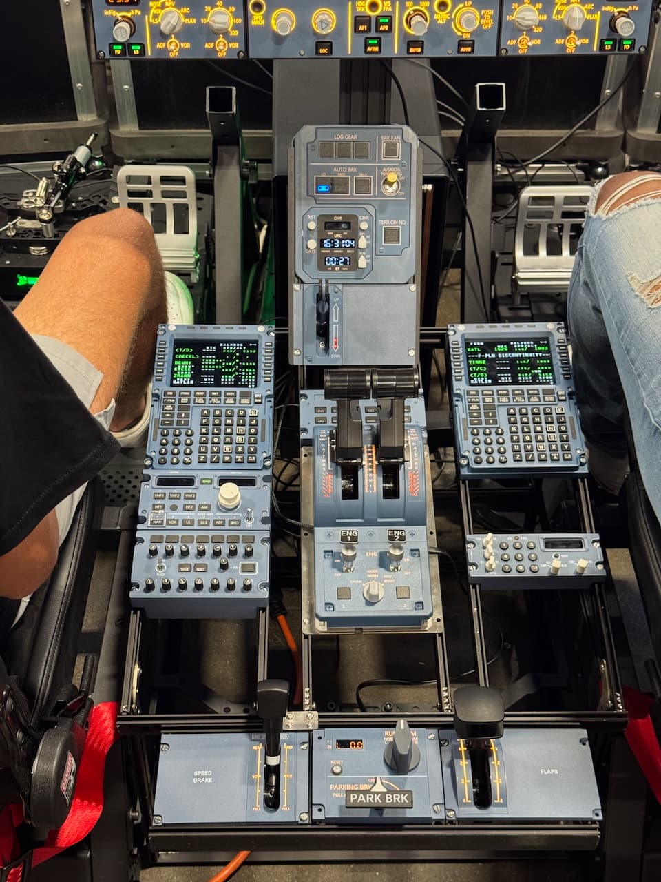

Just to show you what amazing stuff WinWing announced here was a prototype full A320 cockpit in action at the expo:
Obviously when the throttle finally ships I will need to modify my panel, but for now, don’t need to

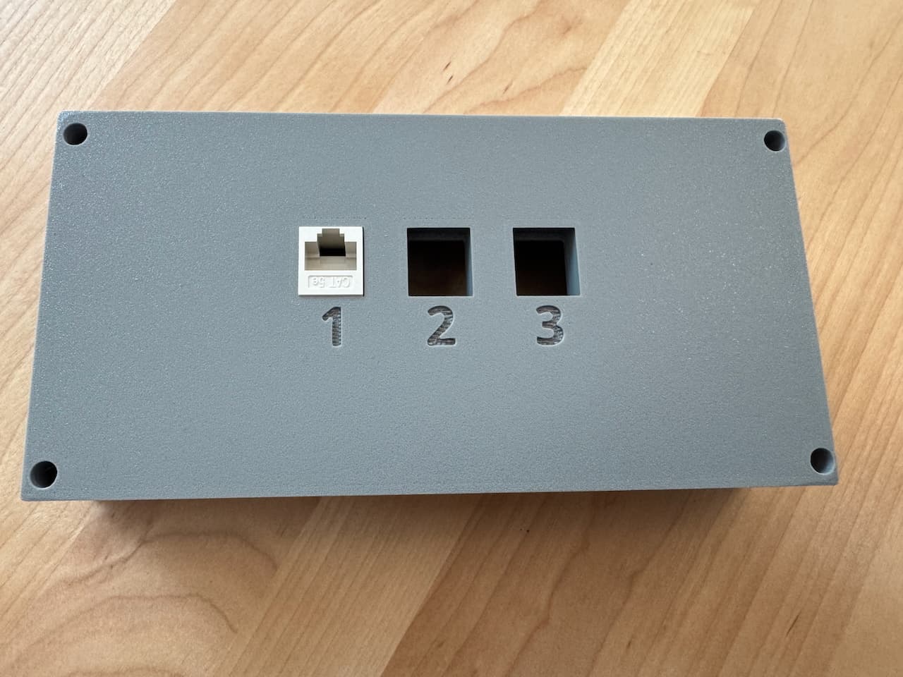

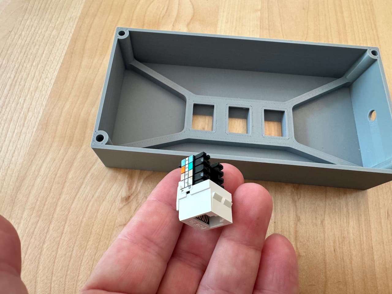

Another cool thing I learned was how to incorporate RJ45 keystone jacks into my models to make connections. I have to give credit to Karl at 737diysim with this idea overall, which is to use RJ45 keystone jacks not for ethernet, but just 8-pin connectors. Gosh it is handy to have connectors that don’t require fiddly pins (looking at you JST connectors) or soldering, but can use my type-66 punchdown and bam, 8 pins with twisted pair, reliable long premade cables (and not like the switches and LEDs have high data rates, I mean if you want to flip your landing lights switch at 10 billion changes a second, then sure, but I’m figuring 1 bit per 5-10 minutes per pair, even the cheapest ethernet cables will work just fine. Also since this is “high voltage” of 5-12V depending on the pin, I don’t have to worry about signal strength.
I’ll skip the banana on this since ethernet jacks are known sizes (well not on the GF, but that’ battle was lost long ago…)
I’ve got a weakness for DB-9 and DB-25 D-sub connectors myself (age showing!) but that is a sweet look. Not to mention that there is no screwdriver needed to connect or disconnect.
DB connectors are fine, and all but DB cables are a pain in the butt, I’ve never seen a DB-25 that is 100’ long for instance (but I could make a 1000’ RJ-45 cable right now (no idea if my drivers could power that much cable resistance wise, but 100’ is off the shelf. I will probably only use a 14’ ethernet cable since I A) have them on hand, let me keep the control box next to the PC running the simulator compared to my seating position.
