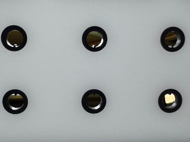

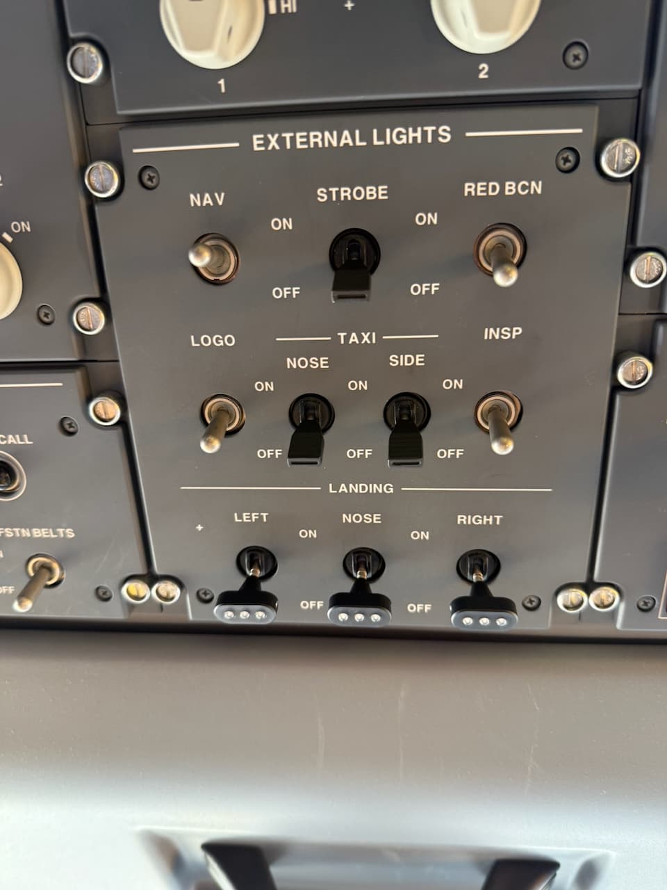

After making yet another failure (so much learning!) where I now have a really nice 2-layer panel which of course I discovered there was no way to tighten the nuts of the switches once I had welded the 2 together (which I did and painted to engrave the words). I wondered how the pros did it, and while most people don’t have easy access to airliner cockpits, since our youngest is operating today (as opposed to our oldest who is actually operating today) I asked him to take a closeup of his overhead lighting switch panel. This is the Embraer E-175, and those clever Brazillian engineers solved this in a way I never would have thought of, so if you zoom in close on the metal toggle switches you see they put a threaded insert through the panel, that’s insanely cool. I’m tightening a nut from the front and they just screw the whole switch in. I am assuming their threaded insert has a broached keyway inside and a little keyway pin to lock it (or some bar on the back that prevents the switch from turning). But that is so insanely cool…

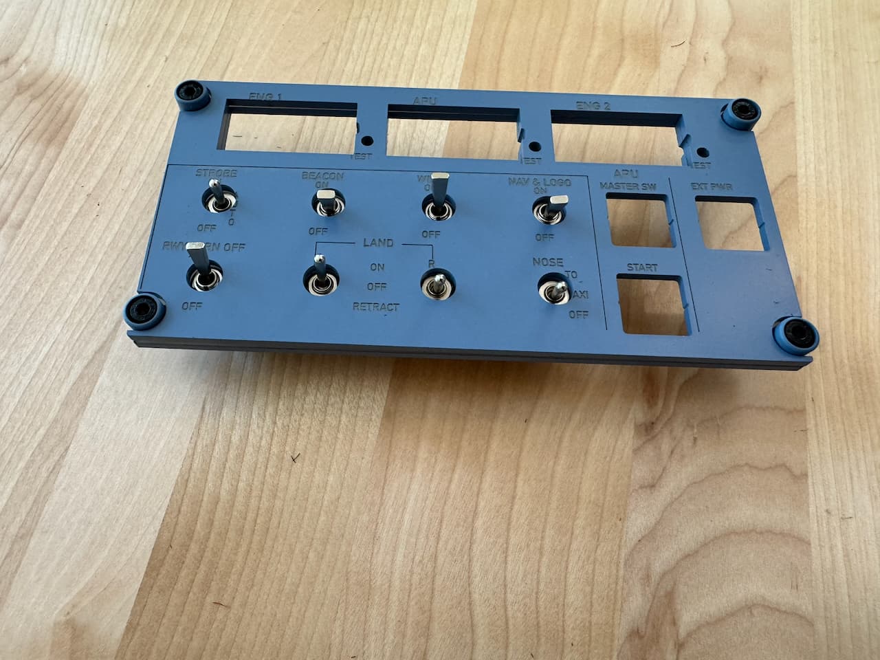

Here is the failed panel: (note it can work if I don’t weld it until the switches are in place. but the Embraer solution is kinda tempting me…

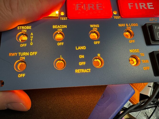

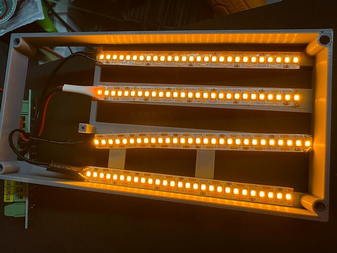

Well have you ever looked at an eclipse without eye protection? Ever stuck your head in your GlowForge and stared into the running laser? Yeah, well those pale in comparison to my slightly overdone backlighting. Fairly sure it left a burned in shadow on the wall of my shop of my body when I turned it on. Then I put the engraved panel on top, and the letters are so blindingly bright that you can’t really look at them (and that is through 2 layers of 1/8ā€ 50% white acrylic!) Gonna need a dimmer (the photos don’t do it justice but the entire room is lit bright orange):
note: the fire indicators have back boxes so don’t get lit by the backlight (their lights are in boxes driven by the sim)

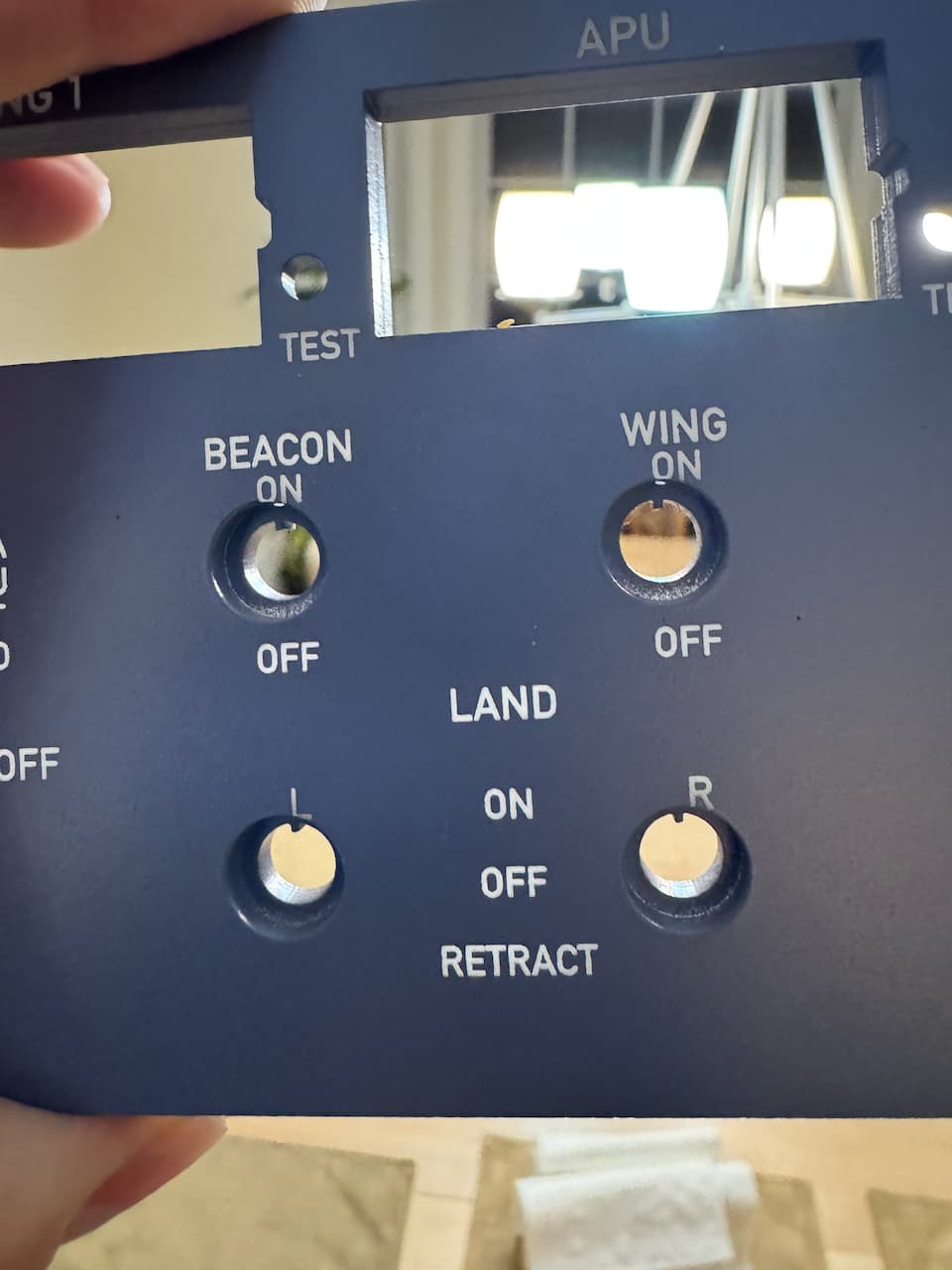

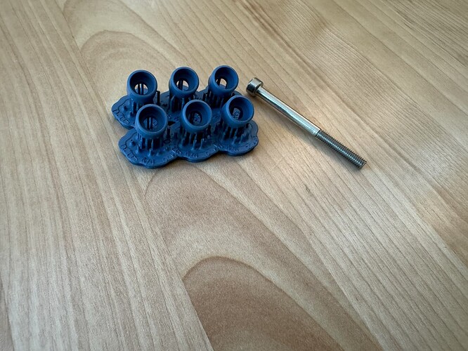

Yeah, except those panels are sheet metal (not sure if they are aluminum or steel). He said he’s seen maintenance open the panels before and there is a rail that hinges down to lock the buttons square. I have heat inserts on the project (for the case on the back) and 3D printed fake DZUS connectors for the screws in the corners (little 3D printed cups that make them look like real DZUS screws without spending $15/screw) While most DZUS screws are slot-headed, the good news when my son has sent me pictures of various panels from his jets, they must lose screws when they take it apart and replace and often the replacements are black-coated instead of zinc coated and might be phillips or hex, so my hex heads don’t look too weird.

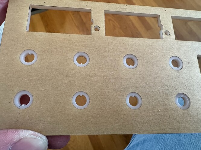

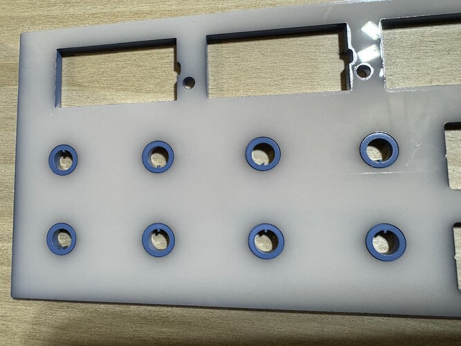

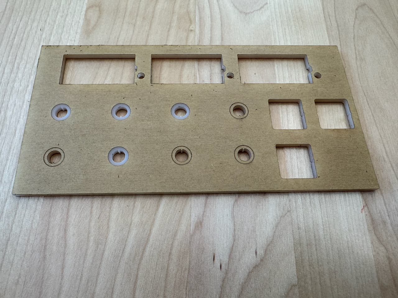

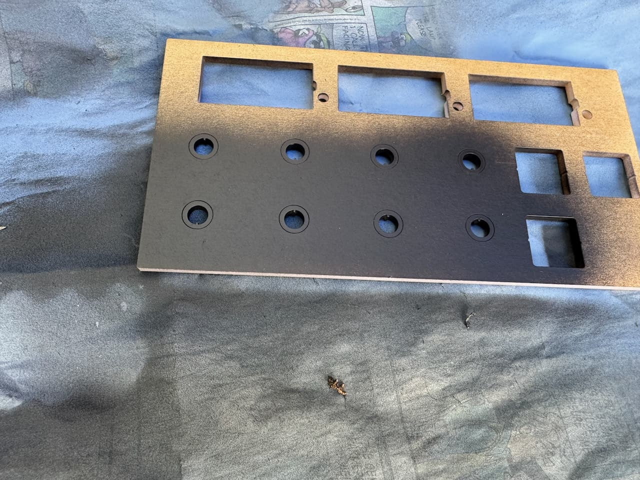

After assembling the double layers I realized I can’t tighten the nuts once assembled (no way to fit a wrench given the 0.5mm clearance) so then I was left with the problem of I can’t paint the second layer before welding it or it wouldn’t be translucent. I needed a mask, but had no way to do a simple mask that matched the holes on the top layer that wouldn’t be a whole project in itself. Until I realized if I just added a score outline around the holes I could just weed the ring of masking paper that just covers the area under the nut.
Here is the bottom panel layer straight out of the GF

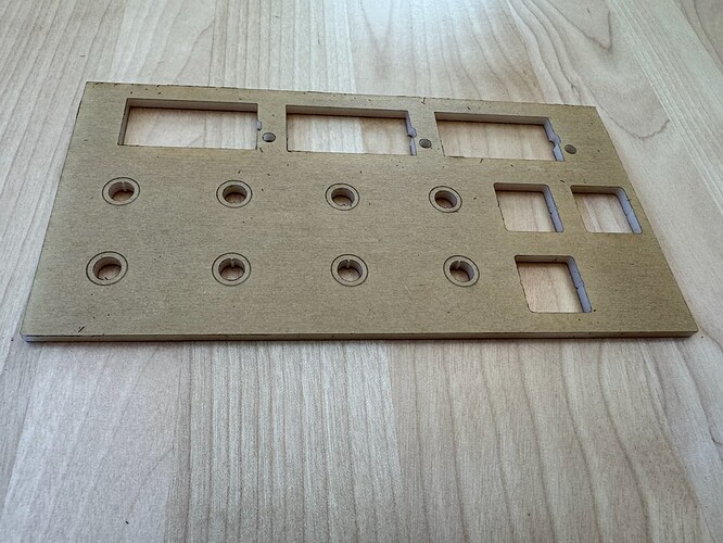

partly weeded
Fully weeded

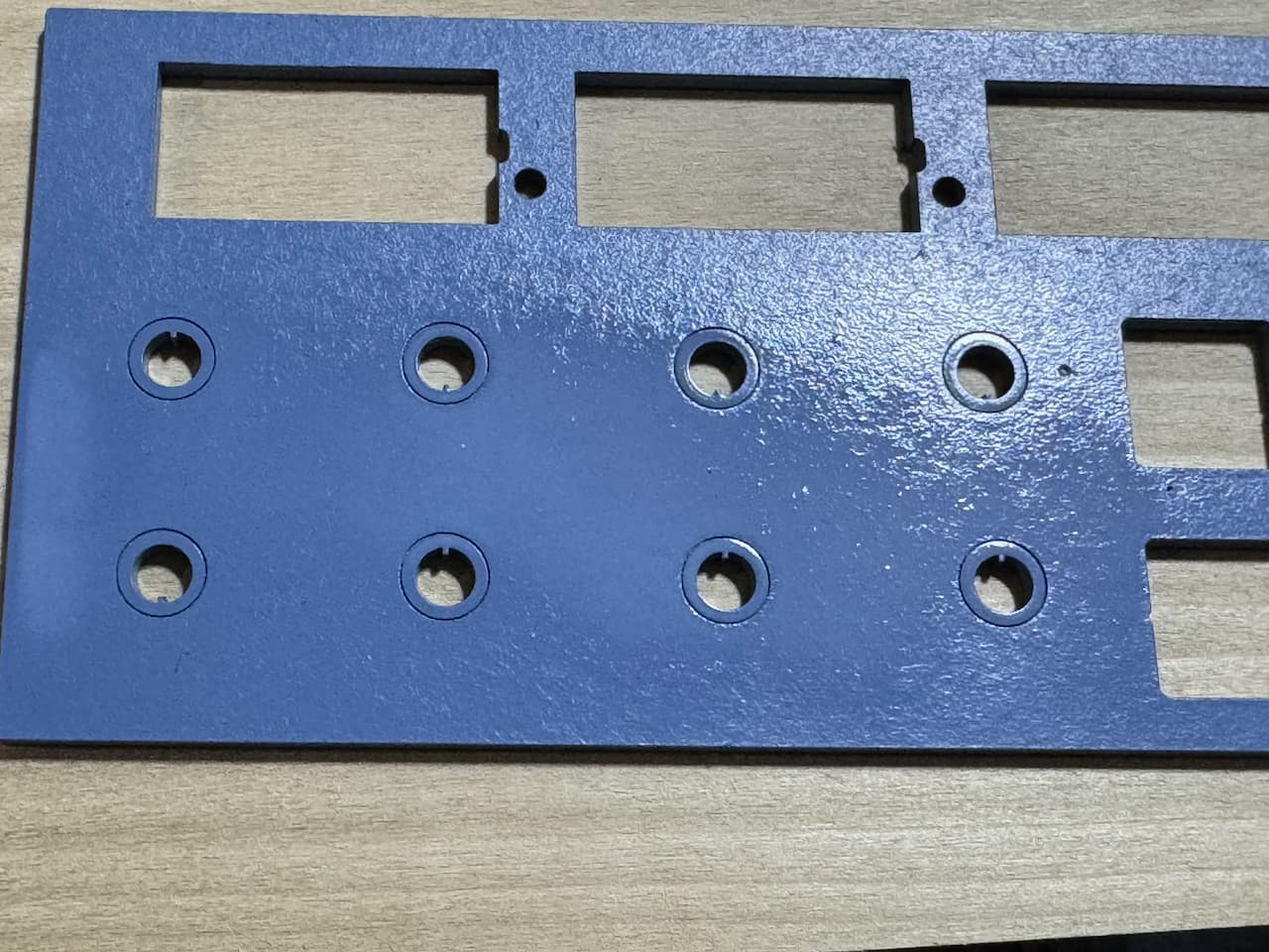

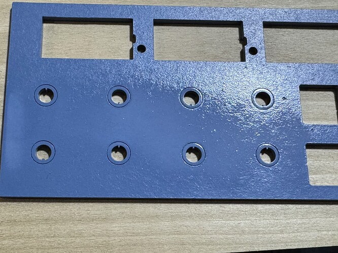

Primed with Mr Color 1500 black primer (did a few more coats)
Top coat of Airbus RAL blue-gray
Removed top masking paper
Removed the backing as well and did a quick hold up to the light.

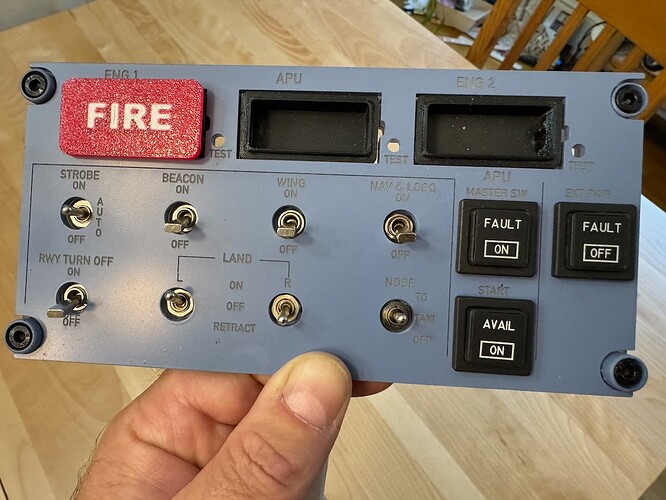

Although the panel is ruined from the engrave being misaligned (?) the DZUS connectors looks real and snazzy (this is just a test fit for appearance’s sake as I haven’t welded the layers since the engrave is wrong…

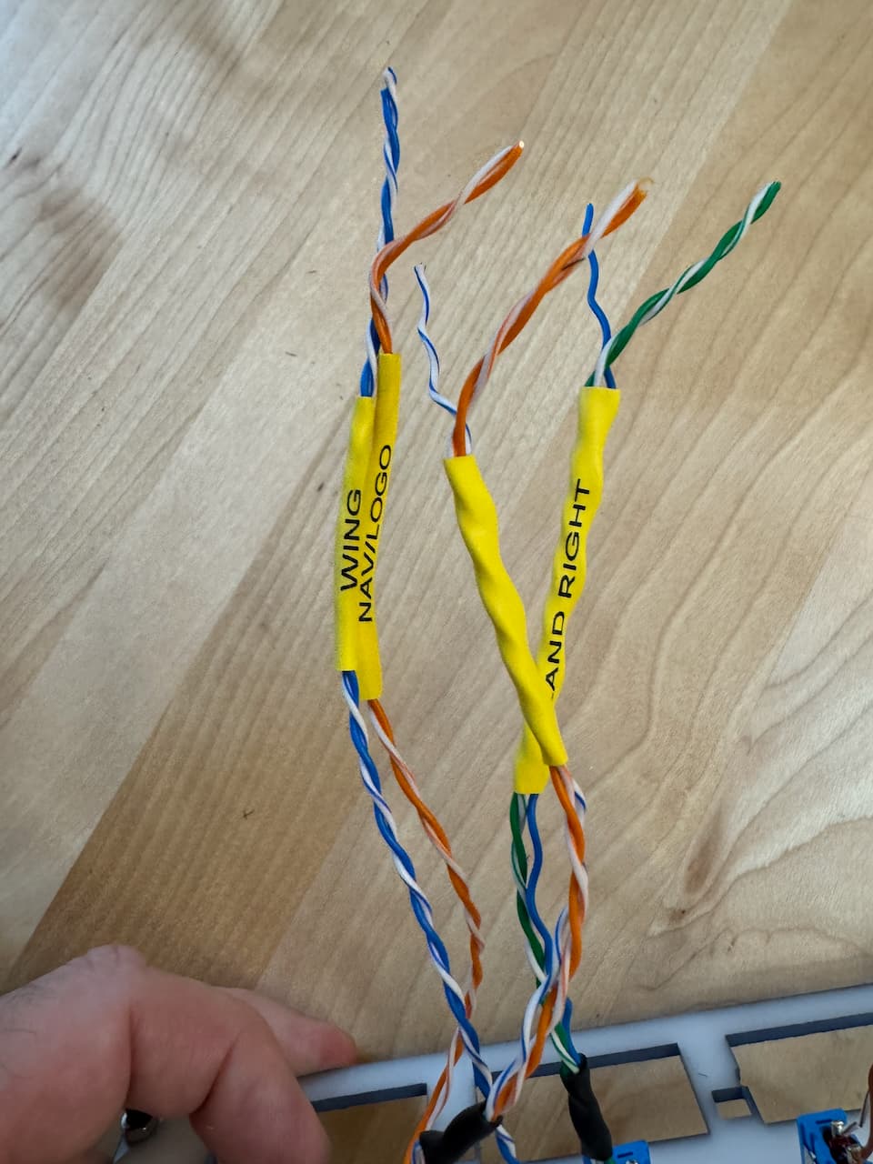

Got the panel’s wiring mostly done (need to do a 2 more of the MOSFET boards and then punchdown on the RJ45s. I made a miscalculation and realized I had more than 3x RJ45s’ worth of wires so realized I should have done 4, luckily this was parametric in my CAD design so that newer case is printing now. But here is the wiring progress:
First splurge of the project was buying a labelwriter than can do shrinkwrap, because all of these look the same.
