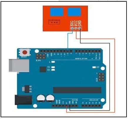

For those wondering what they are and what they do, MOSFET (acronym for metal-oxide-semiconductor field-effect transistor) and basically is a variable relay that can handle a lot of power (relatively). The problem with controls like board I am using is that it uses an Arduino Mega which while Mega as far as Arduinos go, it just basically a giant arduino with lots more of the same inputs and outputs. So if you want to power a lot of outputs such as LEDs (say the 5 LEDs inside each fire indicator) that well exceeds the output current limit of 40mA of each output, plus the classic arduinos run at 5VDC while the strips are 12VDC. So you need something that will switch 12V from 5V at high current (the strip in those indicators will draw about 500mA. You could of course use a relay, except relays need a lot of drive current themselves (not as much as they can switch which might be 10A for a little relay) but say 100mA for holding them energized. But a MOSFET will do the same thing with 1-2mA to control similar power outputs. So the MOSFETs I use are these:
HiLetgo 5pcs IRF520 MOSFET Driver Module MOSFET Button Drive for Arduino MCU ARM Raspberry PI
The black thing is the FET the little aluminum tab is a heatsink, and what you can’t see in that photo is in the blue terminals you have the high-voltage in (in my case 12V) and out. The control pin is on the bottom there labeled “sig”. Now the control side runs at 5V so I have to have both, in my case I am using a Buck-Buck 12VDC-5VDC converter so I know I have a common ground (a good way to blow a MOSFET is induce a current if you have different grounds!), so basically my 12V in splits to become 12V and 5V sharing a common negative. While the arduino will have to hold the MOSFET on via the sig pin for as long as the fire lights are on (I may do the backlight but not sure yet that would be cool to have it backlit only when the jet is powered up…) but haven’t gotten there yet. For reference those FETs can switch 0-12V at up to 5A. For those curious what that all looks like hooked up:
MOSFET mobiflight schematic

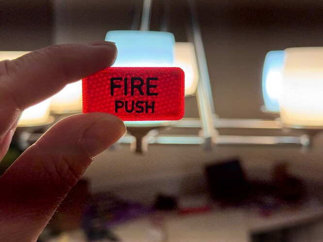

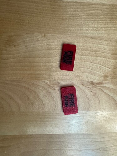

after looking at a real one realized the text is black so switched the PETG to black and tried to virtually unreadable, finally figured out white works when it’s deep but black needs to be shallow so now the text is only 0.8mm of a 2.5mm deep panel and raised the infill to 40% hex. You can see the 2 different depths of black compared. Next onto the guard cover (that will be partly done on the GF)
Bottom was the shallower depth black

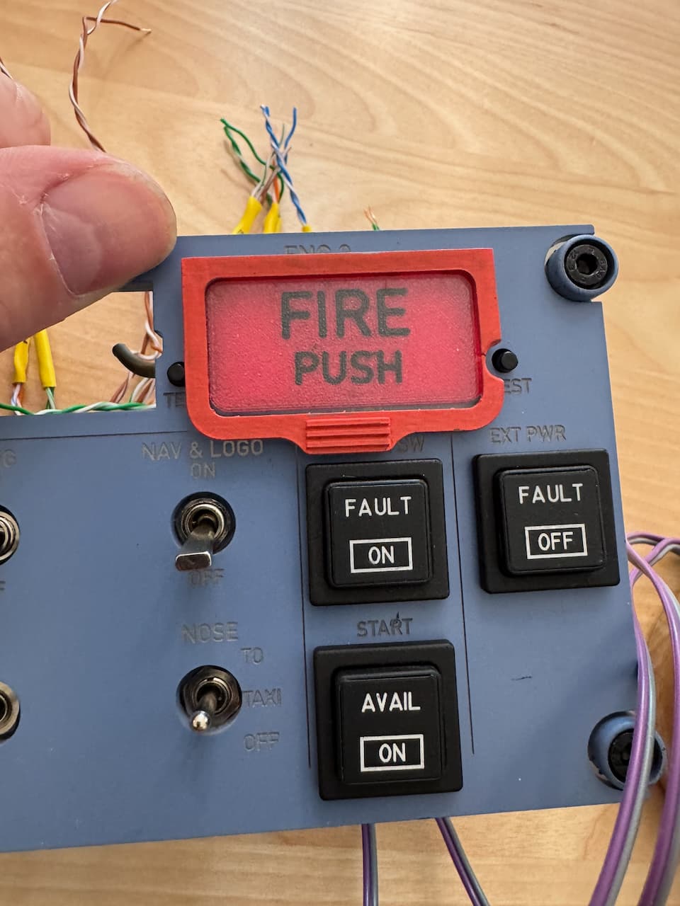

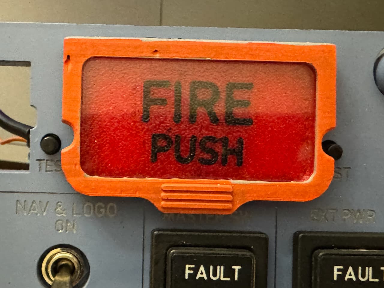

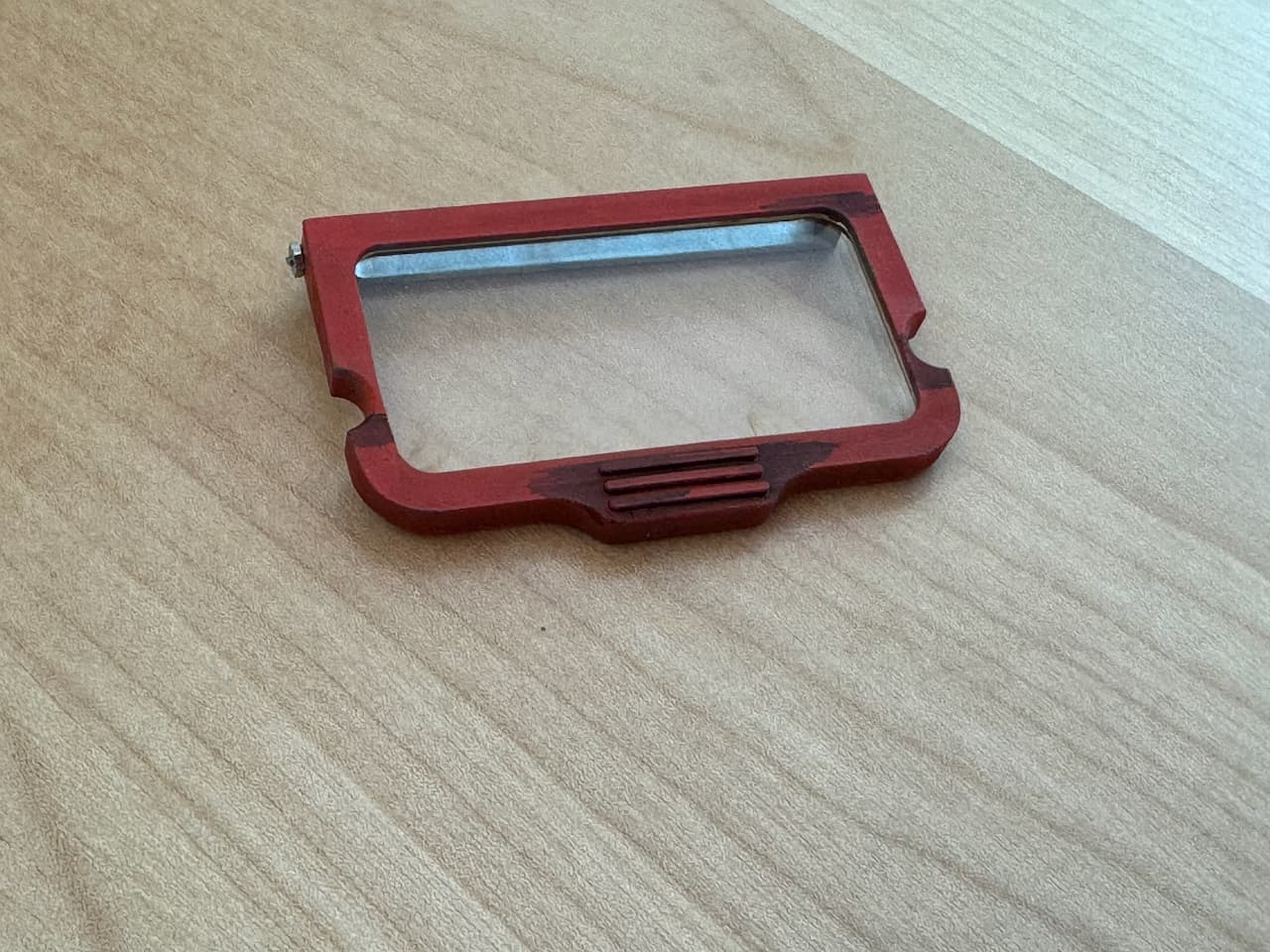

Just did the first switch guard on the GF (that’s 1/16” [1.5mm] clear acrylic) and a SLA printed frame (painted with RAL 3020 Red Acrylic). The hinge is a simple M1 screw into a medium PG acrylic block with a hole in it. (I don’t have the patience to engineer a sprung hinge like Airbus did)
haha, but don’t think I designed that cutout for the test button on the first try… Sure I am an idiot but at least a teachable idiot! :grinning_face_with_smiling_eyes:
Sigh, I spoke too soon, a partially trainable idiot… Oooooh, there is a button on BOTH SIDES of the indicator that need cutouts… Well a quick draft print (hence the little dents) and we have clearance for the both test buttons (trust me they are lined up the panel is just tilted relative to the camera):

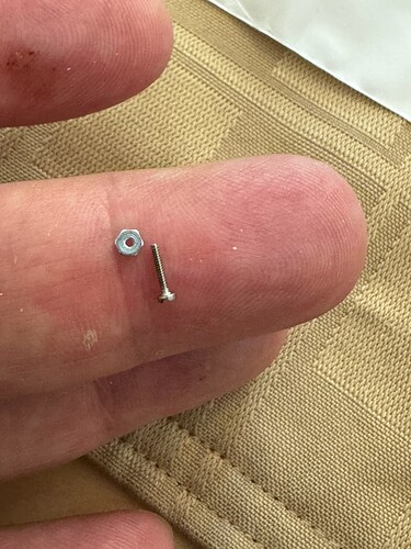

And then I did the first test hinge. Wow, I was not quite aware of just how small the hinge screws/nuts were when I specified them in the CAD model (sorry no bannana as not sure how that would be a valid size here - my fingers are not abnormally sized):

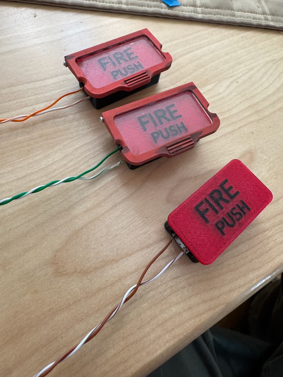

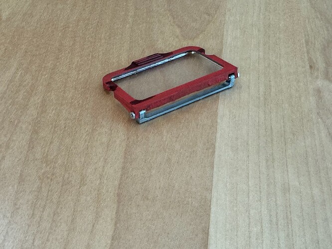

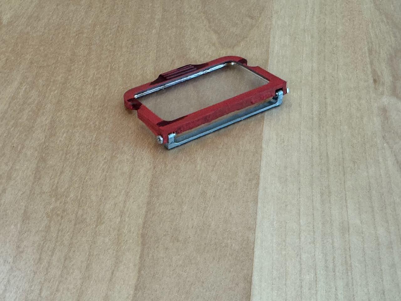

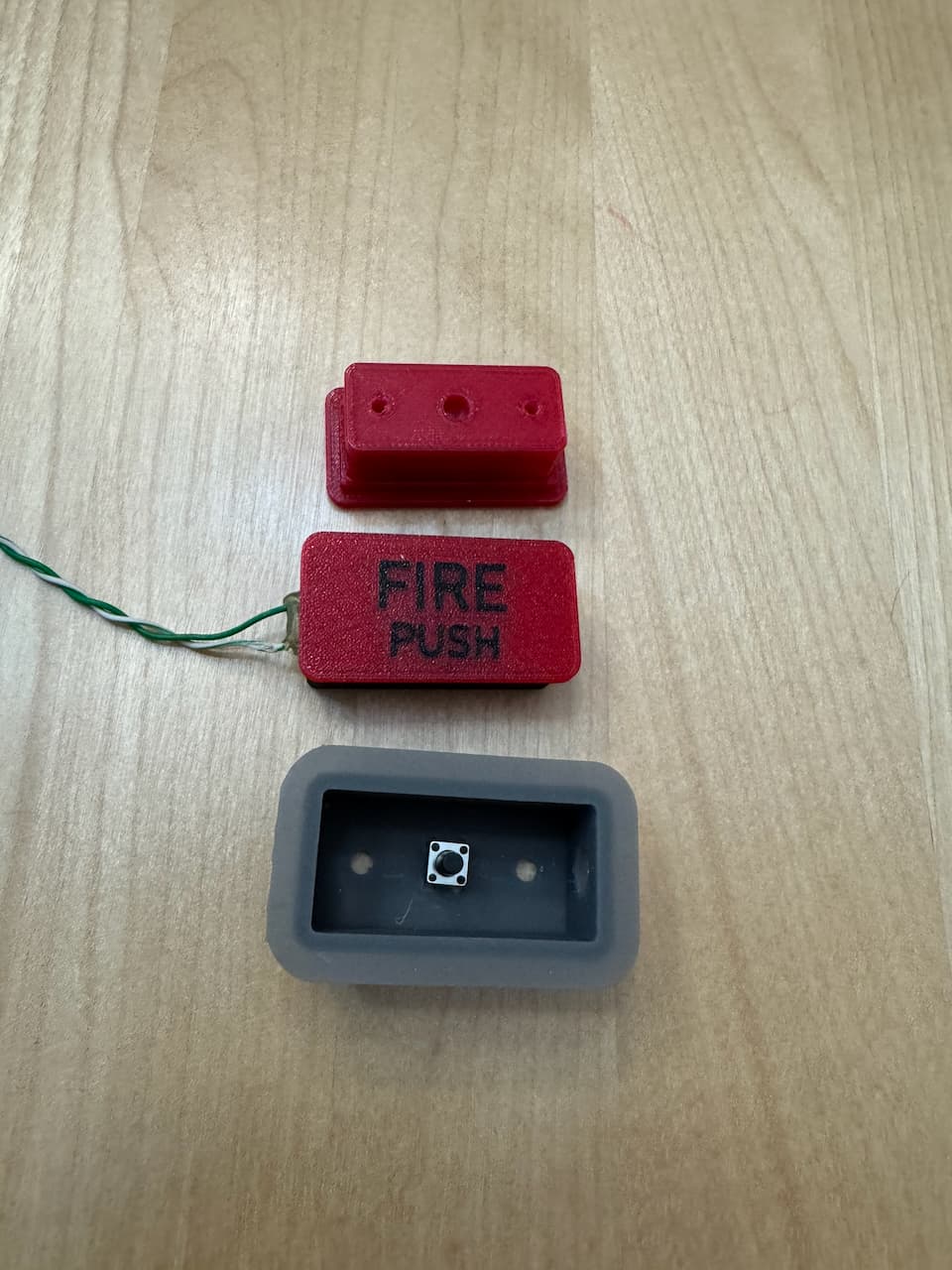

Got the first hinge done (man those screws are tiny in my hands), My son noted they needed to be grunged up as the ones in his plane have a fine coating of burger grease and coffee, so a little burnt umber oil paint and Tamiya Panel Liner and we have greasy grunge (somewhat interesting [not really] is how the panel liner flowed to form those weird almost stripes except where the grips are, it moves by capillary action). I am going to sand the back edge a bit more and repaint since that looks rougher in the photo than in real life but doesn’t feel that bad…:

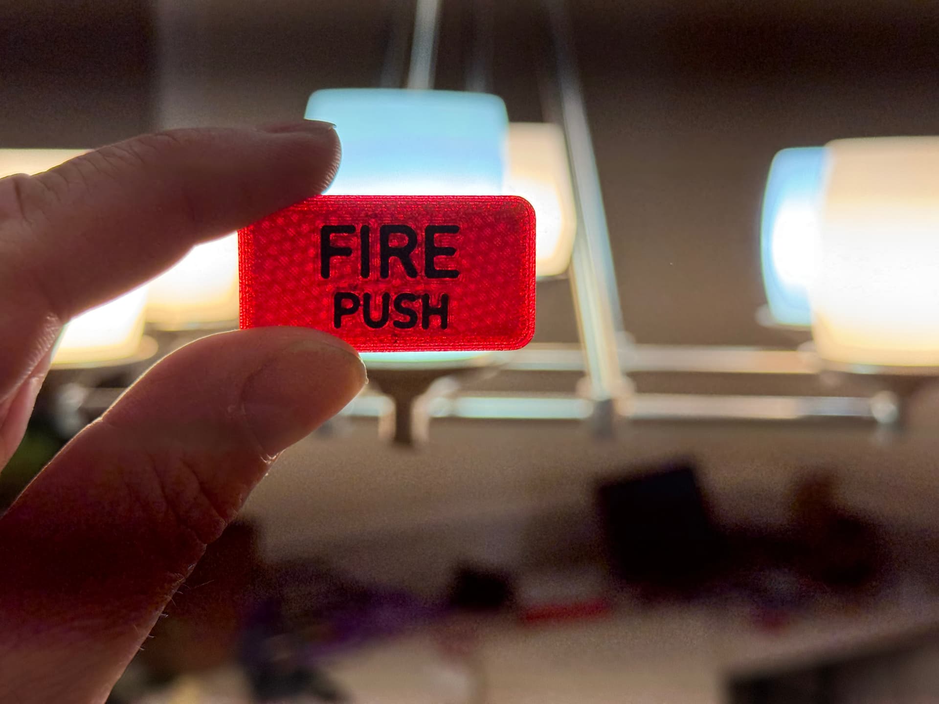

Being an IT guy and developer, I always worry about maintainability and honestly the fiddly parts to make the button go together was just not going to last (plus since it was many parts getting the tactile switch underneath to work was very unreliable). But with CAD and a 3D printer with 5 heads, easy problem to solve, now the black case (to prevent light bleed) is simply part of the button, and to make the lighting built in, it now has a groove in the middle that lets me put the LED strip (it is around 10 LEDs inside) so voila! little bits to glue on, takes 2 extra grams of filament (love the way the XL does color swaps! No Bambu poop chute!). The Red is transparent PETG and the black is jet-black PETG.
Anyway, this is what they look like (there is a groove to mount the guard hinge plate now)
In case you are wondering why I am spending so much time on the fire indicators, it’s because on this panel, they are the only switch/lights that aren’t simply off the shelf (the toggle switches are just toggle switches, the Kory buttons are Kory buttons, so these had to get made)

Today’s exciting revision was I was looking at the fire indicators and while my original plan was just to have them light up and not make them buttons as well (just press the virtual button on screen during the actual fire) I suddenly realized how I could alter them to be pressable buttons. So the design is pretty simple without major rework of the panel, I SLA printed a back, that has a mounting hole for the tactile switch (in a 6x4 layout) and then the two holes on the sides are because since this originally was just getting glued onto the panel there was no provision for keeping it from popping through, so that holds a pair of M3 screws with light springs over each to provide a robust spring back (the button is sprung but just relying on that left is rocking and binding).The flange on the backing sandwiches between the 2 layers of acrylic that make up the panel (the flange is 0.75mm thick) The holes on the sides let the wire for the LED strip to come out. I also got stranded twisted pair wire instead of cutting up ethernet cable (the idea is these all punch down to a RJ-45 keystone) so redoing all the leads is on deck for the day.
