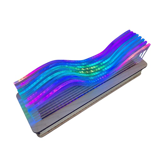

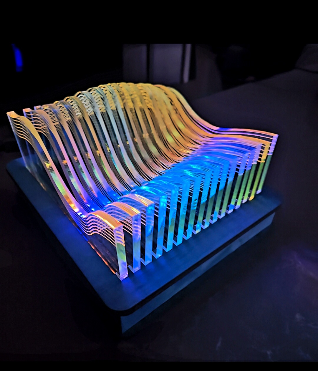

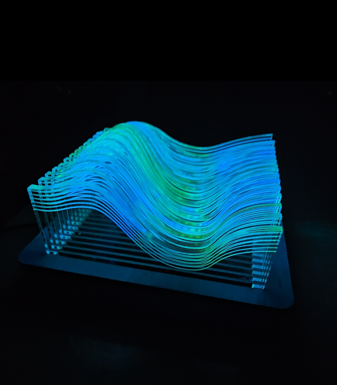

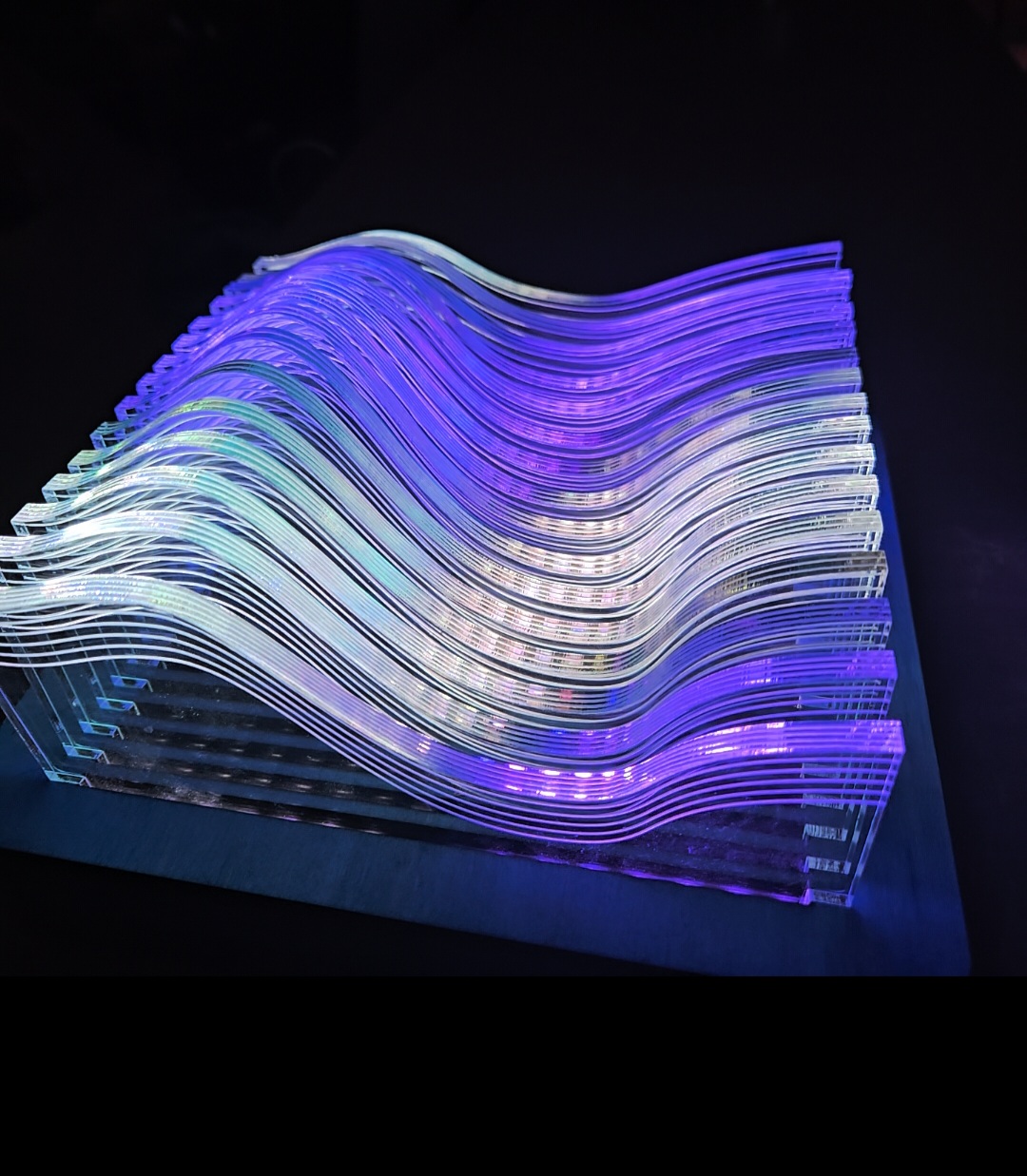

I saw something similar out on the interwebs and thought, why not…
Inside there is a 16 x 16 matrix of LEDs, driven by a small arduino (trinket pro 5 volt).
Static photos do not do it justice. here is a link to a bunch of videos.
16 2-d waves that form a 3-d wave cut from the thick water edge proof grade. The base is quick and dirty box made with Baltic birch that has been spray painted black.
Will probably make for another one that is longer based on the 8 x 32 matrix of similar design and pay more attention to the finish of the wood.
Custom code? Fastled?
Yes, custom code based on fastLED. But…some of the early videos were shot when it was running an off the shelf LED driver running a stock pattern. I was having trouble getting the code to compile and load in to the trinket (which is always tricky) and wanted to see what it looked like. I eventually determined the issue was a bad usb cable and got the trinket working properly. I would make a few more changes, now that it has been running a while but overall, I am happy.

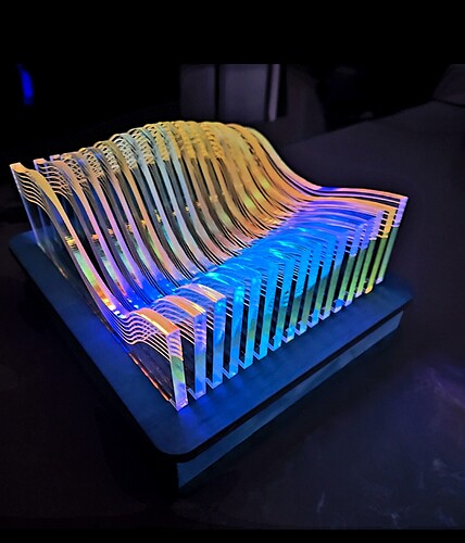

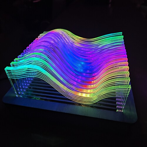

Revisited this design. Took a bit of work to sort out my scrambled folders (i.e.tags) but found all the parts and made a few tweaks. Assembly went much smoother. Updated the LED brain to a pixelblaze and love the results.
Videos Here

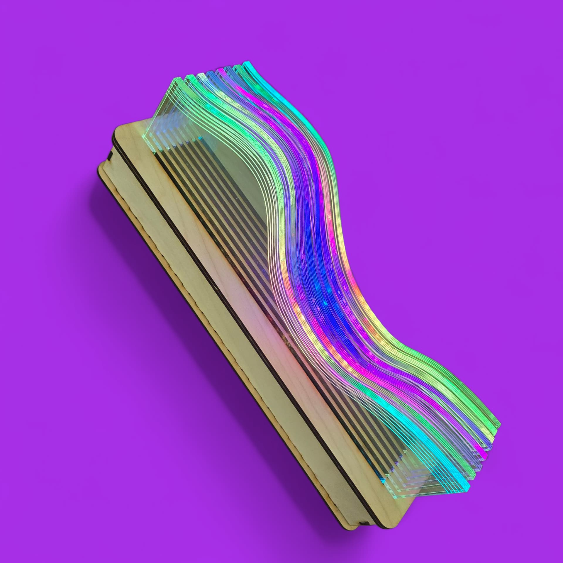

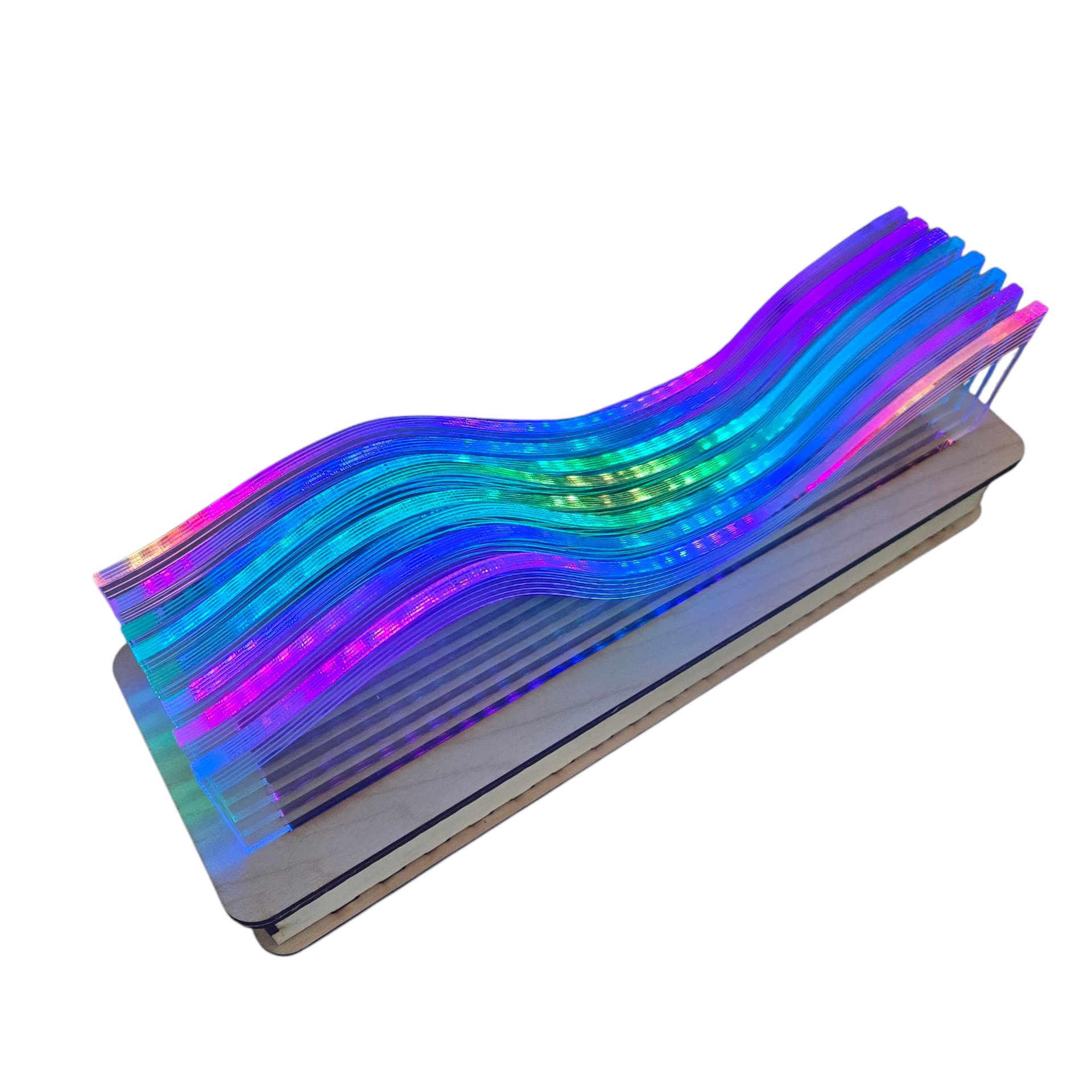

I made a long skinny version as well. I think I like (prior) the square ones better, but I do not hate this one. Video here.
Up next, more wave action in a longer but not skinnier version.
