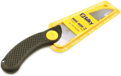

nicely done. i’d suggest picking up something like one of these small woodworking hand saws to make such issues easier in the future…

I like the size – you can also use a #2 X-Acto knife to score parts out from the back. It’s a little slow but gives really clean edges. Just wear hand protection, in case the blade gets stuck and you have to yank it out…soooo many cuts in my hands :confounded:
