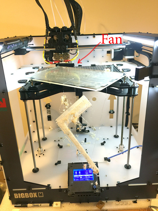

Well for me it will be rebuilding after this afternoon’s “oops”. This is why you don’t walk away! This was a functional piece for work in Nylon, which had some weird early failure causing the print to go off to the side, which then caused curling, then causing the piece to get launched which then hit the right extruder’s fan which tore it off the x-carriage (breaking parts off in the process) tearing the wires out of the fan, and ultimately ejecting the print bed! Timelapse movie link is more entertaining
I should add, it still prints believe it or not, I just only have cooling on the left head…
Ouch! :frowning:
Now that is a 3d printer! I’ve had failed prints due to bump /adhesion failure but never any damage to my machine.
I would imagine anything other than Nylon would not have been as damaging. Nasty failure ><
Yikes :anguished:

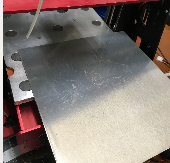

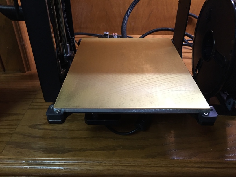

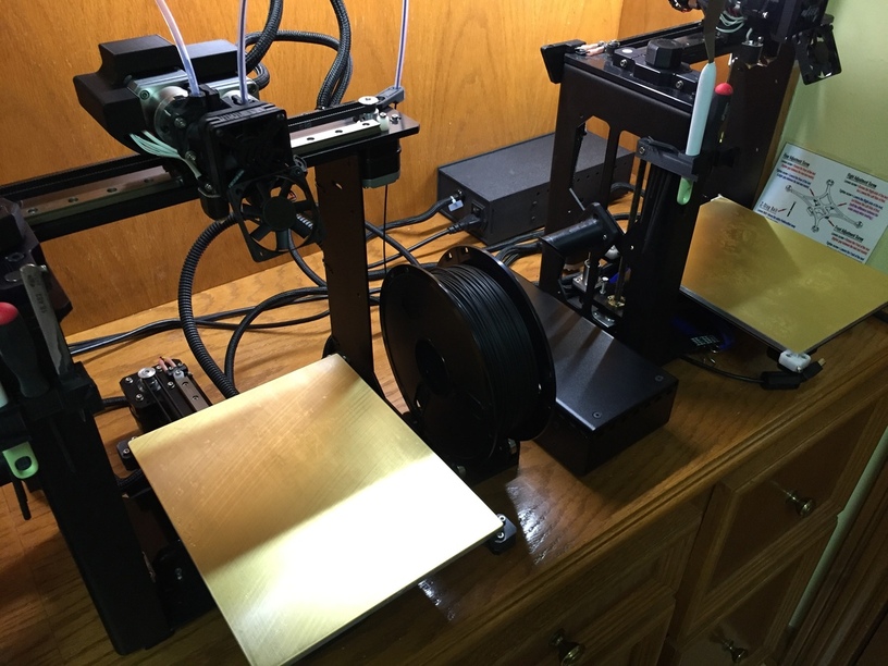

That’s pretty similar to what I use on mine - they’re MIC6 aluminum plates with a PEI top surface.
No adhesive needed, perfectly flat surfaces with even heat distribution to the very edges. (win!):relaxed:
That PEI surface holds on to just about everything when it’s heated, up to and including polycarb. (Haven’t tried it with nylon though, so not sure about that.)
The plates are 1/4" thick, which is pretty hefty, but it’s the smallest you can buy from McMaster -Carr.
That is awesome! How did you get them coated with PEI? Did you coat them yourself? very highly interested in this process as I would like to be able to make some custom/multiple plates for use and not have to buy them.
… I would send a like your way but it seems I overdid myself yesterday so :+1:
Yes, PEI works great with nylon. Bridge is one of my favorite filaments for practical parts.
It is available in self adhesive sheet.
