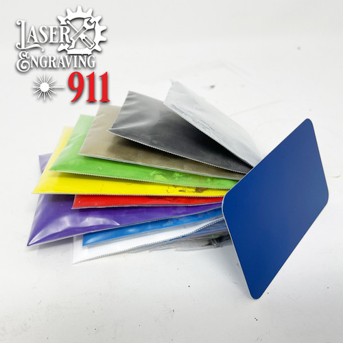

I think it would be cool to set powder-coating onto an object in the desired pattern, rather than reverse-engraving a design into a previously powder-coated surface.
If I had access to small quantities of material, I’d love to experiment…
That sounds like exactly what I did in the post @dklgood shared above.
This person will sell you a sample pack:
