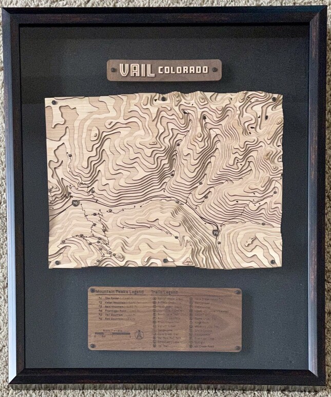

Vail Topo Trails Map
Made this for my brother in law and his wife as a christmas gift; they like hiking a lot of the trails around Vail, CO. I won’t bore you with all the details of the data manipulation, but the model has the topographic contours, hiking trails, I-70 highway, lakes, and peaks marked/labeled in it.
The project is 1/16" cherry and walnut woods, walnut finished with Danish Oil. I was going to finish the cherry with it too, but after assembling, I felt it looked better unstained. Wood is glued together and then mounted to the backing board of the shadow box with some small standoff hardware. Because I forgot to include something for scale, the topo part of the project is 10"x13", the overall piece fits into a 16"x20" shadowbox. The actual scale of the topo map is 1"=1 mile (horizontally; I didn’t do the math to figure out an accurate vertical scale :grinning:). And now to the pictures!

This is excellent! I love that it’s on standoffs - just makes it pop. I wish I had the skills/knowledge to do this kind of project. Great job!

Great job with the irregular edges. It makes it have a much more natural feel to it.

Thanks! Material saving technique too:) With this process, the whole topo model only takes 2 sheets of material, as opposed to cutting each contour all the way to the edge of the 10"x13" board.
Yeah it’s a beautiful area. I initially was going to do it focused more on Vail (south of I-70), but then I found out their favorite trail in the area is Booth Creek Falls (ne of Vail), so I had to adjust everything-luckily it was while I was still in the file making phase of the project.

Thanks! Well, I already use GIS software as part of my job, and I do trail planning, so already knowing where to get some of the data and how to work with it def made it require less patience for sure. That being said, I’m happy to share info and advice if anyone has questions-just didn’t want to add a bunch of boring text to the first post :grinning:

Nice grain alignment in the wood, too.
Thanks! So this map would be…1:63,360 :smile:

I’d love to hear more about the data manipulation – starting data format through to svgs into GF.
