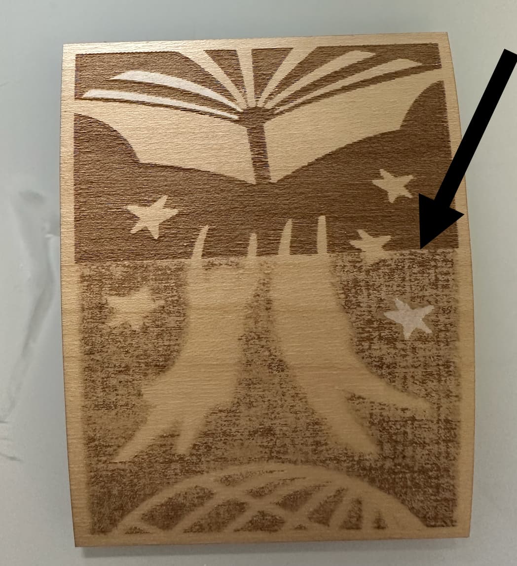

So… in engraving over the Glowforge sticker on the wood veneer, the sticker prevented proper engraving. The arrow shows where the sticker was. It’s such a huge sticker, it’s rather a waste. Is there anything I could do, other than peeling off that sticker before lasering?
Yes, just engrave from the back side.
Hi there! The back side of the veneer is the sticker, so I can’t engrave on that side.
Oh, yeah - the self-adhesive one. OK, then, yes, you’d have to carefully remove those awful stickers. I despise them. They could so easily have made them easy to remove..
Besides removing the sticker, the point thing I can think to do is do 2 passes, but that probably won’t be good for the part that isn’t covered in a sticker.
It might be a little bit off, but I’d make a jig and put this sticker back in and do another pass. Maybe cover up the side that was already engraved properly with two layers of masking, just to try and even it out.
It’s not going to be perfect. Not even close.
This is a loss. Toss it and move on, the current price for veneer is 5.25 cents per square inch. This looks like it’s about 30-50 cents of material. I would spend no more time on this, it’s not worth it.
I’m always having to remind myself of the actual cost like this. I forget time and time again how little material costs versus the value of my time.

However…my pro…I can’t do this. I usually peel the giant sticker off any proofgrades before I start an engrave. The big stickers come off easily compared to the old small ones.
Alignment isn’t the issue (for me) - it’s the inconsistency in the stickers. I actually avoid buying GF materials when practical because of them.
