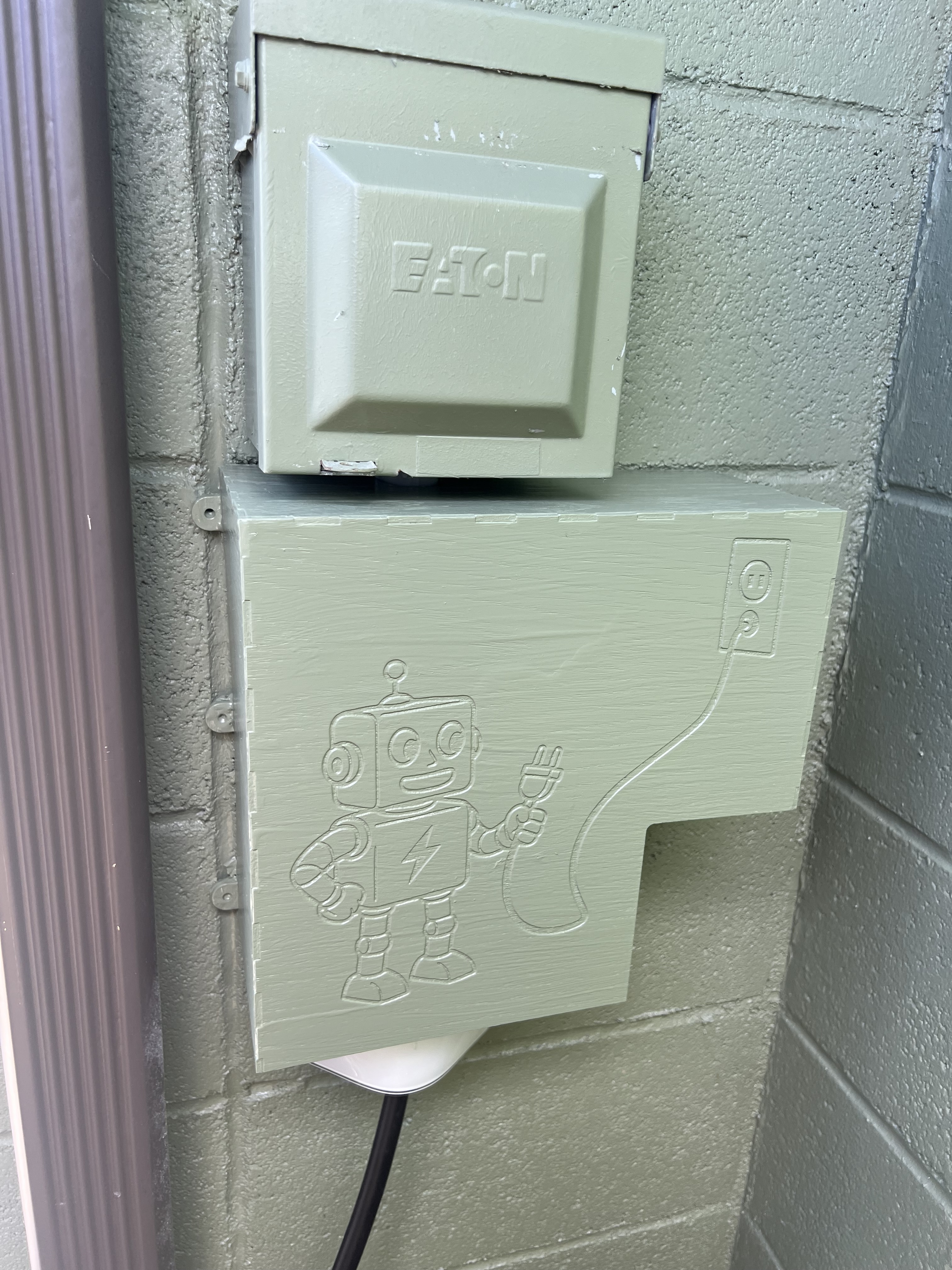

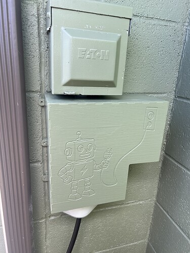

Weather box for the car charger
It was recommended that since we mounted the charger for the car outside, that we should have a box around it to keep the rain / UV off of it.
Per my quick online search, this seems like something one who plans better would have attained before the installation…
But since I excel at making boxes…

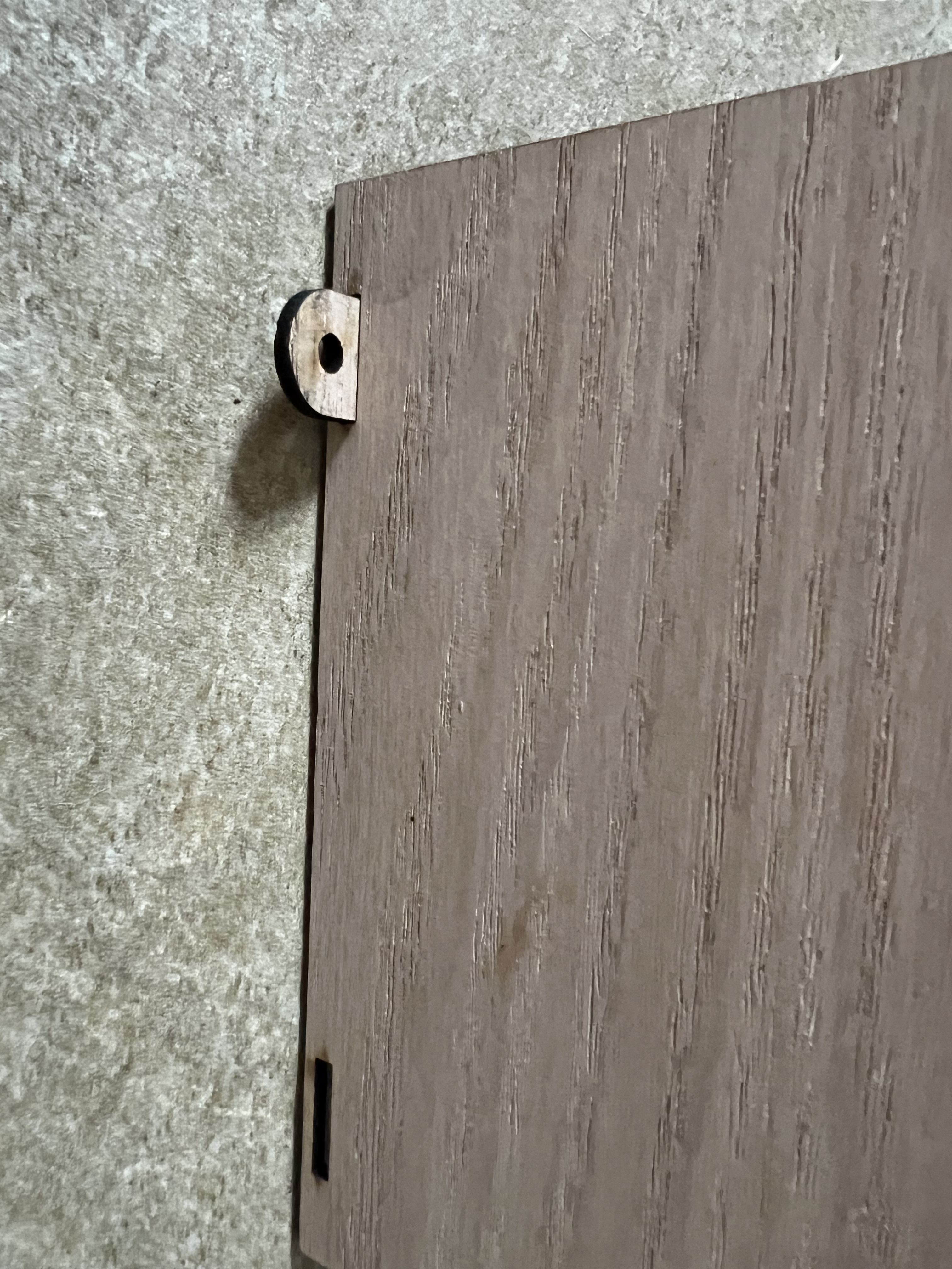

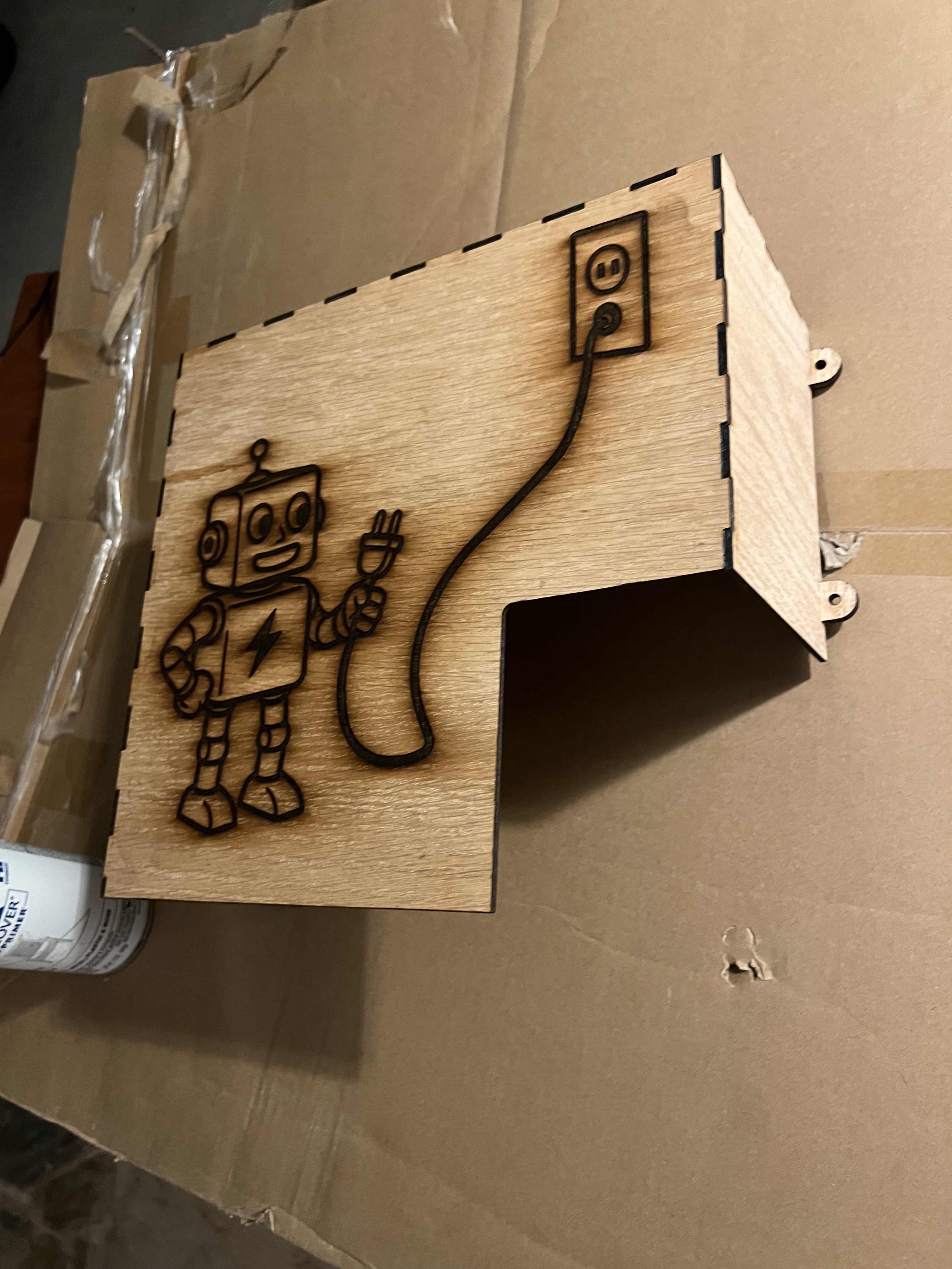

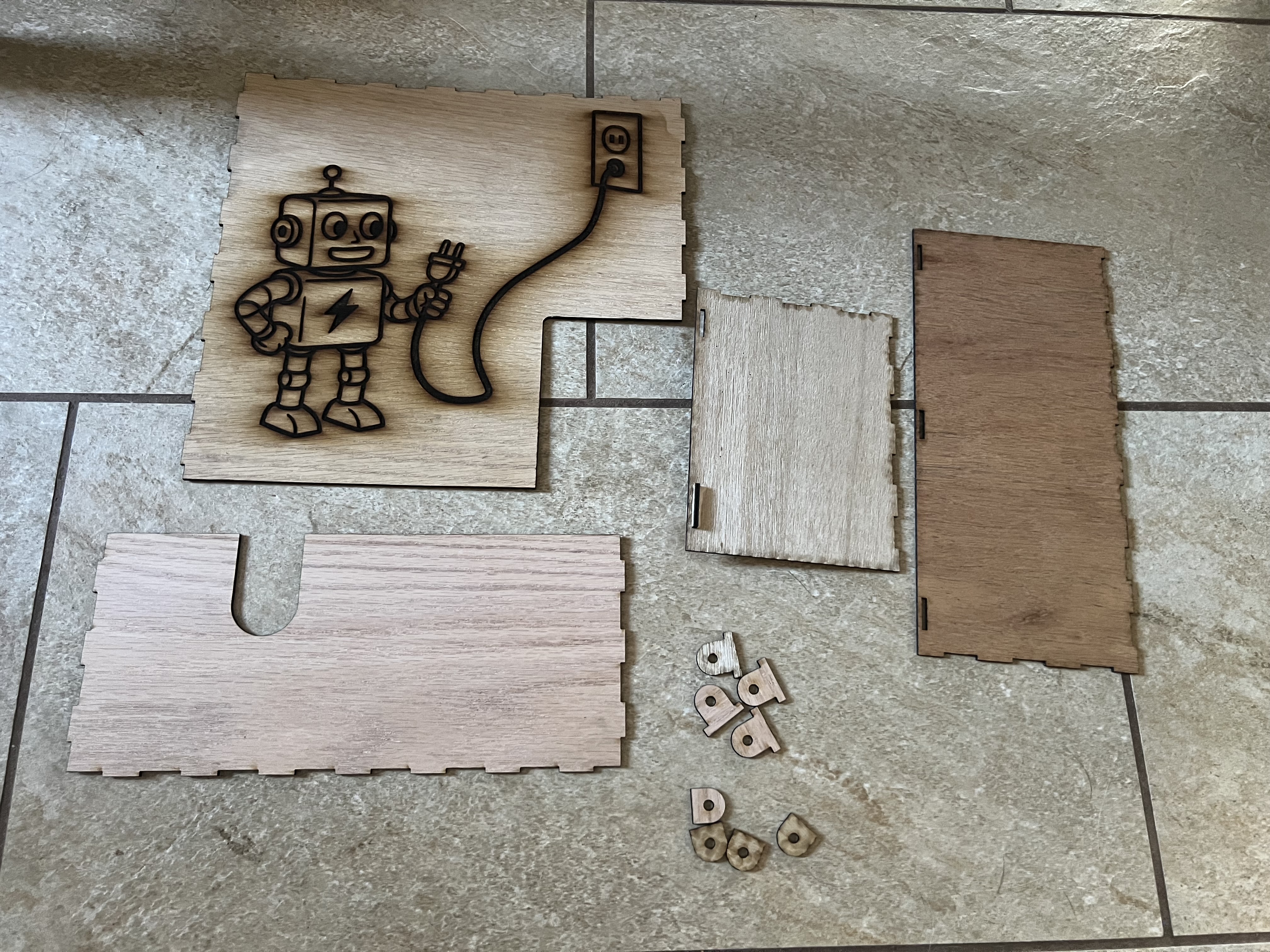

How did you do the tabs. Is the wood bent?
What’s the extra space for? Is there a hook for the charging end?
Love the painted engrave. Did you have to clean up the smoke marks of just paint over them.?

Wild guess: the screw holes are just extended fingers in the joint.

My concern with using the finger joint was the box coming apart from the wall, so I made a slot, and a piece that fit through the slot, then a spacer to glue to fill that distance between the wall and the piece that went through the hole…. (sorry running on a few hours of sleep right now)
It makes complete sense in my head but here are some pictures, and maybe it could be pieced together…
The charger cord fits in that cut out, and is sheltered from the rain. I thought about making the box more narrow but then it wouldn’t create as much of an umbrella.
In retrospect I should’ve engraved an umbrella over the electrical outlet.
